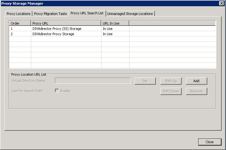

The Proxy URL Search List tab manages the search order for the dropped proxies. The Proxy URL must correspond to virtual directories set up in IIS for the DIVAdirector Web Server. This tab does not configure the assignment of the virtual directories itself, but allows additional storage to be added to the system without the need to move existing proxies to a new storage location.
The buttons in the middle of the Proxy Location URL List section of the screen perform the following functions when clicked:
Selecting a Proxy URL from the list, entering a name in the Virtual Directory Name field, and clicking Set renames the selected Proxy URL.
Selecting a Proxy URL from the list and clicking Shift Up moves the selected Proxy URL up in the search order, giving it a higher priority.
Selecting a Proxy URL from the list and clicking Shift Down moves the selected Proxy URL down in the search order, giving it a lower priority.
Entering a name in the Virtual Directory Name field and clicking Add inserts a new Proxy URL into the search list.
Selecting a Proxy URL from the list and clicking Remove deletes the Proxy URL from the search list.
