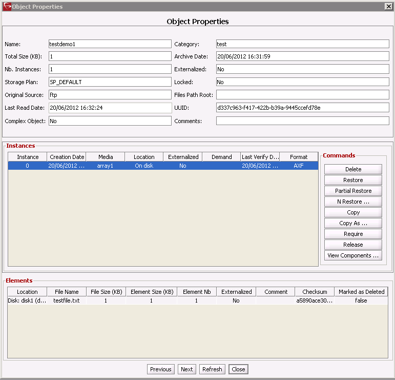

Double-clicking on the resource opens the Object Properties dialog box showing verification or failure messages and checksum information.
The Checksum column displays the different status values as follows:

In the following figure, although the highlighted object has not been verified, a checksum for that object was saved in the database. The Last Verify Date is viewable in the center portion of the screen labeled Instances. The checksum entered into the database is viewable in the bottom portion of the screen labeled Elements.

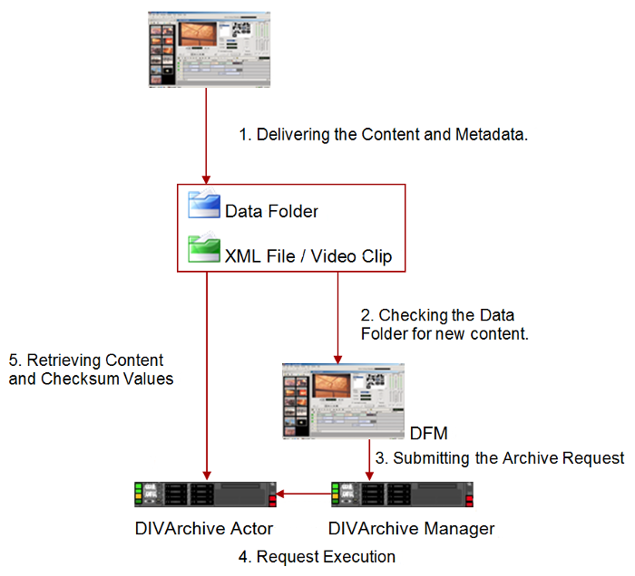

SAMMAsolo will drop one video clip and one XML file into the folder monitored by the Drop Folder Manager (DFM).
DFM picks up the files and analyzes them.
DFM submits an Archive request to the Manager.
The Manager sends the file location information to the Actor.
The Actor reads the files, reads and calculates the associated checksum, and then deletes the video clip.
SAMMAsolo uses SHA1 as a default checksum rather than the normal MD5 default checksum. However, checksums for both algorithms are generated now so that the MD5 default is available for use in DIVArchive.

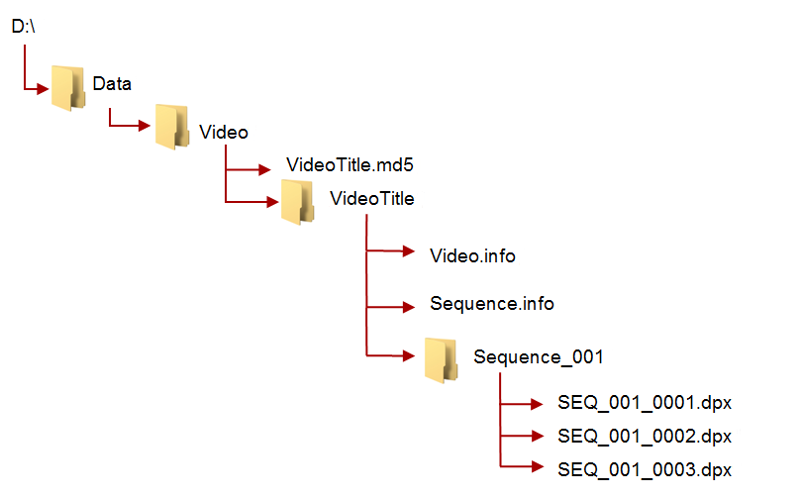

The external checksum file for the TEXT Genuine Checksum mode follows the file format of standardized MD5 Hash File Generators (for example, md5sum). The format of each line in the external file is as follows:
<32-character MD5 hash><2-character whitespace>[relative path/file name]
The relative path/file name must be a path relative to the folder that is being archived. Consider the following sample file tree:
In the previous figure the external checksum file is D:\Data\Video\VideoTitle.md5. The contents to be archived will be every file and folder within D:\Data\Video\VideoTitle. The external checksum file will contain the MD5 hash and the path (relative to D:\Data\Video\VideoTitle) for each file formatted similar to the following:
9400bbcc4b97a40e2679ff1cc6941052 Video.info 237a702a03927458e1a6fc981466adf6 Sequence.info ff58404ce3a01ca44273c8a619d4284d Sequence_001/SEQ_001_0001.dpx a1f1ca44204ca619d4a41273c80bbc47 Sequence_001/SEQ_001_0002.dpx
A checksum file must be present in the folder specified by the Root File Path.
Checksum files must end with a .md5 file extension.
The folder name is associated with the checksum file's file name (excluding the md5 extension) which contains all the files that will be archived (this folder must exist).
For example, if the checksum file is D:\Data\Video\VideoTitle.md5 then the corresponding folder containing the files to be archived is D:\Data\Video\VideoTitle.
The checksum file must be present in the folder that is the parent to the folder specified by the Root File Path.
For a file to be archived with the Genuine Checksum value, the file must be referenced with a corresponding checksum within the checksum file.
Files can be archived without a corresponding checksum within the checksum file. In this case, no checksum comparison will be performed.
