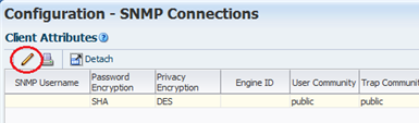

Use this procedure to add or modify SNMP client settings for STA. These settings configure STA to receive SNMP data from one or more libraries.
There is just one SNMP client entry for each STA instance at your site.
From the Setup & Administration tab, select Configuration, then select SNMP Connections.
Proceed as follows:
To configure the client settings for the first time, select the empty table row in the Client Attributes table, then click Edit.
Description of the illustration ''snmpd_editclient.png''
To modify existing client settings, select the entry in the Client Attributes table, then click Edit.
Description of the illustration ''snmpd_clientedit.png''

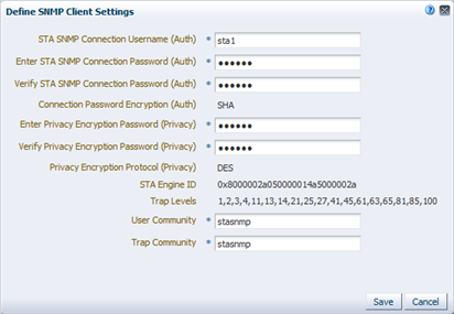

The Define SNMP Client Settings dialog box appears. If this is a new configuration, the fields are blank.
Complete the dialog box as follows. The values you specify must match the corresponding ones on the libraries.
Even if STA will only be monitoring libraries configured for SNMP v2c communication, you must complete all fields, including those applicable to SNMP v3. You cannot leave any fields blank.STA SNMP Connection Username (Auth)—Type the SNMP v3 username.
Enter STA SNMP Connection Password (Auth)—Type the connection authorization password.
Enter Privacy Encryption Password (Privacy)—Type the privacy encryption password.
User Community—Type the SNMP v2c community string specified on the library. This field is required for the SNMP handshake with the library.
Trap Community —Type the SNMP v2c community string specified on the library. This field is used only if SNMP v2c is used for communication with the library.
Click Save.
The configuration record is updated, and a message box is displayed, indicating you should perform a library connection test to establish or re-establish the SNMP communication handshake with the libraries.
Click OK to dismiss the message.

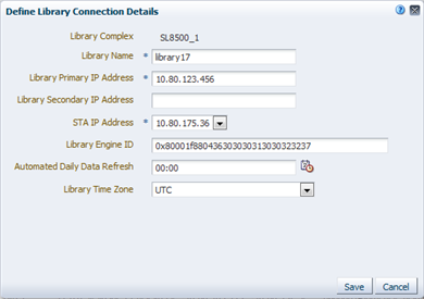

The Define Library Connection Details dialog box appears. If this is a new library connection, the fields are blank.
Complete the dialog box as follows. The values you specify must match the corresponding ones on the library.
Library Name—Type a name to identify the library throughout the STA user interface screens (for example, the library host name).
Library Primary IP Address—Type the IP address of the primary public port on the library. You cannot specify the IP address of another monitored library.
Library Secondary IP Address—Applies only to SL3000 and SL8500 libraries using Dual TCP/IP or Redundant Electronics. Specify the IP address of the secondary public port on the library. You cannot specify the IP address of another monitored library. Leave the field blank for all other libraries, including all SL500 and SL150 libraries.
STA IP Address—Select the IP address of the STA server.
Library Engine ID—Do not change this field. This is the unique SNMP engine ID of the library, and it is automatically provided when the initial connection between STA and the library is made. It is blank for new connections.
Automated Daily Data Refresh—Specify the time of day you want STA to collect the latest configuration data from the library. The data is collected automatically every 24 hours at this time. You should choose a time when there is typically lighter library usage. The default is 00:00 (12:00 am). Use 24-hour time format.
Caution:
If you leave this field blank, scheduled automatic library data collections are disabled. This will cause your STA library configuration data to become out of sync with the library.Library Time Zone—Select the library's local time zone.
Click Save.

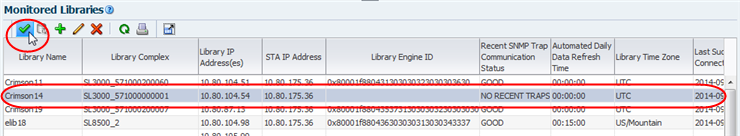

Use this procedure to test the SNMP connection between STA and a library and establish or re-establish the communication handshake. To avoid dropped connections and lost SNMP traps, you should perform this procedure for each monitored library whenever you add or change SNMP configuration settings for the library or the STA client.
You can test only one library connection at a time.
Because a connection test can cause a momentary loss of incoming SNMP packets, you should perform this procedure only when necessary.Note:
Before performing this procedure, you may want to verify that the library is operational.From the Setup & Administration tab, select Configuration, then select SNMP Connections.
In the Monitored Libraries table, select a library, then click Check / Test Connection.
Description of the illustration ''snmpd_cxntest.png''
The Connection Test Status message box appears, displaying results for the MIB Walk Channel, Trap Channel, and Media Validation Support tests.
Click OK to dismiss the message box.
The Monitored Libraries table is updated with the results of the test.
If the Library Complex field is blank, it will be supplied after you perform a manual data collection.
Library Engine ID indicates the unique SNMP engine ID for the library.
Last Connection Attempt indicates the date and time when the connection test was initiated.
Last Successful Connection indicates the date and time when the test was completed, if successful.
Last Connection Status indicates the results of the test. If the test fails, STA provides information in the Last Connection Failure Detail field. (You may need to extend the column width to see the entire value.)
If the test fails, repeat this procedure as follows:
If the test fails because of a timeout, repeat this procedure during a period of lower library activity. Once the test completes, you can compare the timestamps to verify that the library is providing current information
If the test fails for any other reason, edit the connection details for the library and clear the Library Engine ID field before repeating this procedure. See "Configure the SNMP Connection to a Library" for instructions.
