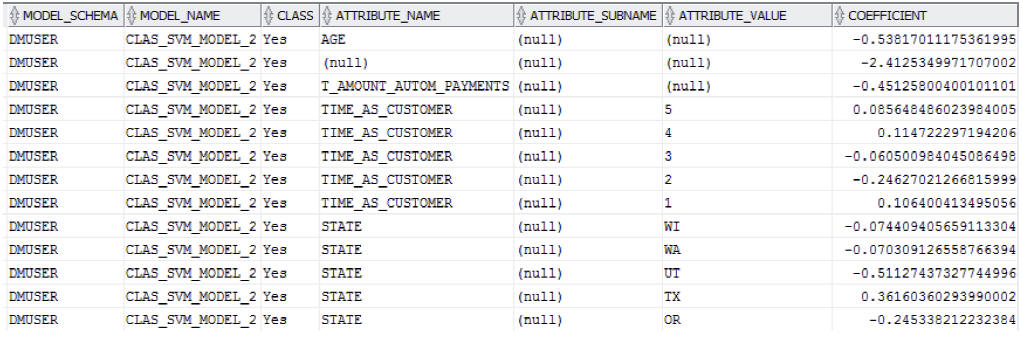

Querying the MODEL_COEFFICIENT Table
You can fetch data from the MODEL_COEFFICIENTS table by running a query.
To query data from the MODEL_COEFFICIENTS table, run the following query:
SELECT * FROM MODEL_COEFFCIENTS
The output of this query is displayed in a table, as shown in Figure 8-2.
Figure 8-2 Query Output for MODEL_COEFFICIENT Table

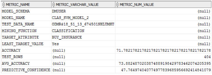

Example 8-4 Querying TEST_METRICS
SELECT * FROM ODMR$18_51_18_106346IFHRNMF
The output of this query is shown in the screenshot below. It queries the Test Metrics ODMR$18_51_18_106346IFHRNMF. It fetches the Metric name, the metric VARCHAR value and the metric NUM value.
Figure 8-5 Query Output for TEST METRICS

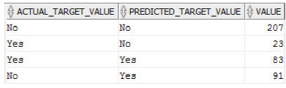

Example 8-5 Querying CONFUSION_MATRIX
SELECT * FROM ODMR$18_51_17_954530VMUXPWL
The output of this query is shown in the screenshot below. It queries the Confusion Matrix ODMR$18_51_17_954530VMUXPWL. It fetches the actual target name, and the predicted target value.
Figure 8-6 Query Output for CONFUSION_MATRIX
