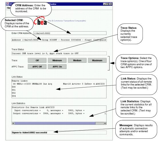

Using the CRM Monitor
The CRM Monitor is a Java application that allows you to connect to and monitor the CRM server through a graphical user interface (GUI). You can use the CRM Monitor to monitor link status and activity and start or stop diagnostic tracing of the CRM server. The CRM Monitor makes a network connection to the remote CRM server through a TCP/IP network connection. The CRM Monitor is installed with the Gateway, not on the mainframe.
Launching the CRM Monitor from the Windows Desktop
If the CRM Monitor is installed on Windows, a short cut is created in the Start menu of the Desktop when you install Oracle Tuxedo Mainframe Adapter for SNA.
To launch the CRM Monitor from the Desktop:
Choose Programs|BEA Weblogic E-Business Platform|Oracle Tuxedo Mainframe Adapter for SNA 10g R3|CRM Monitor from the Start menu.
Launching the CRM Monitor from the Command Line
The CRM Monitor can also be started from the command line on UNIX
platforms.
To launch the CRM Monitor from the command line:
java -jar crmmon.jar
Setting CRM Monitor Options
Figure 3‑1 shows an example of the CRM Monitor display.
Figure 3‑1 CRM Monitor Display
After you launch the CRM Monitor, use the following instructions to set CRM Monitor options:
1.
To monitor a CRM, type the CRM address in the Enter CRM Address text box using the following format:
//host:port
where host explicitly specifies the CRM host machine and port specifies the port number of the CRM on the CRM host machine.
This value may only be entered once per started instance of a CRM Monitor.
2.
Stop CRM Trace disables CRM tracing and closes the trace file, if it exists. This option is trace level 0 as described in the Trace Options section for the “CRM” command.
Set Minimum CRM Trace establishes tracing of only major events. This level is sufficient only to determine the sequence of application conversations. This option is trace level 1 as described in the Trace Options section for the “CRM” command.
Set Medium CRM Trace establishes tracing of major events plus tracing of all I/O buffers. This option is trace level 2 as described in the Trace Options section for the “CRM” command.
Set Maximum CRM Trace establishes tracing of major events and all I/O buffers, plus tracing of all APPC verbs. This option is trace level 3 as described in the Trace Options section for the “CRM” command.
The CRM Monitor does not show trace data. This data is captured in a file under the APPDIR directory of the CRM server (APPDIR is the variable name associated with the CRM directory). Please contact Oracle Customer Support for help in locating the trace file(s) and interpreting them.
The time tag information in the CRM trace should reflect the current system time. In order to make use of the correct time zone information on UNIX and MVS systems, it is important that the TZ environment variable be set correctly. If this variable is not set correctly on your system, refer to your system documentation for further information.
3.
Start APPC Stack Trace establishes tracing of the APPC stack. This option generally shows the parameters and results of all API calls. Depending on the stack being used, other options such as vendor-specified environment variables also may have to be activated. This option may be selected along with any of the previous Trace Options. This option corresponds to the -s option as described in the “CRM” section.
Stop APPC Stack Trace disables APPC stack trace, if established.
4.
