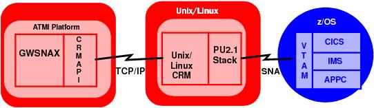

Local Configuration
Local configuration combines the Tuxedo ATMI platform, the Oracle Tuxedo Mainframe Adapter Gateway, CRM, and SNA stack (PU2.1 server) on the same UNIX platform, as shown in Figure 2‑1. Local configuration features the widely used TCP/IP connectivity between the Oracle Tuxedo Mainframe Adapter for SNA Gateway and CRM, giving a high-performance communications interface. On the mainframe side, the CRM uses a stack to communicate over a System Network Architecture (SNA) interface with the host system. This configuration allows you to:
Figure 2‑1 Local Oracle Tuxedo Mainframe Adapter for SNA Configuration on Unix/Linux Platform

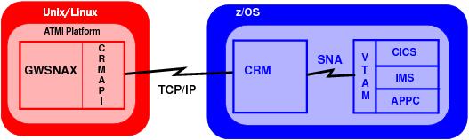

Distributed Configuration—CRM on z/OS Host
This distributed configuration deploys the CRM to the z/OS host system as shown in Figure 2‑2. It employs TCP/IP connectivity with the host, eliminating the need for a local SNA stack. This configuration provides a faster network interface and is less complex than the local configuration.
Figure 2‑2 Distributed CRM on z/OS Platform

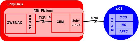

Distributed Configuration—CRM on Unix/Linux
This distributed configuration deploys the CRM and stack to a UNIX or Linux platform, as shown in Figure 2‑3. It employs the TCP/IP connectivity between the Oracle Tuxedo Mainframe Adapter Gateway and CRM, as well as the SNA connectivity to the host. This configuration allows you to use multiple stacks from different stack vendors. Also, on the ATMI platform side, you have a greater variety of UNIX-based or Windows platform manufacturers to choose from.
Figure 2‑3 Distributed CRM on UNIX/Linux Platform
