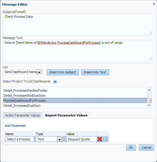

To create a dashboard link and send it using email:
Create an email message to send, optionally select a dashboard, and select one or more recipients.
Recipients can be selected from BAM users or, if an email driver is configured in Oracle User Messaging Service using Oracle Enterprise Manager Fusion Middleware Control, from external email accounts. See Sending Alerts to External Email Accounts for more information.
Messages can include variables that are set when the alert is launched, such as the time that an event occurred and the data that launched the event. To use data variables, the event must be based on data: Select a CQL Query or When a data field in a data object meets specified conditions.
To create an alert that includes a message:
Create the alert. See Creating an Alert.
Select the action Send a message via email.
Click either <create message> or <select user> in the alert expression.
The Message Editor opens.
Type comma-separated email addresses in the To text box, or click the Search icon to display the Identity Browser and select BAM users.
Type a subject in the Subject line.
Type the message in the Message Text box.
Optionally click the arrow to the right of Select Project to List Dashboards and select a project from the drop-down list.
Dashboards in the selected project are listed.
Select a dashboard from the list.
Optionally include special fields in the message.
Special fields are listed in the List drop-down list. The special fields listed change when dashboards are selected in the lower portion of the Message Editor.
To insert a special field into the message:
Select a special field from the list.
Click Insert into subject or Insert into text.
You can insert multiple values of the same type, for example, multiple links to different dashboards.
Target User inserts the names, BAM user IDs, or email addresses of the message recipients.
If you entered BAM users in the To text box, names are inserted for the users with names defined, otherwise the IDs are inserted. If you entered email addresses, these are inserted as is.

Figure 9-2 and Figure 9-3 show the Message Editor with an example parameterized message.
Figure 9-2 Message Editor Displaying Action Parameter Values Tab
Figure 9-3 Message Editor Displaying Report Parameter Values Tab
To create an alert that includes a parameterized message:
Select the action Send a parameterized message.
Click either <create message> or <set parameters> in the alert expression.
Special fields are listed in the List drop-down list. The special fields listed change when dashboards are selected in the middle portion of the Message Editor.
Target User inserts the user names of the message recipients.
Date/Time Sent inserts the date and time the message is sent.
Send Dashboard Name inserts name of the selected dashboard.
Send Dashboard Owner inserts the name of the owner of the selected dashboard.
Send Dashboard Link inserts a link to the selected dashboard.
Send Parameterized Dashboard Link inserts a link to the selected dashboard that includes parameter values.
data field inserts the value of the specified field.
In the Action Parameter Values tab, populate the User text box in one of these ways:
Type comma-separated email addresses.
Click the Search icon to display the Identity Browser and select BAM users.
Click the arrow to the right of Select Data Object Field and select a data field with user name values.
In the Action Parameter Values tab, populate the Dashboard text box in one of these ways:
Click the arrow to the right of Select Data Object Field and select a data field with dashboard name values.
Click the arrow to the right of Select Project to List Dashboards and select a project from the drop-down list.
In the Report Parameter Values tab, click Add Parameter once for each parameter the dashboard requires.
A row is added to the parameters table for each click.
For special values use the underscore (_), for example, _ALL_, _BLANK_, and _NULL_.
In each row, type the parameter name in the Name field.
In each row, select the parameter type in the Type field: Text or Data Object Field.
For each parameter of type Text, type the parameter value in the Value field.
For each parameter of type Data Object Field, click the Value field and select the parameter value from the drop-down list of data fields.
Click OK.
