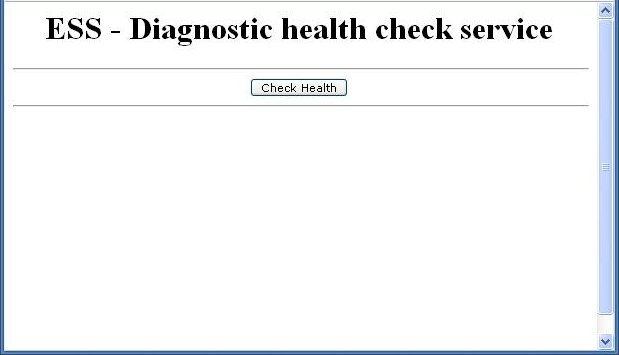

The Oracle Enterprise Scheduler health check enables verifying the Oracle Enterprise Scheduler installation using a web browser. The health check web page submits a simple scheduled job so as to verify that Oracle Enterprise Scheduler works as it should.
Access the Java health check servlet in a web browser. Access to the health check page is available only to users with administrator privileges.
