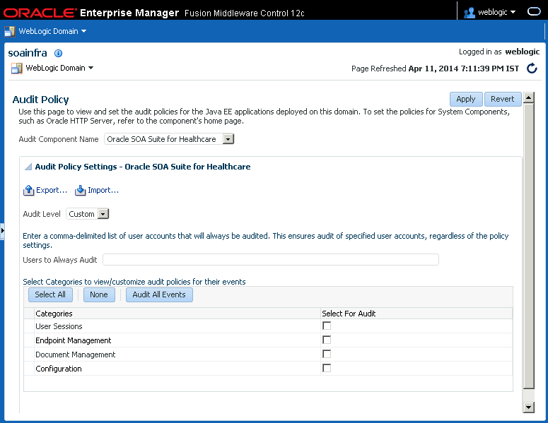

The components and events available for auditing are listed on the Audit Policy page of Oracle Enterprise Manager (Weblogic domain > Security > Audit Policy). To view or configure the these options, select Oracle SOA Suite for healthcare integration from the Audit Component Name list, Custom from the Audit Level list, and click the check boxes adjacent to the events.

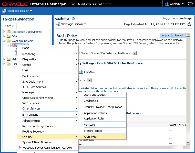

  2. In the navigation panel on the left, expand WebLogic Domain and then right-click the name of the domain for which you want to enable user auditing.
  3. In the context menu that appears, point to Security and then select Audit Policy.

  4. In the Audit Component Name list, select Oracle SOA Suite for Healthcare.
  5. In the Audit Level list, select Custom.
    Check boxes appear in the Select for Audit column so you can select which healthcare integration components and events to audit.

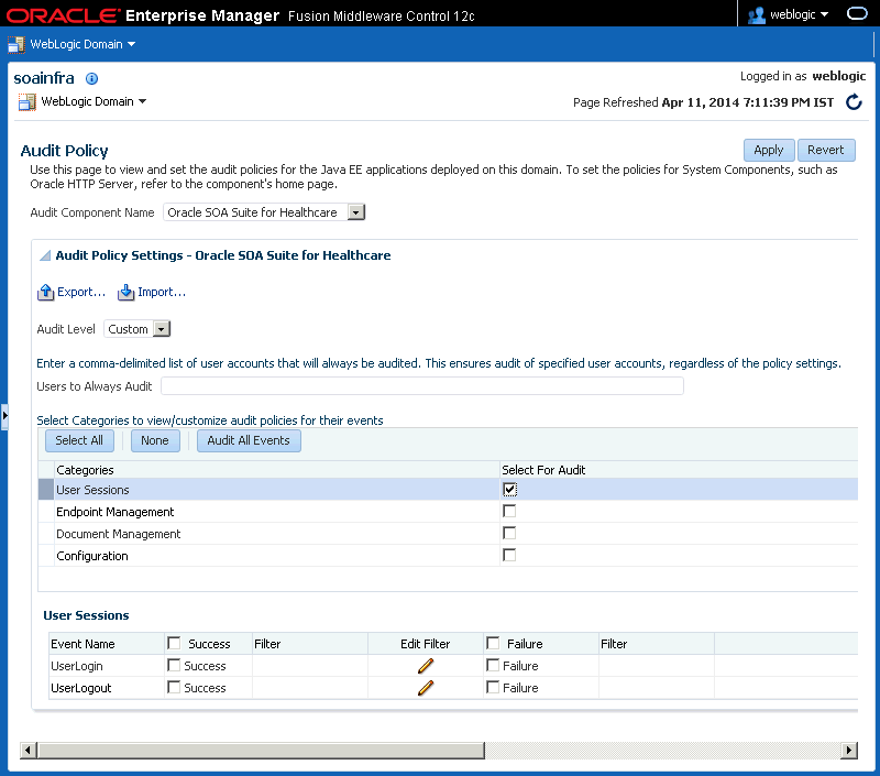

  6. Click event categories such as User Session to display the list of events pertaining to that category below.
  7. Do any of the following:
    • To enable auditing for all Oracle SOA Suite for healthcare integration components and events, click the Audit All Events button.
    • To enable auditing for all events for a specific component, select the check box in the Select for Audit column next to the component name.
      For example, to audit all actions taken against endpoints, select the check box for Endpoint Management.

    • To enable auditing of a specific event for a component, expand the component and select the check box in the Enable Audit column next to the event name under that component.
  8. To define a filter for a success condition, select Enable Audit for the success condition, and then click its Edit Filter button. Define the filter on the dialog that appears, and then click OK.
    For more information about filters, see Using Filter Conditions for Auditing and the online help available from the Edit Filter dialog. Note that filters can only be defined for success conditions at this time.
