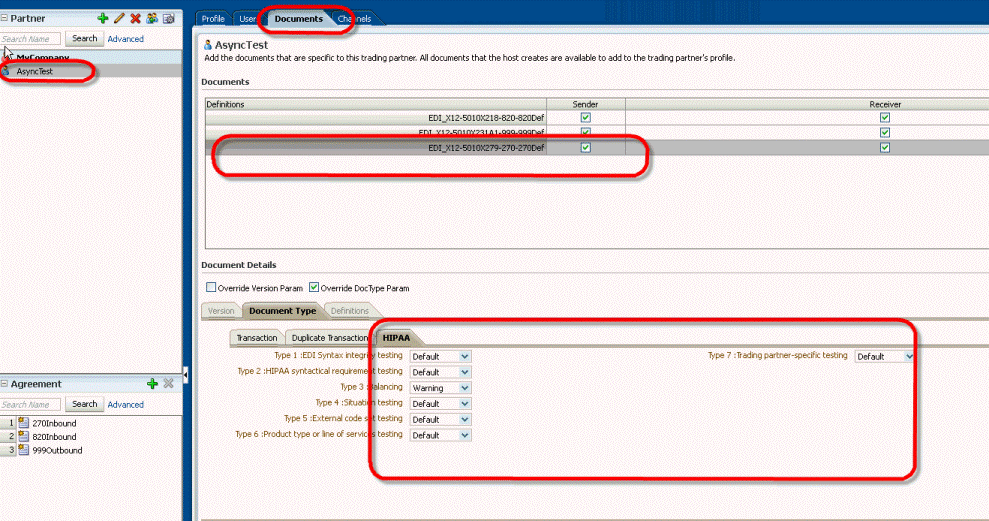

You can configure SNIP validations at the Trading Partner level under the Partners link in the Documents tab. Setting the SNIP level at the Trading Partner level overrides the configuration set at the Document Type level.
Figure J-2 displays how to configure SNIP at the Trading Partner level.
Figure J-2 Configuring SNIP at the Trading Partner Level
