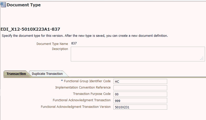

If you must use 999 as the FA and also want to keep the version different from the version of the incoming message, then you must set both Functional Acknowledgment Transaction and Functional Acknowledgment Transaction Version parameters. For example, you must set Functional Acknowledgment Transaction to 999 and Functional Acknowledgment Transaction Version to 5010X231.

Figure H-1 shows the configuration for Functional Acknowledgment Transaction and Functional Acknowledgment Transaction Version.
Figure H-1 Configuration for Functional Acknowledgment Transaction
