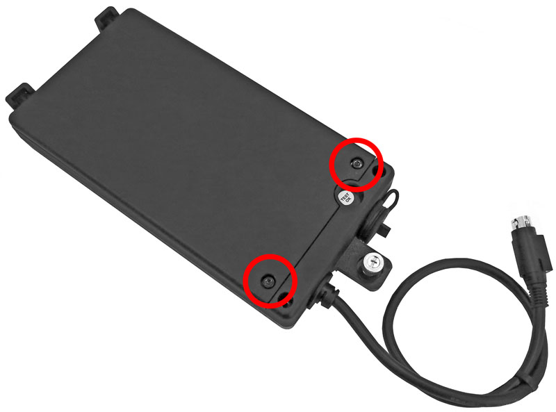

Initial setup:
  1. Remove the enclosure cover by unscrewing the two captive screws using the hex wrench included with your workstation.
    Figure 4-1 The Enclosure for Battery
    This image shows the enclosure with the two captive screws highlighted.

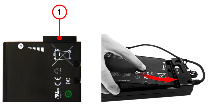

  2. Insert the battery into the enclosure by carefully aligning the battery power contacts (1) with the battery terminals. Gently press down on the battery to secure the connection.
    Figure 4-2 Inserting the Battery in the Enclosure for Battery
    This image shows the battery being inserted into the enclosure
