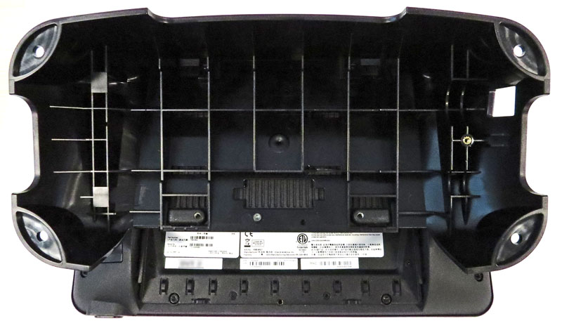

  1. Place the stand and workstation upside down on a flat surface.
    This image shows the bottom view of the Basic Stand with workstation.

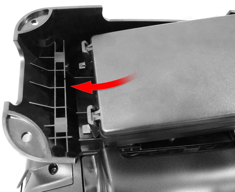

  2. Insert the enclosure mounting tabs into the stand mounting slots.
    This image depicts sliding the battery enclosure into the slots on the bottom of the Basic Stand

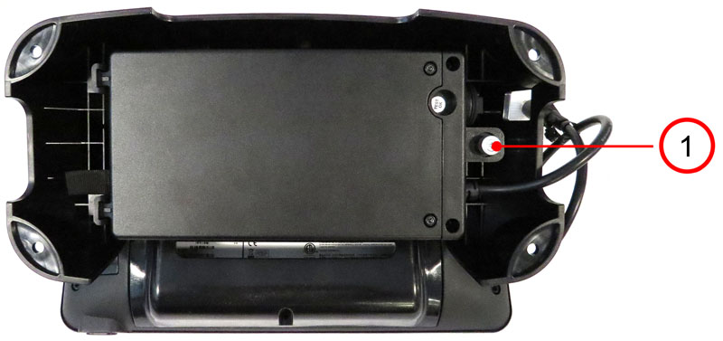

  3. Tighten the stand thumbscrew (1) to secure the enclosure to the stand.
    This image shows the enclosure mounted on the bottom of the Basic Stand.
