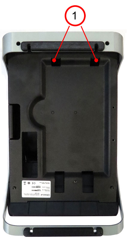

  1. Place the stand upside down on a flat surface. Note the location of the two enclosure mounting slots (1).
    This image shows the enclosure mounting slots on the bottom of the Flexible Stand.
  2. Place the enclosure into the recessed compartment, and then slide up to join the enclosure mounting tabs with the stand.
    This image depicts sliding the battery enclosure into the slots on the bottom of the Flexible Stand.

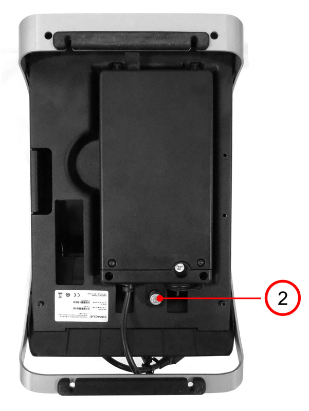

  3. Tighten the stand thumbscrew (2) to secure the enclosure to the stand.
    This image shows the enclosure mounted on the bottom of the Flexible Stand.
  4. Connect the workstation Power Adapter (15V) to the DC power input, and then plug the Power Adapter into an outlet to charge the battery.
