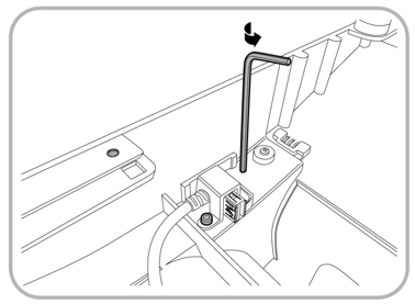

  1. Place the Workstation 6 Adjustable Stand on its back.
  2. Unscrew the two hex screws by turning the hex key counter clockwise to release the USB cable from the USB cover.
    This figure shows how to release the USB cable from the USB cover.

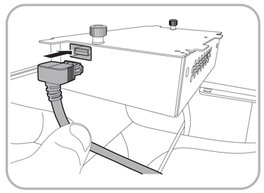

  3. Insert the USB cable into the USB connector on the left side of the power USB module.
    This figure shows how to insert the USB cable into the USB connector of the power USB module.

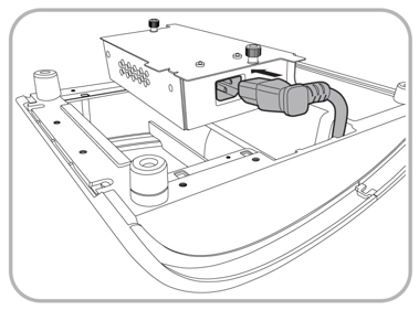

  4. Insert the power cable connector into the power supply inlet on the right side of the power USB module.
    This figure shows how to insert the power cable connector into the power supply inlet of the power USB module.

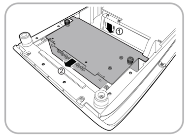

  5. Place the power USB module vertically down into the base unit compartment, and then slide it forward all the way to the edge.
    This figure shows how to insert the power USB module into the base unit of the workstation.

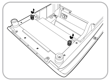

  6. Tighten both thumbscrews by turning them clockwise to secure the power USB module to the Workstation 6 Adjustable Stand.
    This figure shows how to tighten the thumbscrews and secure the power USB module to the base unit of the workstation.
