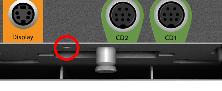

  4. If you secured the workstation to the Adjustable Stand using a security screw, remove the security screw.
    This figures shows the location of the security screw on the Workstation 625/655.

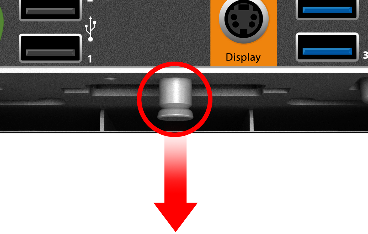

  5. Pull down the quick release pin, and then gently push the workstation.
    This figure shows the location of the quick release pin on the Workstation 6 Series Adjustable Stand.
