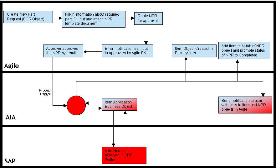

3.1 Overview
New part numbers may originate in a system outside of Agile, which is easily understood when looking at the interactions of various roles that can be involved in the process of generating new part numbers.
An engineer designing an electronic assembly, a circuit board for example, may require a part, such as a new resistor, which cannot be found in the system. The engineer raises a new part request (NPR) to document control to route the request to the materials manager for review. A buyer looks into catalogs offered by approved manufacturers and finds a part that meets the criteria. The buyer then contacts the manufacturer, confirms availability, procures specifications, and then approves the NPR with the new manufacturer part number attached to it. Document control compiles all the information and assigns an internal part number corresponding to the manufacturer part and informs the engineer.
The process integration allows you to trigger a NPR process on demand. This is a synchronous process, which reserves and fetches the part number from the SAP system.

This figure shows the process flow from Agile to SAP for the NPR process.
Figure 3-1 NPR Process Flow
Surrounding text describes Figure 3-1 .

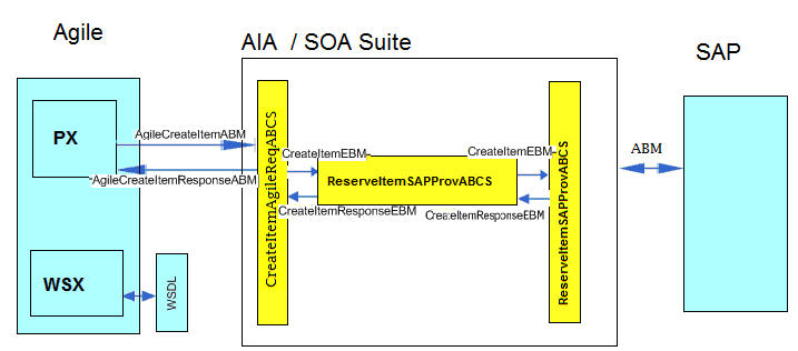

This figure shows the sequence of events that occur when creating a NPR:
Figure 3-2 Sequence for creating a new part number
Surrounding text describes Figure 3-2 .

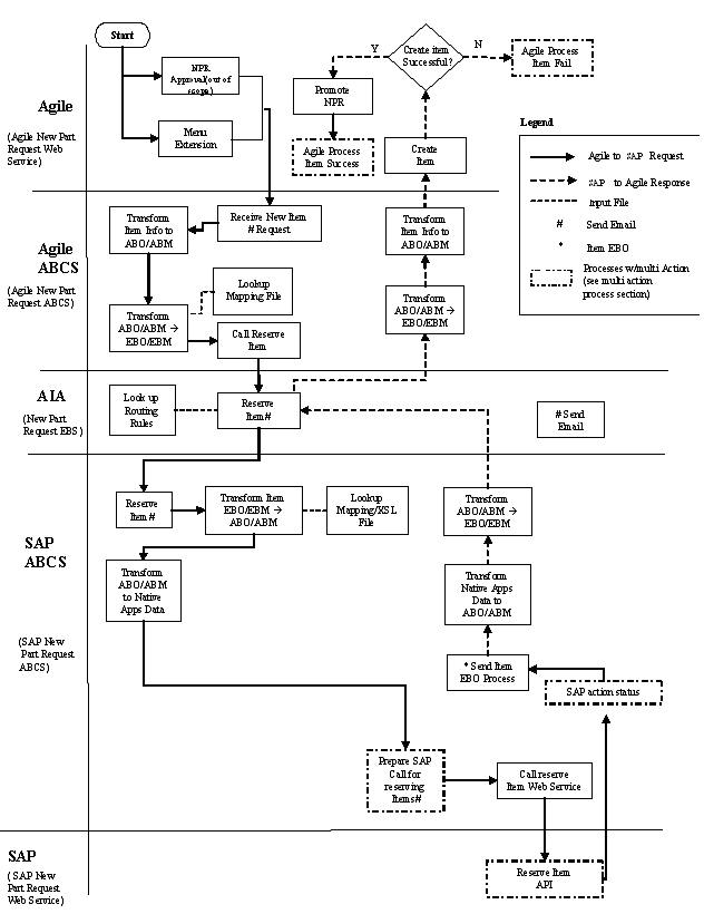

3.5.1 NPR Integration Flow
The NPR process is triggered from a PX. It is a synchronous process and therefore the process is designed based on the Requestor - Provider pattern as shown in this figure:
Figure 3-3 Process flow from Agile to SAP for new part number
Surrounding text describes Figure 3-3 .
The PX creates the Agile request Application Business Message (ABM) (AgileCreateItemABM) for the CreateItemAgileReqABCS and invokes it:
The request AgileCreateItemABM is transformed to the Enterprise Business Message CreateItemEBM for NPR process.
  1. Using the Asynchronous Message Pattern, the NPR process is invoked by the CreateItemAgileReqABCSImpl with the CreateItemEBM as input.
  2. The CreateItemEBM is routed to the ReserveItemSAPProvABCS with the CreateItemEBM as input.
  3. The ReserveItemSAPProvABCS implements the business logic for generating the new part number in SAP.
  4. A response CreateItemResponseEBM with New Part Number is returned and routed back to the CreateItemAgileReqABCSImpl.
  5. The CreateItemAgileReqABCSImpl transforms the response CreateItemResponseEBM to Agile response AgileCreateItemResponseABM.
  6. CreateItemAgileReqABCS receives AgileCreateItemResponseABM and returns back to the PX.
  7. The Part Number from the AgileCreateItemResponseABM is returned to the web client and displayed in the Number field in the Create Item screen.
