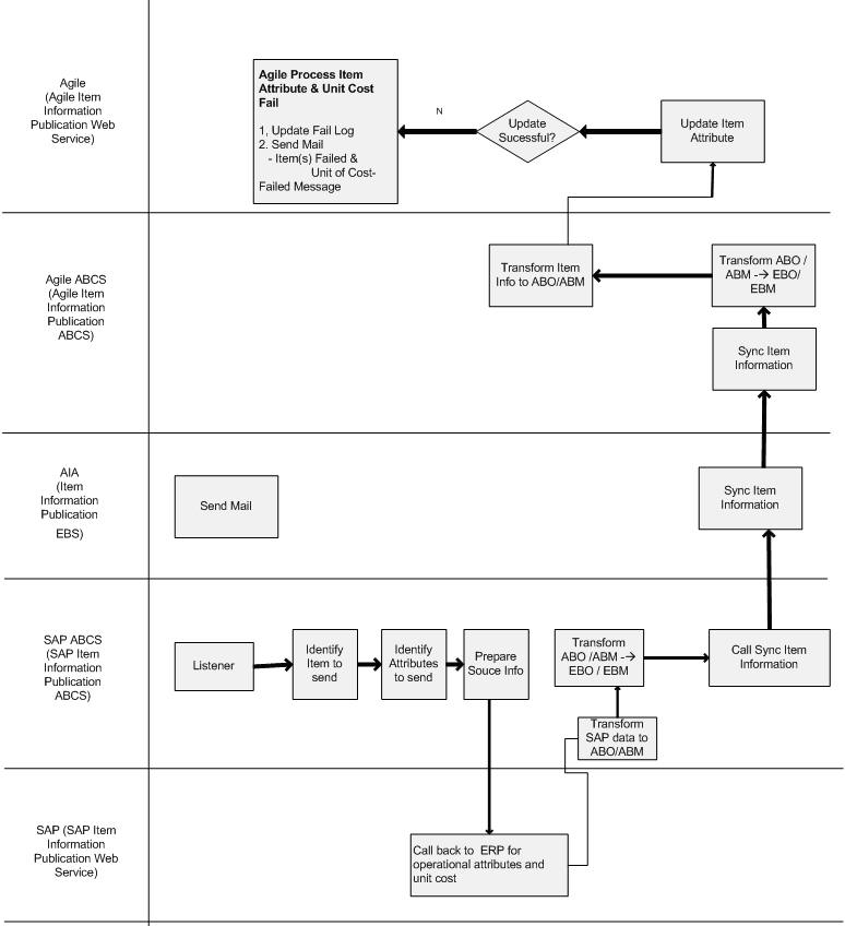

The update of Item Attribute information from ERP to Agile Process Lifecycle Management (PLM) is performed as event-based and in near real time.
The following steps are executed:
The process kicks off when configured fields are modified and saved on an item in System Application and Products (SAP).
Retrieve the attributes that have changed on the item in SAP.
This data is retrieved from one or more organizations (plants) as per site-org mappings or from the configured single organization.
3. Update the information into Agile.
The input consists of the item attribute values, which must be updated in Agile. Unique identifiers for the item, along with values for all the attributes mapped for transfer from ERP to Agile are provided as input.

IA Update is performed either near real time or batch. In order to achieve this, implementation requires a one-time configuration of change pointers and Application Link Enabling (ALE) in SAP.
As part of this configuration, all the fields that must be updated back in to Agile are configured such that any changes saved to these fields on an item triggers the update process immediately. For the batch process, it is required to schedule the IDOC as a background job.
The moment you save the changes on the item in SAP, the change pointers configuration triggers an event. The event pushes the data to the configured partner (ALE configurations) and in this case it is the Agile system. All the changes made on the item are captured and updated on the specified item in Agile. This process triggers once for each item change save event.

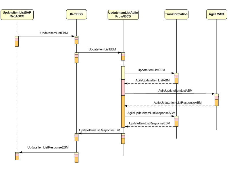

This figure shows the sequence of events that occur during IA update:
This sequence diagram shows the process flow for IA update process flow:
This table describes the activities involved in the IA update process:
Activity | Description |
| 1 | SAP Item Operational Attribute Update Action Trigger | SAP Item Operational Attribute Update Action trigger Invokes the UpdateItemListSAPReqABCS |
| 2 | UpdateItemListSAPReqABCS calls UpdateItemListSAPReqABCSImpl | UpdateItemListABM will be passed to UpdateItemListSAPReqABCSImpl as the input |
| 3 | UpdateItemListSAPReqABCSImpl invokes ItemEBS | An invoke activity in UpdateItemListSAPReqABCSImpl invokes the UpdateItemList operation on ItemEBS with UpdateItemListEBM as input |
| 4 | ItemEBS routes UpdateItemListEBM to UpdateItemListAgileProvABCSImpl | ItemEBS routes UpdateItemListEBM as input to UpdateItemListAgileProvABCSImpl |
| 5 | UpdateItemListAgileProvABCSImpl invokes Agile's Item Operational Attribute Update Web Service | UpdateItemListAgileProvABCSImpl transforms the UpdateItemListEBM to AgileUpdateItemListABM and invokes UpdateItem service operation on Agile Web Service to update Item cost related attribute information from SAP to Agile.
The AgileUpdateItemListResponseABM is returned back to UpdateItemListAgileProvABCSImpl |

ItemEBS is the Enterprise Business Service, which exposes the operations related to the Item Attribute Update Integration on the ItemEBO. The following are the routing rules:
ItemEBS Mediator service
Route UpdateItemListEBM to UpdateItemListAgileProvABCSImpl
UpdateItemListSAPReqABCSImpl is called when there is a requirenment to update multiple items in Agile with all the operational attributes as well as attributes such as unit cost from SAP. This is a push from SAP to the Agile.
The requester Application Business Connector Service (ABCS) is a synchronous process, which receives a list of Item Ids from the SAP Change Pointer program. The lists of Ids are those which have last_update_date greater than the last run date of the Change Pointer.
The requester Business Process Execution Language (BPEL) Composite filters the list of Ids that are present in the cross-reference tables in the Fusion Middleware (FMW) layer. This provides a list of Items that were actually from the Agile system. The original list of Item Ids may be those from non-Agile sources as well.
The BPEL Composite then makes a Mediator call for end point virtualization. This Mediator layer has a SAP Adapter, which calls the Business Application Programming Interface (BAPI) that provides the Item details required to be sent out. This is the Item Application Business Message (ABM).
A transformation converts the ABM to an Enterprise Business Message (EBM).
An asynchronous request-delayed response call is made to the ItemEBS with the ItemListEBM. This is routed to the appropriate provider.
The BPEL instance gets invoked when the asynchronous call gets back from the provider and provides the status of the transaction back to the caller concurrent program (since that is a synchronous call).
The concurrent program logs the status of this call.
UpdateItemListAgileProvABCSImpl is used to facilitate the communication between ItemEBS and the Agile web service used for updating the Items' operational attributes, item cost information in batch mode in Agile.
Receives UpdateItemListReqMsg that contains UpdateItemListEBM
Transform operation is called to convert the UpdateItemListEBM into AgileUpdateItemListABM.
AgileUpdateItemListABM is sent as input to the web service operation UpdateItems (Coarse Grained application programming interfaces (APIs) on Agile side) to update Items in Agile.
AgileUpdateItemListResponseABM is received on successful execution of Coarse Grained API.
Transform operation is called to convert the AgileUpdateItemListABM to UpdateItemListResponseEBM, which is returned as output of this BPEL Composite.
If the UpdateItems service operation fails on the Agile side, a new Fault is generated and is sent across with the appropriate error message.
