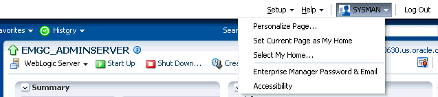

Select Personalize Page from the menu item that displays the username of the currently logged-in user, just to the left of the Log Out menu item. In Figure 26-1, the menu item displays the SYSMAN user name.
Figure 26-1 Personalize Page Menu

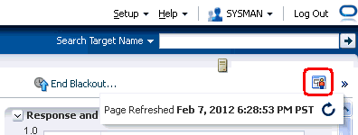

Or, click the “Personalize Page" icon on the right-hand side of the page, shown just above the “Page Refreshed" time stamp, as shown in Figure 26-2.
Figure 26-2 Personalize Page Icon
Note that the menu item or icon will only be enabled if the page you are currently on can be personalized.
