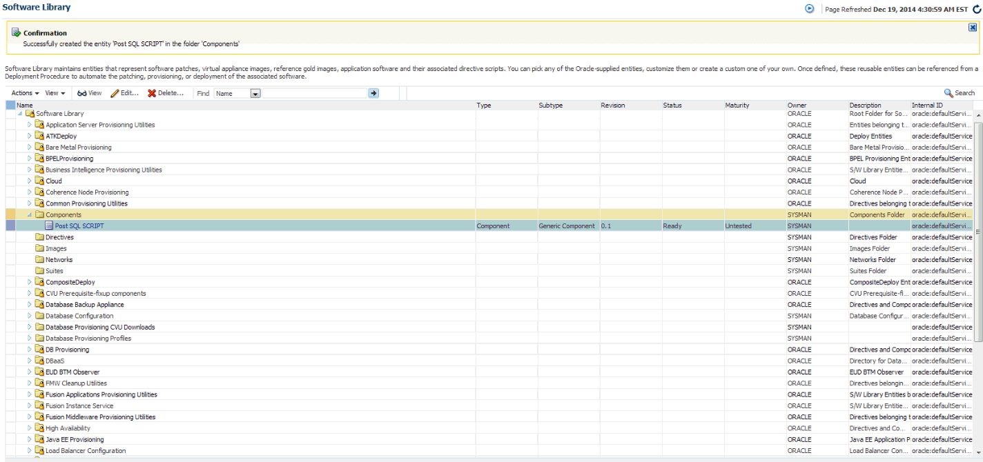

26.1.1 Selecting the Post SQL Script
A post SQL script can be created and uploaded to the Software Library. The self service administrator can select the script during service template creation. To specify the script, follow these steps:
  1. Log in as a user with EM_SSA_ADMINISTRATOR role.
  2. From the Enterprise menu, select Cloud. From the Cloud Home menu, select Service Template and then Create.
  3. Select the Service Template type as Database and click Create.
  4. Navigate to the Configuration page. Click the Search icon next to the Post SQL Script field and select the script from the Software Library.
  5. In the Run As User drop down, the SYS user is selected by default.
    If this user is selected, the SYS password provided on Database page in the wizard is used to run the post database creation SQL script.
    If any other user is selected including Master Account, the password provided by the self service user for the Master Account while creating a service request will be used.
    If the user account is locked, an error message is displayed. The user account must be open in the source database.
