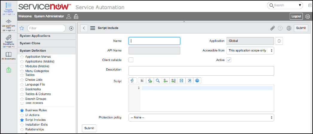

  3. Click the blue New button on the Script Includes menu bar. The following window will appear (Figure 3-2):
    Figure 3-2 ServiceNow "Script Include" Window
    ServiceNow “Script Include” Window screen shot example.
