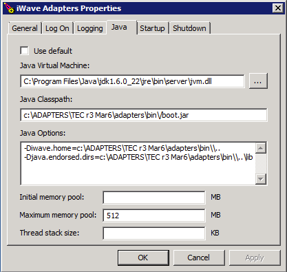

If the web service will be run using a 64-bit JRE, perform the following substeps to configure the service to use the 64-bit JRE:
In the adapters\bin directory, double click the iWaveAdaptersw.exe file. This will cause the iWave Adapters Properties window to be displayed.
Click the Java tab. The Java tab will be displayed that shows the JVM settings as shown in Figure 2-3.
Uncheck the Use default check box if it is checked.
Click
 to open the Select Java Virtual Machine DLL window.
Navigate to the jvm.dll file in the 64 bit JRE installation directory and click Open.
Click OK.
The web service framework is now installed and ready to start.
Figure 2-3 Java Tab on the iWave Adapters Properties Window
