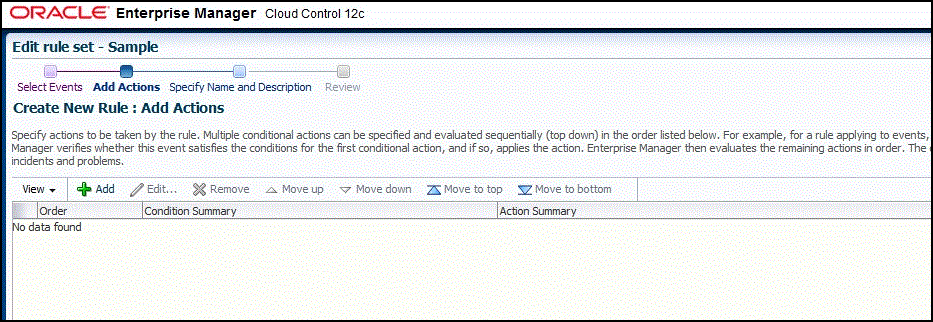

The Add Actions page will be displayed as shown in Figure 4-1.
Figure 4-1 Add Actions Page
Click Add.

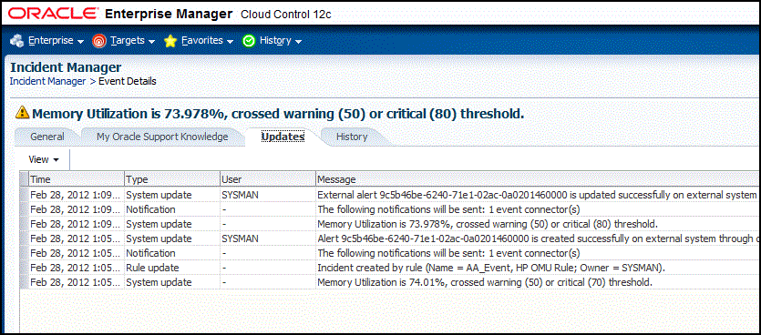

The following process occurs after the event rule has been created successfully:
A request is sent to the OMU Connector when an event is created per the criteria mentioned in the rule.
The message is created or updated on the OMU console.
In Enterprise Manager, the event is annotated with a comment on the Updates tab to indicate that an event is created or updated, as shown in Figure 4-3.
Figure 4-3 Event Annotations
