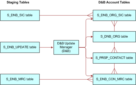

  • D&B Update Manager (D&B). Moves D&B marketing data from the staging table (S_DNB_UPDATE) into the normalized D&B Account tables, which are the basis for the D&B All Accounts View. For more information, see Figure 6.

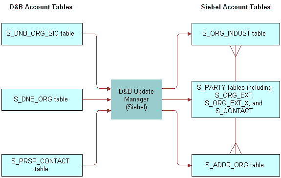

  • D&B Update Manager (Siebel). Updates the records in the Siebel Account tables for accounts with matching D-U-N-S numbers. For more information, see Figure 7.

The update server components are part of the Dun and Bradstreet Enterprise Component Group. This group and each of its D&B Batch Components must be enabled. After enabled, each component can be run as a batch task. Figure 6 shows how the staging tables are mapped to the D&B Account tables.
Figure 6. D&B Update Manager (D&B) Table Names
Figure 7 shows how the D&B Account tables are mapped to the Siebel Account tables.
Figure 7. D&B Update Manager (Siebel) Table Names
Default table mapping exists from the D&B Account tables to the Siebel Account tables that are used by the D&B Update Manager (Siebel) server component. For more information, see Field Mapping for the D&B Update Manager Process.
