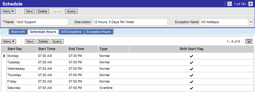

Verify that a schedule exists with valid hours by navigating to the All Schedules view (Administration - Service screen, Schedules view).
For this example, select the 12x5 Support schedule in the Schedules List, and click the Schedule Hours view tab. Make sure that the hours listed are valid. The following figure shows this view.

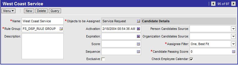

Figure 11-2 shows an example of a field service assignment rule, where:
Name = West Coast Service
Objects to Be Assigned = Service Request
Rule Group = FS_DISP_RULE GROUP
Assignee Filter = One, Best Fit
Candidate Passing Score = 0
The Check Employee Calendar checkbox is activated, thereby enabling the rule for availability-based assignment.
Figure 11-2 A Field Service Assignment Rule with the Check Employee Calendar Field Activated
