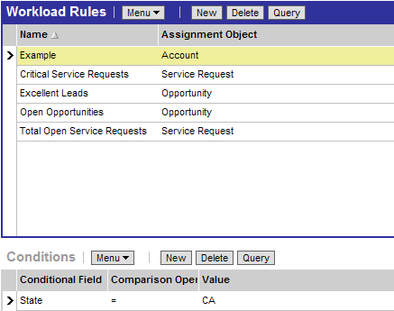

Figure 5-13 shows an example of creating a workload rule called Example for the Account assignment object. The workload condition requires that the U.S. state for the account equal CA (for California).
Figure 5-13 Creating Workload Distribution Rules

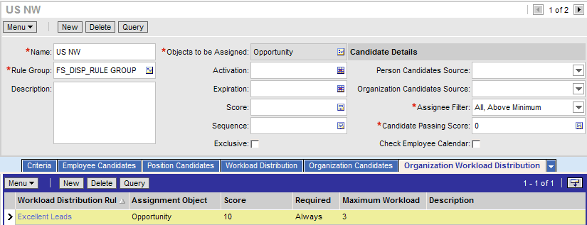

Figure 5-15 shows an example of adding a workload criteria for organizations using values specified in Table 5-23.
Figure 5-15 Example of Defining Workload Distribution for Organizations
