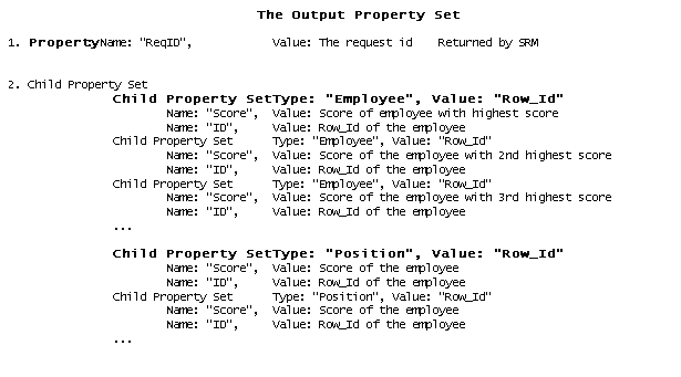

Figure 9-1 illustrates the structure of the output property set that Assignment Manager returns from a synchronous request, given the input parameter AsgnMode = Match or MatchAssign.
Figure 9-1 Example of Output Property Set Structure Returned from a Synchronous Request
