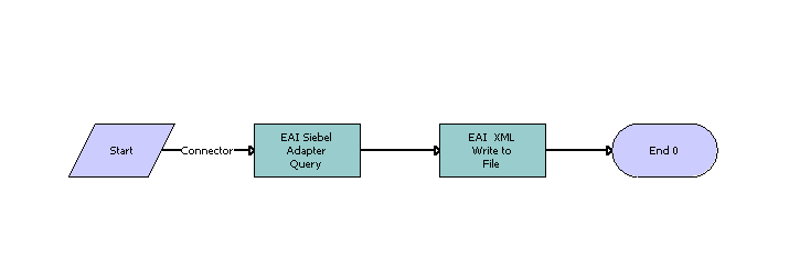

This workflow process generates an XML file that includes all the financial account records for the first lease-end communication. It is triggered by scheduling a job with Workflow Process Manager. Schedule Start should be set to a time that allows time to complete the batch job set for eAuto CF Lease End Communication Workflow Process.
This workflow process is shown in Figure 10.
Figure 10. eAuto CF Lease End Comm1 XML Generation Workflow Process
Workflow Process Description. This workflow process performs the following actions:
  1. EAI Siebel Adapter Query. This step retrieves all the records that had the first end-of-term communication Activity created for the current day.
  2. EAI XML Write to File. This step generates an XML file consisting of all the retrieved records.
