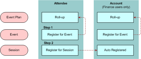

Registration Workflow
Siebel Events Management uses workflow rules to eliminate redundant data entry during the registration process.
  • Registering an attendee for the event will automatically register the account for the event if the attendee is associated to an account.
  • If an account has been manually registered for an event then a new contact registration with the same associated account will not impact the existing account registration.
Figure 4 illustrates the process for attendee event registration.
Figure 4. Attendee Event Registration
NOTE:  The term Pre-Registered in the preceding workflow indicates that the attendee has already been registered.
Attendees cannot register for a session until they have first registered for an event. Attendee records are rolled up to the Event Plan level for reporting purposes only.

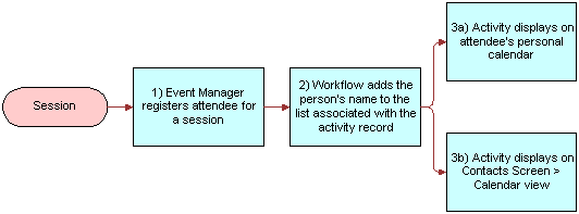

Session Registration and Activity Records
As part of session management, the workflow performs the following tasks:
  • When a session is first created, the workflow creates an Activity record to track that session, and sets the Activity Type = Session.
  • When an event manager registers a person for the session, the workflow adds the person's name to the list associated with the Activity record.
These workflow activities are generated so that all internal employees who are registered for a session can see that session displayed on their personal calendar within the Siebel application (shown in the Calendar screen). In addition, for all external contacts who are registered for a session, an Activity of Type = Session shows on the contact-centric calendar, which is found in the Contacts screen, Calendar view.
Figure 5 illustrates the workflow triggered during session registration. First, the Event Manager registers attendee for a session. Second, the workflow adds the person's name to the list associated with the activity record, and then an activity displays on the attendee's personal calendar. In addition, the activity displays on the Contacts > Calendar view.
Figure 5. Session Registration Workflow
