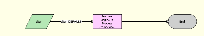

The LOY Engine - Process Promotion Bucket workflow, shown in Figure 31, processes a bucket on the real-time component.
Figure 31. LOY Engine - Process Promotion Bucket Workflow
Workflow Description. This workflow performs the following action:
  • Invoke Engine to Process Promotion Bucket. This step calls the method ProcessObject of the LOY Processing Engine Business Service, which processes the bucket on the real-time component.
