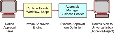

Automating an approval process involves the following steps:
Interaction of the Approvals engine parts is shown in Figure 38.
Figure 38. Components of the Approvals Engine
