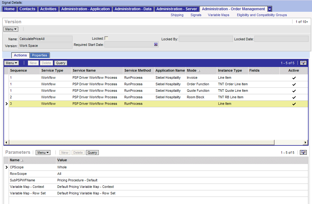

Arguments for the default PSP Driver Workflow are shown in Figure 18. PSP Driver Workflow is set as the controller workflow for the signal CalculatePriceAll in the Service Name field of the Actions tab.

Figure 18. Arguments for the PSP Driver Workflow

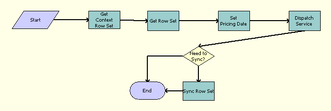

The PSP Driver Workflow, shown in Figure 19, does the following:
  1. Asks the Context Service to generate two property sets (row sets): the shared Context and the Row Set containing individual line items. These are representations of the Line Item and Header business components using variable maps. For more information about variable maps, see Variable Maps.
  2. Dispatches to the workflow indicated by the process property PSPWorkflowName. For example, in the event the user selected RepriceAll, this step dispatches to the Pricing Procedure - Default workflow to perform all pricing operations.
  3. Synchronizes the updated PSP information back to the input data source (Quote, Order, Agreement, or Customizable Product). The synchronization can be skipped by setting the Sync process property.
Figure 19. PSP Driver Workflow Process
Table 11 provides a list of the steps in the PSP Driver Workflow Process, showing also the business service and method called by each step.
Table 11. PSP Driver Workflow Process Steps
Step Name
Type
Business Service
Method
Description
Get Context Row Set
Business Service
Context Service
GetRowSetData
Generate the Context Property Set which represents the Header Buscomp.
Get Row Set
Business Service
Context Service
GetRowSetData
Generate the Row Set Property Set which represents the Line Item Buscomp.
Set Pricing Date
Business Service
Context Service
GetRowSetData
Set pricing date.
Dispatch Service
Business Service
ISS PSP Dispatch Service
CallPSPWorkflow
Dynamically dispatch to a sub-process.
Need to Sync?
Decision Point
None
None
A user decision point of whether synchronization is needed.
Sync Row Set
Business Service
Context Service
SyncRowSetData
Synchronizes information back to data sources using Context Service.
