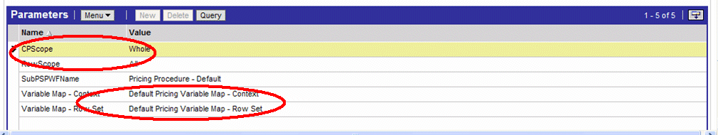

Signal parameters define the scope of line items retrieved using the variable map, and they define the variable maps used to retrieve Context and Row Set data. Figure 11 shows example signal parameters.
Figure 11. Signal Parameters for Variable Maps

  5. In the Parameters list applet, (scroll down, if necessary), enter parameters for the signal, as follows:
    • Using Scope arguments and values, define the scope of line items retrieved by the variable map.
    • Using Variable Map parameters, define the variable maps used to retrieve Context and Row Set data.
