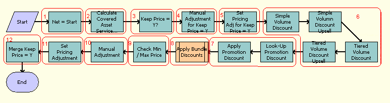

The Pricing Procedure - Calculate Net Price workflow, as shown in Figure 42, is responsible for the net price calculation, which takes into account volume discount, aggregate discount sequence, product promotion, manual adjustment and minimum or maximum price bound checks.
Figure 42. Pricing Procedure - Calculate Net Price Workflow Process
Workflow Description. This workflow does the following:
  1. Initializes the net price value as the start price value.
  2. Queries in FS Product Price Item Details Buscomp for any covered asset service pricing adjustment.
  3. Moves those rows with the Exclude Pricing flag set to another the Keep Price Row Set row set. This will skip all Siebel-Pricer-generated discounts throughout the procedure.
  4. Applies a manual adjustment (discount amount, discount percentage, discount price and header discount percentage) for the row set with Exclude Pricing flag Set.
  5. Sets the pricing adjustment that indicates the total amount of Siebel-Pricer-generated discount accounts for the row set with Exclude Pricing flag = Y.
  6. Evaluates simple and tiered volume discount. This would also populate the next discount and upsell message for upsell purposes.
  7. Evaluates product promotion discounts.
  8. Calls the Pricing Procedure - Bundle Discount subprocedure to evaluate the aggregate discount sequence.
  9. Checks whether the current net price is within the boundary of the minimum and maximum price.
  10. Applies a manual adjustment (discount amount, discount percentage, discount price and header discount percentage).
  11. Sets the pricing adjustment that indicates the total amount of Siebel-Pricer-generated discount accounts.
  12. Merges the two row sets generated from the Keep Price = Y? back into one row set.
