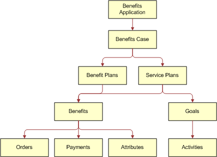

In Siebel Public Sector, the records that contain benefit data have a hierarchical relationship with each other. Figure 1 shows this hierarchical relationship.
Figure 1. Benefit Data Hierarchy
Details about this benefit data hierarchy follow:
  • A benefits application can include a benefits case.
  • A benefits case can include benefit plans and service plans.
  • A benefit plan can include benefits.
  • A service plan can include benefits and goals.
  • A benefit can include orders, payments, and attributes.
  • A goal can include activities.
