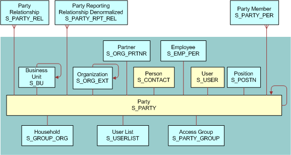

The S_PARTY table is the base table for all of the parties listed in Table 9-1, "Party Types and Parties": Person (Contact), User, Employee, Partner User, Position, Account, Division, Organization, Partner Organization, Household, User List, and Access Group.
For each party record stored in the S_PARTY table, the value of the PARTY_TYPE_CD column denotes the party type. Along with the party type, extension tables provide the primary differentiation between the different parties.
For information about how joins are used to draw data from multiple tables into a single business component, such as is done for Employee, Account, and other business components for party-type data, see Configuring Siebel Business Applications.
In Figure 9-10, the base table and extension tables that make up the party data model are shown within the Party boundary box (all of the shaded area). The three tables shown outside of the Party boundary are used to define relationships among parties. Sections that follow illustrate how the party data model applies to various particular parties.

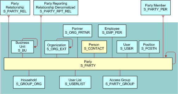

In Figure 9-11, the base table and extension table (S_CONTACT) that define a Person, or Contact, are highlighted. A Person is the simplest representation of an individual in the database.

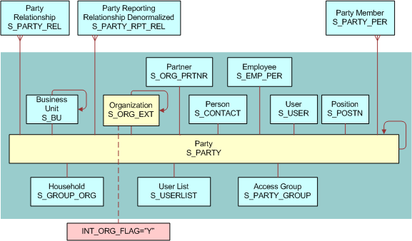

In Figure 9-16 the base table and extension table (S_ORG_EXT) that define a Division are highlighted. In S_ORG_EXT, the flag INT_ORG_FLG = Y specifies that a division is an internal organization. (For an account, this flag is set to N.)

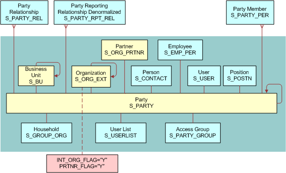

In Figure 9-18 the base table and extension tables (S_ORG_EXT, S_BU, and S_ORG_PRTNR) that define a Partner Organization are highlighted. A Partner Organization is the same as an Organization but the flag PRTNR_FLG in S_ORG_EXT qualifies it as a Partner Organization.

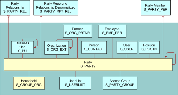

In Figure 9-19 the base table and extension table (S_ORG_GROUP) that define a Household are highlighted.

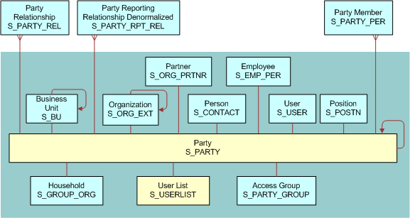

In Figure 9-20 the base table and extension table (S_USERLIST) that define a User List are highlighted.
