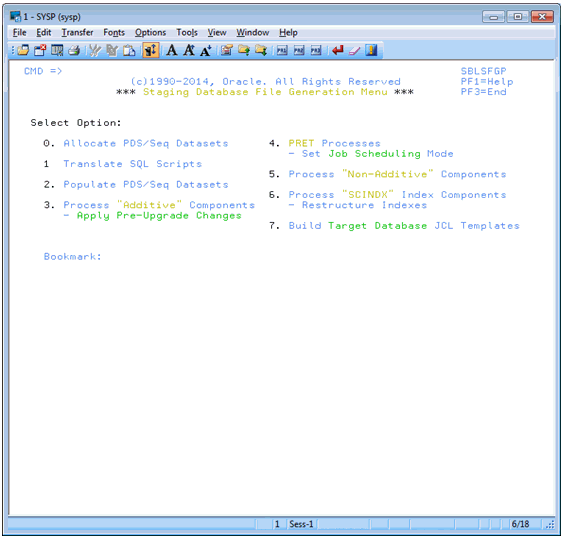

    The Staging Database File Generation Menu is displayed. The panel ID is SBLSFGP.
  3. Select option 0: Allocate PDS/SEQ Datasets, and press Enter.

  7. On the Staging Database File Generation Menu, select option 1: Translate SQL Scripts, and press Enter.

  10. On the Staging File Generation Menu, select option 2: Populate PDS/SEQ Datasets, and press Enter.
