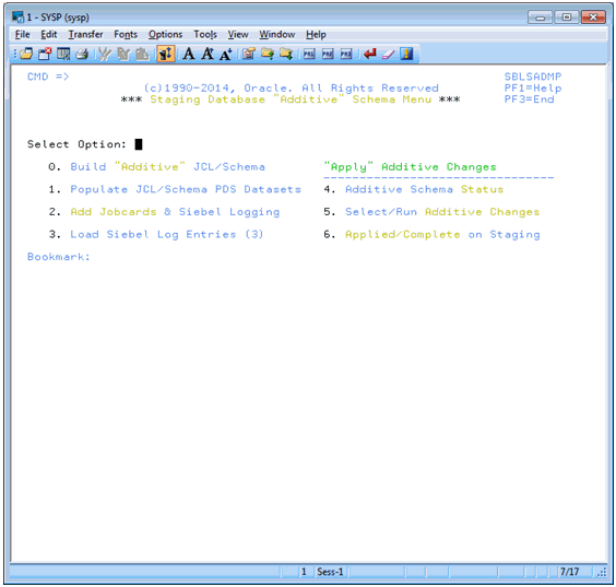

  1. On the Staging Database File Generation Menu, select option 3: Process Additive Components, and press Enter.
    The Staging Database Additive Schema Menu is displayed. The panel ID is SBLSADMP.
  2. Select option 0: Build Additive JCL/Schema, and press Enter,
    Status messages are displayed as the additive components are built.

  16. On the Staging Database Additive Schema Menu, select option 4: Additive Schema Status, and press Enter.
    The Additive Schema Status panel is displayed. The panel ID is SBLSADLP. A list of the additive schema members is displayed and their staging status, either PENDING or COMPLETED.
