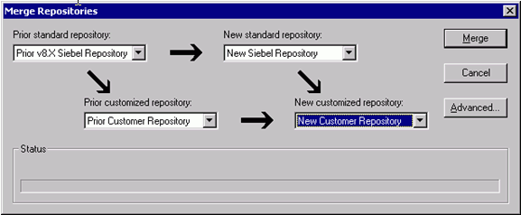

  5. Choose Tools, Upgrade, and then Upgrade Application.
    The Merge Repositories dialog box appears.
    The Merge Repositories dialog box provides the following options:
    • Merge. This button merges the repositories you specify to produce a New Customer Repository.
    • Cancel. This button cancels the repository merge and exits the Merge Repositories dialog box.
    • Advanced. This button opens the Merge Options dialog box described in Step 8.
  6. In the Merge Repositories dialog box, choose the appropriate repository name from each picklist, using the repository names listed in the following table.
    Drop-Down List Item
    Value to Choose
    Prior Standard Repository
    Prior 7.x or 8.0 Siebel Repository, as appropriate for the version from which you are upgrading
    Prior Customized Repository
    Prior Customer Repository
    New Standard Repository
    New Siebel Repository
    New Customized Repository
  7. Review the settings in the Merge Repositories dialog box, then click Advanced.

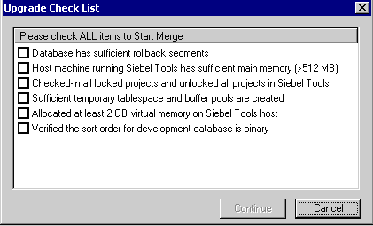

  10. Click Merge on the Merge Repositories dialog box.
    The Upgrade Check List dialog box appears.
  11. In the Upgrade Check List dialog box, you must confirm that your environment meets the requirements for a successful repository merge. Review each requirement and select the check box if your configuration meets or exceeds the requirement.
  12. To continue, click Continue. The merge process begins.
