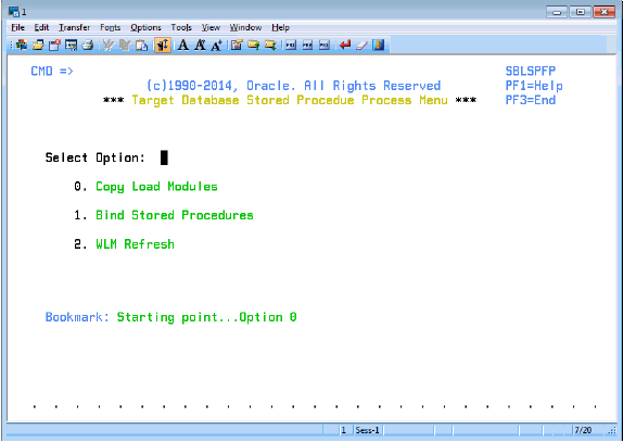

    The Target Database Stored Procedure Process Menu is displayed.
  3. On the Target Database Stored Procedure Process Menu, select option 0. Copy Load Modules, and press Enter.

  7. On the Target Database Stored Procedure Process Menu, select option 1. Bind Stored Procedures, and press Enter.

  11. On the Target Database Stored Procedure Process Menu, select option 2. WLM Refresh, and press Enter.
