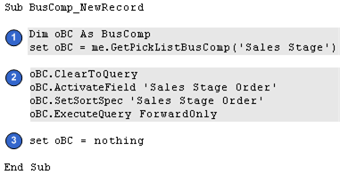

Example of Declaring an Object As a Siebel CRM Object Type
Figure 1 includes an example that configures Siebel VB to access a Siebel object. You can declare an object as a Siebel CRM object type.
Figure 1. Example of Declaring an Object as a Siebel CRM Object Type
Explanation of Callouts
To declare an object as a Siebel CRM object type, you do the following work:
  1. You create an object variable to access the code. This example uses as BusComp to declare the object. It does not use as Object. This example instantiates the business component (BusComp) Siebel object type. You could declare it as an object, but if you use the methods associated with the object type, then you must declare it as the appropriate object type.
  2. You can use methods and properties to manipulate the objects.
  3. Set oBC to nothing. It is recommended that you always set an object to nothing when your code instantiates it.
You can use similar code to access other types of objects that are compliant with COM. You can use the software application that creates the object to modify properties and methods of the objects. For an example, see Date and Time Methods.
Creating an Object Variable to Access an Object
The Declare Variable statement creates an object variable named oBC and assigns a picklist business component to this variable. The Assign COM Object statement uses a get method to assign the business component to the oBC variable. Note the following:
  • If you instantiate an application, then you can use the GetObject method or the CreateObject method.
  • If the application is already open on the Microsoft Windows desktop, then you use GetObject.
  • If the application is not open, then you can use CreateObject.
For more information, see the following topics:
Using Methods and Properties to Manipulate an Object
You can use the following format to access an object, property, or method:
appvariable.object.property
appvariable.object.method
For example, the GetPickListBusComp method of the BusComp object of the Siebel application is assigned to the oBC object variable. It returns the following value:
me.GetPickListBusComp("Sales Stage")
