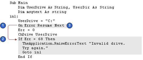

Siebel VB Language Reference > Using Siebel VB > About Error Handling > Handling Errors That Siebel VB ReturnsThis topic describe how to write code that handles the errors that Siebel VB returns. Using the Body of the Code to Handle Siebel VB ErrorsTo handle errors in the body of code, you place the code that handles the error immediately before the line of code that could cause an error. Figure 2 includes an example that handles errors in the body of the code. Explanation of CalloutsThe example that handles errors in the body of the code includes the following items:

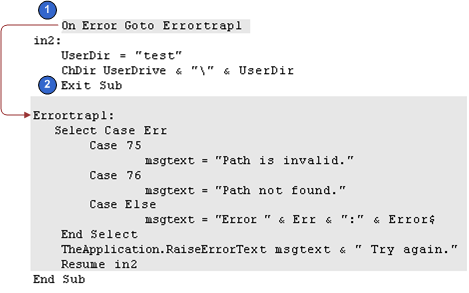

Using an Error Handler to Handle Siebel VB ErrorsFigure 3 includes an example that uses an error handler to handle errors. Explanation of CalloutsThe example that uses an error handler to handle errors includes the following items:
