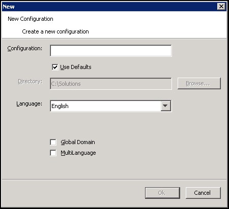

Complete the following steps to create a project.
Navigate: From the File menu, select New and then Project, or right-click in the Configuration Manager and select New and then Project. The New Window opens.
In the Configuration field, enter the name of the configuration/project.
The Use Defaults option under the Configuration field points the user to a default path for storing the configuration. Clear the Use Defaults check box to enable the user to navigate to the appropriate directory using Browse.
Select the default language for the domain in which this configuration will be used to create. The default is English.
Select the options for Global Domain and MultiLanguage as necessary. The possible settings for these boxes are as follows:
Global Domain – Selecting this option overrides the default setting of ”Simple Domain.” A Global Domain allows the user to create workbooks from multiple domains and to administer and update multiple domains from a single master domain. Whether a domain should be Global is a technical decision that must be made with the consultation of Oracle Services. This setting cannot be changed after the domain is built.
MultiLanguage – If this option is selected the resulting domain will be enabled to support multiple languages. Multi-lingual domains allow for most data elements (measures, labels, and so on) in an RPASCE domain to be translated into other languages. The MultiLanguage setting cannot be changed after the domain is built. More information on Multi Language support can be found in the Translation Administration chapter of the Oracle Retail Predictive Application Server Cloud Edition Administration Guide.
Note: Changes to the Global Domain and the MultiLanguage properties can result in errors when patching an existing domain. |
Click OK to save any changes and close the window.

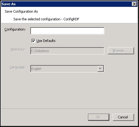

Complete the following steps to use the Save As option to save a project using a different name.
Navigate: From the File menu, select Save As, or right-click in the Configuration Components pane and select Save As. The Save As window opens.
In the Configuration field, enter the new project name.
If Use Defaults is selected, click OK to save the project to the path displayed in the Directory field. If Use Defaults is selected and you want to save the project to a different location, clear Use Defaults and either enter the appropriate path in the Directory field or click Browse to navigate to the appropriate location where you want the project saved.
Click OK to save the project.

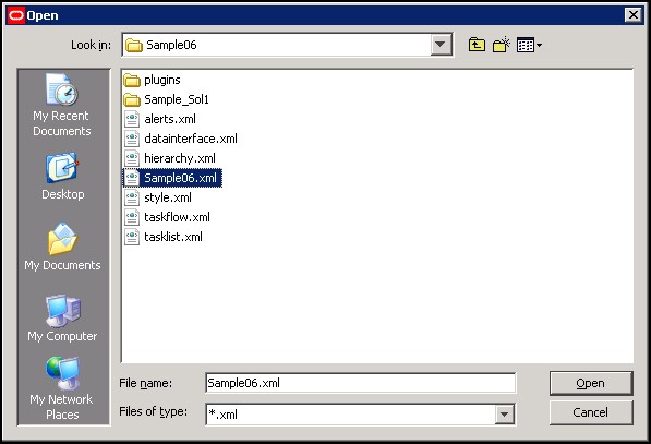

Complete the following steps to open an existing project.
Navigate: From the File menu, select Open or right-click in the Configuration Components pane and select Open. The Open window opens.
Choose one of the following methods:
Browse to the directory where your project is saved. Select the file whose name is the same as the project with an .xml extension and click Open. The project displays in the Configuration Components pane.
To open a project that was recently opened, select the project from the recently used projects list in the File menu. These projects display as a numbered list where the most recently used project is first in the list. Select the project to open in the Configuration Components pane. The number of projects that display in the most recently used list may be changed from the Workbench Preferences window, which is accessed by selecting Tools Preferences from the File menu.

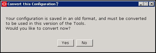

A message box opens:
Figure 3-4 Convert This Configuration Message Box
To convert at a later time without currently viewing or modifying the project, click No. Click Yes to convert the project so it can be viewed or modified. If Yes is selected, the Choose a Backup Location Message Box opens.

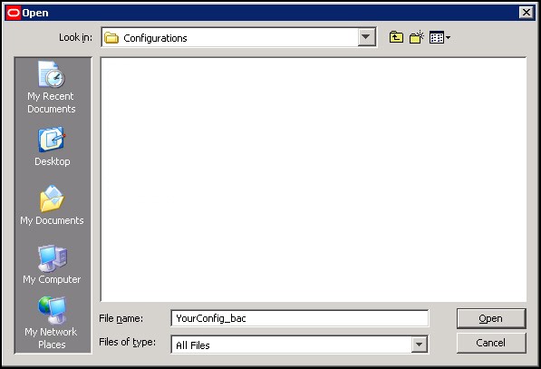

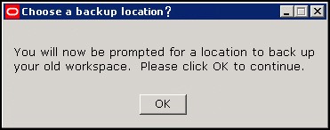

Figure 3-5 Choose a Backup Location Message Box
Click OK. The Open Window for Saving Configuration Backup opens and prompts you for a location to store a backup of the project that is to be converted.
Figure 3-6 Open Window for Saving Configuration Backup
Note: You may either rename the original configuration that is to be backed up or specify a new directory to store the original. |

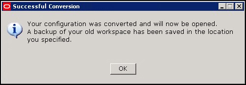

Select the directory to store the backup and click Open. The conversion process begins. If the conversion successfully completes the following message displays. Click OK to continue and view the project.

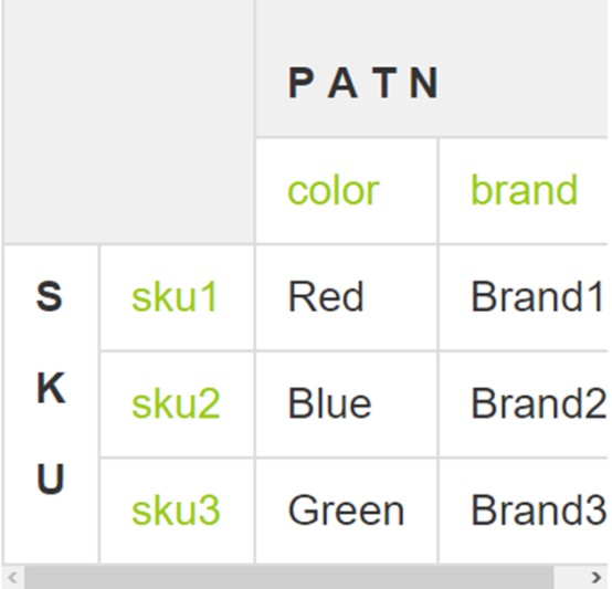

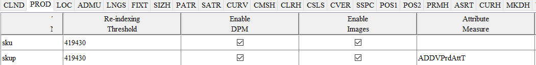

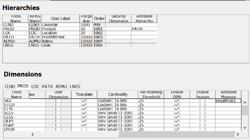

Dimension Attributes provide the ability to specify information about attributes that describe the positions within a hierarchy. For instance, Product Hierarchy positions may be represented by attributes describing color, brand, material, and so on.
Some applications that support processes that are heavily attribute driven make use of a construct often called an Attribute Hierarchy. An attribute hierarchy commonly contains two dimensions: a base dimension whose positions correspond to defined values for attributes and a parent dimension whose positions represent the attributes used by the application.
Using the color attribute as an example, an application containing an attribute hierarchy for Product would define positions for blue, green, red, and so on, on the attribute value dimension, which would then roll-up to the color position of the attribute position.
The existence of the attribute hierarchy allows applications to provide configured content that is aware of attributes and can use the values of attribute as an input into application processes. Examples of such functionality include rules whose execution logic depends upon the attribute values of the positions being evaluated or the ability to allow users to select attribute values from a drop-down list (as opposed to typing the attribute values into a text field.)
In order to leverage the existence of attribute hierarchies and to allow platform functionality to make use of the information contained within attribute hierarchies to simplify and improve the workflow of users, the hierarchy definition tool supports associating an attribute hierarchy with the hierarchy for which it provides attribute information.
In the previous example, an application contains an attribute hierarchy PATH (for Product Attribute) that contains information about attributes of the product hierarchy. By specifying PATH in the attribute hierarchy property of the product hierarchy, the configurer can provide this information to the platform so that core platform features can make use of the attribute information contained within PATH.
Figure 3-9, Figure 3-10, and Figure 3-11 illustrate how to configure the dimension attribute in Configuration Tools.
Figure 3-9 Associate Hierarchy to Attribute Hierarchy
Figure 3-10 Associate Attribute Measure to Dimension

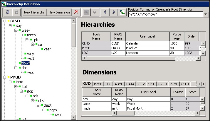

The Hierarchy Definition window allows you to define and construct hierarchies, dimensions for each hierarchy, and the relationships between dimensions. It also offers the following features:
Provides a visual representation of a hierarchy and its dimensions
Provides a means to define the hierarchy data load file
Allows existing hierarchies/dimensions to be reused in a new solution in the same project

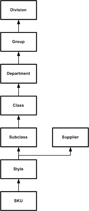

The Figure 3-12 diagram represents a typical structure of an organization's product hierarchy.
Figure 3-12 Example of Product Hierarchy
In the Figure 3-12 example, the Style dimension has two parents: Subclass and Supplier. Each position in the Style dimension will have a parent position in both the Subclass and Supplier dimension.

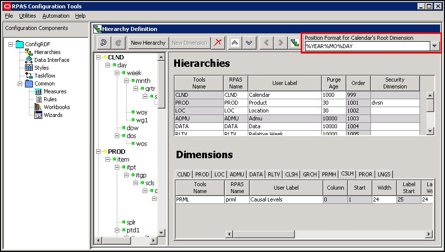

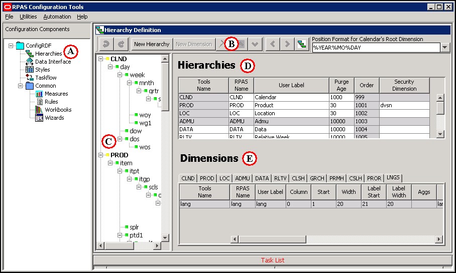

To access the Hierarchy Definition window, select Hierarchies (A) from the Configuration Components pane. The Hierarchy Definition window opens in the workspace.
Figure 3-13 Example of Hierarchy Definition Window
The Hierarchy Definition window contains the following elements:
Table 3-1 Hierarchy Definition Window Elements
| ITag | Element | Description |
A |
Configuration Components pane |
B |
Hierarchy Definition toolbar |
This toolbar displays options that can be performed. Buttons are enabled or unavailable based on the item selected on screen. |
C |
Hierarchy navigation tree |
The navigation tree provides a visual representation of your hierarchies. Bold elements at the top of the tree structure represent the hierarchies. The items listed underneath each bold hierarchy are the dimensions defined in that hierarchy. Click Plus or Minus to expand the tree. The Hierarchy tree is also used to select a hierarchy or hierarchy dimension. Once an item is selected, you can modify its properties from the Dimension region in the Hierarchy Definition window. The Hierarchy navigation tree also provides a context menu when you right-click a tree item. The available options in the context menu depend on whether a hierarchy or dimension is selected. This context menu can be used to create a new hierarchy or dimension at the selected level. It also allows you to rename the selected item. When an item is renamed from the tree, it is the Tools Name that is being modified, which displays in the Dimensions region of the window. |
D |
Hierarchies region |
This area displays the defined hierarchies and their properties. |
E |
Dimensions region |

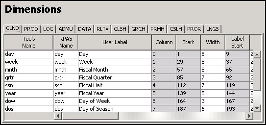

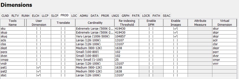

This area contains hierarchy tabs and allows you to define the dimension properties for your hierarchies. The tabs represent the hierarchies defined. Select the appropriate hierarchy tab to display its dimensions and modify dimension properties. |
Gray fields in the Hierarchy Definition window indicate fields that cannot be modified. Any elements that display in red indicate problems or issues must also display in the Task List pane along with a brief description of the issues identified.

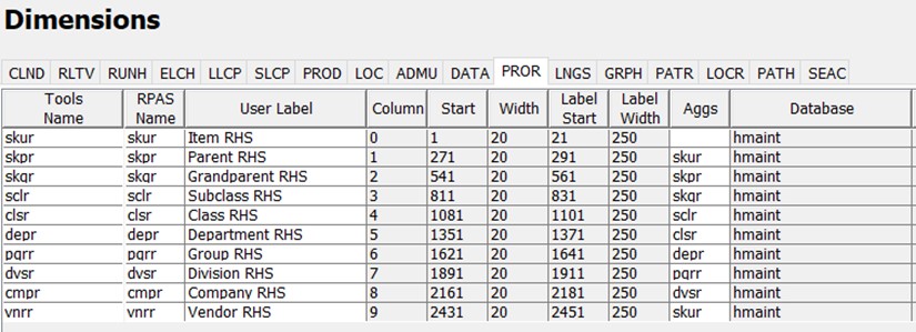

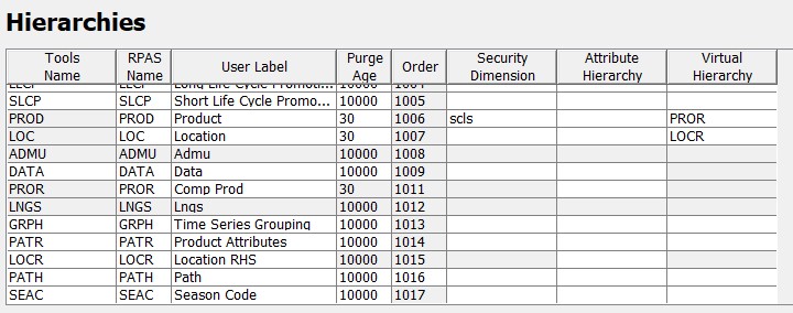

Hierarchy properties are defined from the Hierarchies region on the Hierarchy Definition Window.
From this location you can modify the following hierarchy properties:
Tools Name
The name of the hierarchy that displays within the RPASCE Configuration Tools. This field is less restrictive than the RPAS Name field, allowing you to view and select a meaningful label for hierarchies and dimensions while working with the configuration rather than using the RPAS Name.
RPAS Name
The RPAS internal name of the hierarchy. This hierarchy name is used only by RPASCE (not the user) within the domain.
Note: The RPAS Name of a hierarchy cannot be edited if it is shaded gray; however, you can change other properties, such as User Label.CLND is always the innermost dimension. The order of the other hierarchies (PROD, LOC, and so on) can be changed. |
User Label
The hierarchy label that is displayed to RPASCE users within the domain.
Purge Age
The purge age determines when a position and its corresponding measure data are removed from a domain. Specifically, it represents the number of days before the data is purged from the last time the position was included in the hierarchy input file that is loaded with the loadHier utility during a batch run (most commonly on a nightly or weekly basis). Setting this value to zero means that a position and all of its data will be immediately purged if it is not included in the hierarchy file.
Note: The value set in this field serves as the default value to use when loading the corresponding hierarchy. This value can be overwritten by one of the arguments of theloadHier utility each time the utility is called. See the Oracle Retail Predictive Application Server Cloud Edition Administration Guide for more information on the loadHier utility. |
Example 1: A purge age of 0 will purge positions the first night they are not in the input file.
Example 2: A purge age of 1000 will purge the positions the 1000th night after they are last seen on the input file.

It is recommended that retailers order their hierarchies with Calendar as the innermost dimension (required), followed by other hierarchies in their order of importance/traversal – most commonly Product, Location, and then other hierarchies (if applicable).
Note: Certain RPASCE-based solutions (such as Advanced Inventory Planning and Demand Forecasting) have additional hierarchies that are in a predefined order that should not be changed. |
The Order column also indicates the order in which the hierarchy information is expected in the file used for measure data loading purposes.
Note: The values 1000 or 1020 are not used as a hierarchy order as they are used internally by RPASCE.CLND is always the innermost dimension and ADMU is always the outermost dimension. The order of the other hierarchies (PROD, LOC, and others created by the configuration administrator) can be changed. |
Security Dimension
Selecting a security dimension for a hierarchy enables position-level security in the domain for the corresponding hierarchy. Any dimension along any hierarchy except the Calendar hierarchy is valid. For example, if the security dimension for the product hierarchy is set to Dept (Department Level Security) within the domain, access to departments can be granted or denied by the administrator for individual users, user groups, or all users. If position-level security is to be enabled in RPASCE, select the security level. Refer to the Oracle Retail Predictive Application Server Cloud Edition Administration Guide for additional information about position-level security.
Note: The Security Dimension hierarchy can be changed and patched. It will not adversely affect the results if changed. |
Attribute Hierarchy
Specifying an attribute hierarchy for a hierarchy instructs the system that the information contained within the attribute hierarchy should be used to assist operations involving attributes for the hierarchy so specified. For example, specifying the value PATH for the Product hierarchy specifies that a hierarchy named PATH exists in the domain whose positions contain attribute information about the Product hierarchy.
Note: The Attribute hierarchy can be changed and patched. |
Virtual Hierarchy
Specifying a virtual hierarchy for this hierarchy. This is an optional property and can be left blank when no virtual hierarchy exists for this hierarchy.
The hierarchy order of the virtual hierarchy must be different than its original hierarchy.
Both the Security Dimension and Purge Age columns are not editable for the virtual hierarchy since the virtual hierarchy inherits them from its original hierarchy.
The attribute hierarchy of the virtual hierarchy can be configured by the user. The virtual hierarchy can have the same or a different attribute hierarchy than its original hierarchy.
A virtual hierarchy cannot have another hierarchy defined as its virtual hierarchy as its virtual hierarchy column is unavailable from editing.
All dimensions within a virtual hierarchy are virtual dimensions and should be configured so in the Dimensions table.
Note: The virtual hierarchy can be changed and patched in the RPAS CE domain. The virtual hierarchy must sync with the changes in the Virtual Dimension table. If a virtual hierarchy is changed from set to unset in the Hierarchies table, then all its virtual dimensions must be unset as well in the Dimensions table, and vice versa. |

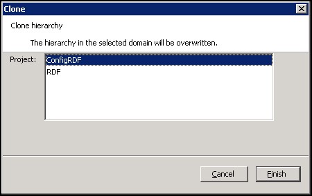

The RPASCE Configuration Tools allows for the hierarchies of an existing project to be copied into a new or existing project.
Complete the following steps to copy (clone) hierarchies.
Navigate: In the Configuration Components pane, select Project and then Hierarchies. The Hierarchy Definition Window opens in the workspace.
Right-click Hierarchies in the Configuration Components pane and select Copy. The Clone Window opens.
Select the destination project for the hierarchies to be copied.
Click Finish. The hierarchies in the selected project are overwritten.
Note: Each project has a single set of hierarchies. Hierarchies can only be copied from one project to another, thus multiple projects must be open in the RPASCE Configuration Tools before the copy process is initiated. |
The Position Format is the date/time format used for the names of positions in the root dimension of the CLND (Calendar) hierarchy (typically day). Positions in the root dimension of the CLND hierarchy need names in a special format for RPAS CE to map abstract positions to actual dates and times in order to support time-aware calculations.
Note: See Appendix C, "Appendix – Calculation Engine User Guide" and Appendix D, "Appendix – Rules Function Reference Guide" for more information. |
Figure 3-18 Example of Position Format in Hierarchy Definition Window
The Position Format Field is located in the upper right-hand side of the Hierarchy Definition toolbar.
This is a combo box that is populated with some of the more commonly used formats. However, the configuration administrator may also type directly in the combo box if a different format is desired.
Specify the position format as a concatenated sequence of strings and arguments using the appropriate syntax. Refer to Position Format Syntax for more information.
The Position Format field uses the following syntax conventions:

Dimensions are the components within a hierarchy that define the structure and roll up within a hierarchy. For example, the dimensions for a calendar hierarchy can be day, week, month, and year, or they can be accounting periods.
Complete the following steps to create a dimension.
Select the hierarchy or dimension under which to create the new dimension.
Note: When this guide uses terms like top and bottom level dimensions or over and under, these terms are to be interpreted visually. The bottom level is at the top of the hierarchy, and the top levels are at the end of the hierarchy branches. For example, the top dimension visually is the root dimension, which is the lowest dimension in the hierarchy. The highest dimensions in the hierarchy are at the bottom end of the hierarchy branches. For instance, Day is the bottom level of a Calendar hierarchy, but it falls directly beneath CLND. |
From the Hierarchy Definition right-click menu, select New Dimension.
Click New Dimension from the toolbar.
Create the first dimension, which becomes the root dimension, for a new hierarchy when positioned on the hierarchy. Once the root dimension is defined, new dimensions cannot be defined directly under the hierarchy. New dimensions are added under other dimensions. For example, after "Day" is added to the CLND hierarchy, CLND cannot be selected again to add "Hour." However, "Week" can be added under the "Day" dimension. There can only be one root dimension created per hierarchy.
Note: Certain processes that support the purging of data or positions and the mapping of real dates/times to positions require a dimension in the CLND hierarchy that is named "day" and represents the day level. Such a dimension must be defined, although the user label can be changed from "day" if needed for localization purposes.There is no limit on the number of dimensions that may be created for a hierarchy. |
Define the dimension as necessary. Refer to "Defining Dimension Properties" for more information.
Complete the following steps to define the dimension properties.
Select a dimension using one of the following methods:
From the Hierarchy tree, select the dimension you want to modify.
From the Dimensions region of the Hierarchy Definition window, select the hierarchy tab that contains the dimension you want to define or modify.

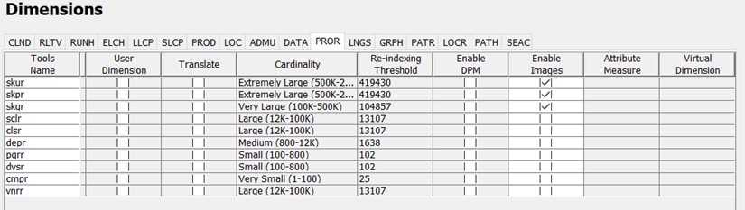

Figure 3-20 First Half of the Dimensions Properties Window PROD Tab Selected
Figure 3-21 Second Half of the Dimensions Properties Window PROD Tab Selected
Figure 3-22 First Half of the Dimensions Property Window PROR Tab Selected
Figure 3-23 Second Half of the Dimension Properties Window PROR Tab Selected
In the Dimensions properties region, select or double-click in the field to edit. Scroll to the right to see all of the fields. You can resize the columns by placing the cursor over the column until the double-sided arrow displays and then drag the column to the desired width.
Other than the RPAS name, the columns can be reordered by dragging and dropping the headings. The column positions will return to the default order when the session is closed.
You can specify the following dimension information:
Note: Only four of the dimension properties are patchable in an existing domain. Once the domain is built, changes made to any other dimension properties are ignored.If a dimension's property is patchable, it stated in a note in its description listed in Dimension Properties Descriptions. |
Tools Name
The name of the dimension that is displayed within the RPASCE Configuration Tools. This field allows you to assign meaningful labels while working with a configuration in the Configuration Tools. For example, the Tools Name displays in Select Intersection window, making it easier for you to assign the appropriate intersections.
RPAS Name
The RPAS internal name of the dimension. This dimension name is used only by RPASCE (not the user) within the domain.
User Label
The dimension description that is displayed to RPASCE users in the RPASCE Client.
Note: Any alpha-numeric characters are allowed. Single or double quotes are not allowed. |
Column
Identifies the order in which the dimension's positions fall in the meta-data load file. Use the left and right arrow buttons to change the order and the column value of the dimensions. Changing the column value will not affect the hierarchy structure or aggregation paths.
Note: The up and down arrow buttons are used for defining the sequence of hierarchies. |
Example:
Change the column values if the dimensions in the data load file are not in the same order as in the tree structure. Dimensions will be moved up or down in the table without impacting the aggregates.
Start
This is a read-only, calculated field. This field identifies the start position of the position names for this dimension in the hierarchy load file.
Width
This field identifies the width of position names for this dimension in the hierarchy load file.
Label Start
This is a read-only, calculated field. This field identifies the start position of the position label for this dimension in the hierarchy load file. The sum of the dimensions Start and Width fields determines the value of the Label Start.
Label Width
This field identifies the width of position labels for this dimension in the hierarchy load file.
Note: When using comma separated value (CSV) files to load data into RPASCE, the following dimension are ignored: Column, Start, Width, Label Start, and Label Width. See the Oracle Retail Predictive Application Server Cloud Edition Administration Guide for more information on Comma Separated Value (CSV) flat file format data load and export. |

User Dimension
When selected (checked), this field indicates that the dimension is user maintained. User-defined definitions (UDD) cannot have another dimension as a parent. Positions and position mappings (parent-child relationships) for user-defined dimensions are established in the RPASCE Administrative workbook template, ”Hierarchy Maintenance.” This meta-data cannot be loaded like regular (non-user-defined) dimensions in the hierarchy load process. A DPM-enabled dimension cannot be set to User Dimension and vice versa.
Translate
When selected, this field enables the position labels for the dimension to be translated into multiple languages (if using a multi-lingual environment, which is set as a Workspace Property for a given project). Positions are loaded into the domain in the native language of the domain via the standard hierarchy load process. Position labels for additional languages are loaded into special measures that are used in multi-lingual domains. With the proper setup, these translated position labels can be displayed in workbooks in the RPASCE Client instead of the loaded position labels. See the Oracle Retail Predictive Application Server Cloud Edition Administration Guide for detailed instructions for enabling position label translation.
Note: Enabling the translation of a dimension is patchable and does not adversely affect the expected results if altered. However, disabling translation is not patchable and may result in failure. |
Cardinality
Use this field to specify the approximate size of a dimension in terms of the number of positions the dimension is expected to contain. Based on the range you select, RPASCE allocates a number of bits within its internal representation of the dimension and all measures that contain that dimension in their intersection. This ability to configure the amount of space necessary to represent the positions of a dimension will result in smaller domains. The range options are:
Very small: between 1 and 100 positions (8 bits)
Small: between 100 and 800 positions (10 bits)
Medium: between 800 and 12,000 positions (14 bits)
Large: between 12,000 and 100,000 positions (17 bits)
Very Large: between 100,000 and 500,000 positions (20 bits)
Extremely Large: between 500,000 and 2,000,000 positions (22 bits)
Ultra Large: between 2,000,000 and 4,000,000 positions (23 bits)
Custom: selecting this option allows you to enter a specify bit number. An input window opens. Enter the bit number and click OK.
Figure 3-24 Input Window for Custom Cardinality Option
Note: The cardinality property of a dimension is patchable. However, changes to the cardinality of a dimension will not take effect until the reindexDomain utility is executed on the domain after the dimension is patched. |
Re-indexing Threshold
Use this field to specify the reindexing threshold. As a dimension exhausts its supply of unused indices, RPASCE recycles the deactivated positions and compacts the indices of a dimension. This operation is known as re-indexing. When reindexDomain is run, every dimension is analyzed to determine how many indices are still available to be assigned. If this amount falls below a certain number (the re-indexing threshold), that dimension is reindexed. By default, the threshold is set to 10% of the available positions in the dimension. This means that when more than 90% of a dimension's positions have been allocated, the dimension is reindexed. For more information about reindexing and the reindex utility, see the Hierarchy Management chapter of the Oracle Retail Predictive Application Server Cloud Edition Administration Guide.
Note: The re-indexing threshold property of a dimension is patchable. However, changes to the re-indexing threshold of a dimension will not take effect until the reindexDomain utility is executed on the domain after the dimension is patched. |
Enable DPM
Dynamic Position Maintenance (DPM) allows informal positions to be added to a dimension on-the-fly from the RPASCE Client. Select the Enable DPM option for the dimensions that will be enabled to support DPM. After Enable DPM is defined for the dimension, you must also specify workbooks and the dimensions in each workbook that will use DPM (see the Workbook Designer window for more details). A user defined dimension cannot be enabled to support DPM, and vice versa.
Note: DPM can be enabled for all hierarchy dimensions except for CLND, ADMU, and LNGS.When Enable DPM is selected for a specified dimension, it is also selected for all dimensions that roll up to it. For more information on DPM, see the Oracle Retail Predictive Application Server Administration Guide and Oracle Retail Predictive Application Server User Guide. Enabling DPM is patchable and will not adversely affect the expected results if altered. However, disabling DPM is not patchable. DPM may be unavailable for the templates, but not for the dimension. |
Enable Images
Select this option to enable the association of images (image paths) to positions along the specified dimension. To disable this feature, clear the option for the appropriate dimensions. This option is available for all hierarchy dimensions, except the calendar hierarchy. For the calendar hierarchy, the Enable Images column is unavailable or grayed. RPASCE supports GIF, BMP, and JPEG image formats. Once Enable Images is defined for a dimension, you must also specify the workbook that will use this feature (see the Workbook Designer window for more details). This is the legacy functionality for displaying images in the application. It is still supported for backward compatibility; however, the new preferred way for displaying images is using a dimension attribute measure of type string with the UI Type property set to media. For more information, see "Images and Contextual Help" in Oracle Retail Predictive Application Server Cloud Edition Administration Guide.
Note: Enabling and disabling images is patchable and will not adversely affect the expected results if altered. |

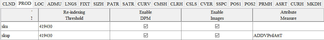

Attribute Measure
Attribute Measure is used to support dimension attributes and store dimension attribute values for the current dimension. See the Oracle Retail Predictive Application Server Cloud Edition Administration Guide and Oracle Retail Predictive Application Server Cloud Edition User Guide for more information on Attribute Measure.
Attribute Measure is available for selection if the hierarchy of the current dimension has Attribute Hierarchy defined and qualified measures exist in the domain. The candidate measures must meet the following criteria: String type, have storage database in domain, 2-D measure with the base intersection at current dimension and the attribute name dimension. The user can select, at most, one attribute measure from the drop-down list. The selected measure is displayed in the Attribute Measure field.
In the following example, the Prod hierarchy has the attribute hierarchy PATH configured with the attribute value dimension. PATV rolls up to the attribute name dimension PATN. Suppose the PATV dimension has position Blue, Red, Green, Brand1, Brand2, Brand,3 and the PATN dimension has the position color and brand. The PATV positions Blue, Red, and Green roll up to the PATN position color, and
Brand1, Brand2, and Brand3 roll up to the PATN position brand. Then the Sku dimension has the qualified measure skuattrval1 available for selection.
Figure 3-25 The Example Content of the Attribute Measure skuattrval1
Figure 3-26 The Dimensions Properties Table Showing Attribute Measure Field
Note: If the attribute measure setting is changed between configurations, the existing domain must be patched with the new configuration to sync up the RPASCE metadata. |

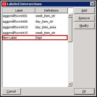

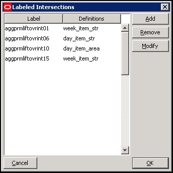

The Labeled Intersections window supports the addition, removal and modification of hierarchy intersections. A hierarchy intersection defines the dimensionality at which data is defined. An intersection may be defined as using no dimension (scalar), using a single dimension from a hierarchy, or multiple dimensions from different hierarchies.
Note: See the section Measure Definition and Base Intersections for more information on defining intersections for data. |
Navigate: In the Configuration Components pane, select Project and then Hierarchies. The Hierarchy Definition window opens in the workspace.
From the Hierarchy Definition toolbar, select the Labeled Intersection icon. The Labeled Intersections window opens. This window allows you to add new intersections or remove or modify existing intersections.
Figure 3-28 Labeled Intersections Window

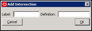

Complete the following steps to add a labeled intersection.
Click Add from the Labeled Intersection window. The Add Intersection window opens.
Complete the following:
In the Label field, enter a label for the Labeled Intersection.
In the Definition field, enter the dimension names for the intersection.
Click OK. The window closes, and the new entry displays in the Labeled Intersection window.
Note: If the Definition field is left empty, the measure is assumed to be Scalar. If the level is non-scalar, dimension names are used to define the intersection. If multiple dimension names are to be specified, each dimension name must be separated by an underscore (_). The last dimension specified should not have an underscore following the dimension name. As well, there is no required order of dimensions. |
Figure 3-30 Example of New Labeled Intersections
Click OK.

Complete the following steps to modify a labeled intersection.
Select a labeled intersection.
Click Modify from the Labeled Intersection menu.
Only the Definition field can be modified.
Click OK. If the change is undesired, click Cancel.
When the Definition of an existing labeled intersection is modified, the base intersections of measures and worksheets, and load intersections of measures that are currently assigned the labeled intersection are automatically updated. No action is required.
Complete the following steps to remove a labeled intersection.
Click Remove from the Labeled Intersection window.
Click OK.
When an existing labeled intersection is removed, the base intersections of measures and worksheets, and load intersections of measures that are currently assigned the labeled intersection will be displayed as invalid (red). Warning messages also display in the Task List, indicating the intersections that must be updated. These intersections must be corrected prior to installing or patching a domain.
Users can use the combination of Attribute Hierarchy and Attribute Measure to configure 2-dimensional dimension attributes. The 2-dimensional dimension attribute does not replace the static 1-dimensional dimension attribute using 1-dimensional measures. The dimension attributes defined using Attribute Hierarchy can only handle String type measures. The 2-dimensional dimension attribute is a complement, rather than a replacement, of the static 1-dimensional dimension attribute.
To configure 2-dimensional attributes, first, users must configure the attribute hierarchy and attribute measure. See the previous Attribute Hierarchy and Attribute Measure sections for details. Using the examples there, users must configure PATH as the attribute hierarchy for PROD (Product) hierarchy and measure skuattrval1 as the attribute measure for SKU dimension.
The hierarchy PATH contains the PATN and PATV dimensions with PATV rolling up to PATN. New attributes such as Color and Brand are positions along the PATN dimension, and new attribute values such as red, blue, green, brand1, brand2, and brand3 are positions along the PATV dimension.
Second, the new attribute name and attribute value positions must be loaded into the domain. Within Attribute Hierarchy, the new dimension attributes are simply the new positions on the attribute name dimension. In other words, the new attribute and all its valid positions and children positions must be provided in the attribute hierarchy load file. Usually, the loadHier call is used to add the attribute.
Third, after the dimension attribute positions are loaded into the domain, users must enable the new attributes for the particular dimension. As in the previous example, valid values have been loaded into the domain's PATN and PATV dimensions. Now users must enable the Color and Brand attributes for the SKU dimension. This is achieved by running the following commands in the domain's root directory:
dattrmgr -d . -register skuattrval1 -dattname color
dattrmgr -d . -register skuattrval1 -dattname brand
The measure name skuattrval1 must match the one specified as the attrmeas property for the SKU dimension, and the dattname must be the attribute name in the PATN dimension.
Note: The 2-dimensional dimension attributes do not support dynamic dimension attributes that are dimension attributes defined on a slice of the multi-dimension measure array. A dynamic dimension attribute requires its own infrastructure to store the slicing information and depends on the 1-dimensional dimension attribute infrastructure. |

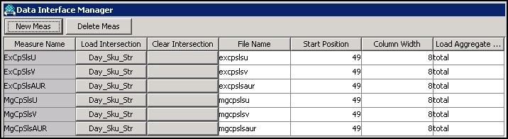

The Data Interface Manager tool is used to specify information about how data will be loaded into the domain. This includes properties of the file to be loaded and the intersection at which data is loaded into the domain.
Data can only be loaded into stored, realized measures in the domain. Therefore, only such measures can be used in the Data Interface Manager. Refer to Working with Measures section of this guide.
Complete the following steps to specify the data interface for a measure.

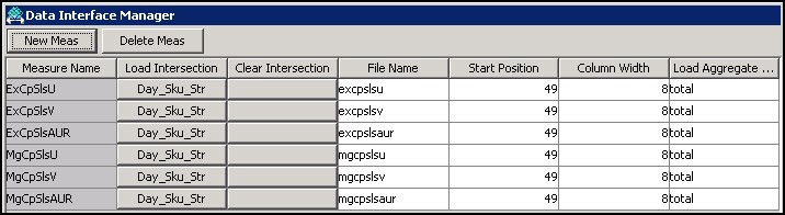

Navigate: In the Configuration Components pane, select Project and then Data Interface. The Data Interface Manager window opens in the workspace.
Figure 3-31 Example of Data Interface Manager Window

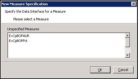

Click New Meas. The New Measure Specification window opens.
Figure 3-32 Example of New Measure Specification Window
Note: This is a filtered list of all possible measures in the configuration. Measures will be displayed in this list if they are: realized, stored (has a defined database), and not already defined in the data interface tool. |
Select the measure requiring a data interface definition.
Click OK. The measure displays in the Data Interface Manager window.
Complete the following steps to add and or edit data interface properties for a measure.
By default, the Load Intersection field is populated with the base intersection of the measure. If the data for a given measure is being loaded at a lower intersection than the base intersection of the measure, this value can be overridden to specify the intersection.
Note: Data can be loaded at the same intersection or lower than the base intersection of a measure. Data cannot be loaded at a higher intersection than the base intersection. |
Figure 3-33 Data Interface Manager Window – Add/Edit

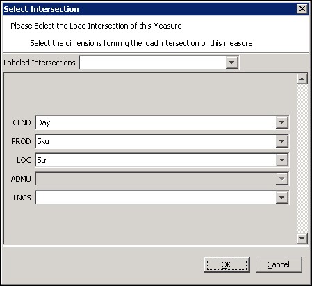

Click the Load Intersection field to change its value. The Select Intersection window opens.
To specify the load intersection:
Using the list options, select the appropriate dimensions or Labeled Intersection.
Note: Only those dimensions that are at the same level as the base intersection or lower is displayed for the load intersection. |

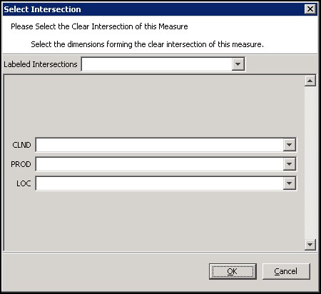

Click the Clear Intersection field to change its value. The Select Intersection window opens.
Note: The clear intersection allows support for.clr measure data files. Using .clr files with loadMeasure allows the clearing of selected portions of a measure's data arrays. |
To specify the clear intersection:
Note: Only those dimensions that are at the same level as the base intersection or higher are displayed for the clear intersection. |
Click OK to save any changes. Close the window.
In the File Name field, enter the file name from which data for the measure will be loaded.
In the Start Position field, enter the character position in the file where the measure data starts. The start position defaults to the sum of all the dimension widths in the load intersection of the measure +1, and the value specified in the field must be that default or higher.
In the Column Width field, enter the number of characters in the file that will contain the measure data.
Note: The Column Width defaults to 8, but it can be changed. |
If the Load Intersection was overridden to specify that the data is to be loaded from an intersection lower than the measure's base intersection, the measure's default aggregation method is used to aggregate the data unless the Load Aggregate field is populated to specify an alternate aggregation method. Click the Load Aggregation Method field and select the appropriate aggregation method from the option list.
Note: Hybrid is not supported for the load aggregation for a measure. |

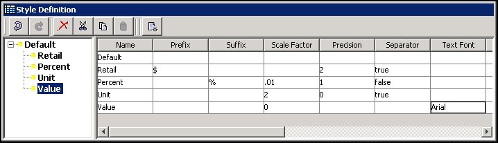

Using the Style Tool, it is possible to define styles that may be applied to measures. These predefined styles may specify any of a body of attributes that determine the appearance of the data within the client. It is then possible to specify a measure as using one of these pre-defined styles. The measure will then be displayed according to the specifications for that style.
Note: The RPASCE Client is not aware of styles which are a configuration convenience. In the client, the individual properties are maintained individually. A style can therefore be thought of as a mechanism to easily set many individual properties. |
The Style Definition Tool provides the following functionality:
Allows the creation and management of named styles. New styles are generated as sub-styles of existing styles.
Allows the specification of the attributes of named styles. Style attributes follow an inheritance scheme in which any unspecified attribute will inherit a value from its parent style if that style has a specification.
Allows the specified styles to be visible to the Measure and Workbook Tools where measures are marked as using a style.
A number of attributes may be specified for a style. These attributes will determine how the data for a measure that uses the style is displayed within the RPASCE Client. Style attributes follow an inheritance framework in which an attribute defined in one style is also defined for all of the children of that style unless a style is defined for a child. The attributes of a style that may be specified are as follows:
Name
The name of the style. This is used in the Measure and Workbook Tools to assign a style to a measure. Since styles are a configuration convenience, style names are not visible in the RPASCE Client.
Prefix
A cell value in the RPASCE Client will be prefixed with this string. For example, a prefix could be ”$” to denote U.S. currency values. The prefix can be any character sequence but cannot exceed seven characters.
Suffix
A cell value in the RPASCE Client will be suffixed with this string. For example, a suffix could be ”%” to denote that the value in the field is a percentage of something. The suffix can be any character sequence but cannot exceed seven characters.
Scale Factor
A cell value in the RPASCE Client could use a scale factor for display purposes. A value that is calculated as a fraction could be displayed as a percent by selecting the scale factor to be 0.01 (The UI divides by the scale factor).
For example, if the value in a cell is 0.5, the scale factor would have to be 0.01 for the cell to display 50.
The value entered in the field should be greater than zero.
Precision
Precision is the number of significant digits to be displayed in the cell of the RPASCE Client. If this number is set to 3, the client must always display 3 positions after the decimal. For example, the measure value is 1, with a Precision setting of 3; it will be displayed as 1.000. The value entered in the field should be greater than zero.
Separator
A cell value in the RPASCE Client could be formatted to have separators in the value. The separator and the format come from the regional settings on the computer. For example, when a separator is used, a value of 1000 would be displayed as 1,000 or 1.000. It can also be displayed in other formats depending on the regional settings.
Text Font
Deprecated.
Note: Text font is not used by the RPASCE Client. |
Text Style
Sets the display style of the text value in the RPASCE Client (Bold, Italic, and so on).
Text Size
Deprecated.
Note: Text size is not used by the RPASCE Client. |
Text Color
Sets the color of the cell values in the RPASCE Client.
Background
Sets the background color of the cells in the RPASCE Client.
Note: In the RPASCE Client, the measure formatting background color for a measure takes priority over the ’read/write' background color that can be set for the application. Therefore, the RPASCE Client ’read/write' color will not be seen if styles are used through the Configuration Tools. If a specific read/write color is desired for all measures, set it as the background color of the default style, and do not override it for any other styles. On the other hand, the RPASCE Client ’read only' background color takes priority over the measure formatting background color so that ’protection processing' will be visible. |
Alignment
Sets the alignment of values within the cells when viewed in the RPASCE Client (Left, Center, and Right
Border Style
Sets they style of border of cells. Border style determines the kind of borders (for example, single line, dotted line, and so on) and where the borders should be relative to the cell value (top, bottom, left, right, or any combination of these).
Note: Border style is not used by the RPASCE Client. |
Border Color
Sets the color of the border lines for cell values.
Note: Border color is not used by the RPASCE Client. |
Time Format
Sets the time format for styles. Options are No Time, Twenty-Four Hour, and Twelve Hour.

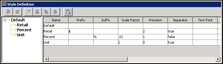

Complete the following steps to create a style.
Navigate: In the Configuration Components pane, select Project and then Styles. The Style Definition window opens in the workspace.
Select or create the Style that will be the parent of the new style. All styles must ultimately be descendents of the Default Style.
From the toolbar, click Create a new style.
Select New Style from the right-click menu.
Press Insert.
If the Style Attributes for Default are populated, all of its descendants will inherit the same attributes unless you specify new attributes for the new styles. A new style will be created with inherited attribute values for all the properties set in its parent style.
The inherited style attribute values are displayed with lighter shade (gray) to differentiate from the un-inherited values (black). Notice that the style attributes for the style Default -are shown in black while the style attributes for the style Percent are in gray.
Change the values of any of the new style's attributes where a different value is required than that which has been inherited. For those attributes that have been overwritten from the ”Default” value will be display in black while those that have not been changed will remain gray to indicate they are inherited.

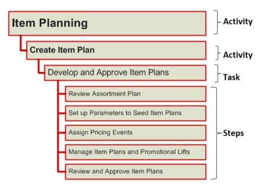

This flexibility is found in the RPASCE Client taskflow. The taskflow allows configurators to more closely describe and model their business practices within the client. Configurators can create taskflow elements (activity groups, activities, tasks, and steps) that can be associated with structural elements of the workbook configuration. These taskflow elements then provide a more intuitive and business practice-oriented view of the structural elements of the RPASCE domain.
The activity group activity/task/step can be organized however the user wants. The task refers to a template and specific solution. Inside a Configuration Tools configuration, they all refer to the same solution. Names are all qualified by the Solution ID, so that they do not conflict later when they are manually combined. A single solution taskflow can have multiple activity groups, and a combined taskflow could conceivably have just one (for example, put all the activities from the various solutions under a single activity group).
When creating an activity, the activity group name, label, and description can be specified. When the domain is built, the activities are combined into an activity group based on the specified activity group properties. Each task is specific to a workbook template and therefore a specific solution.
Figure 3-41 shows the activity, task and steps for Item Planning.

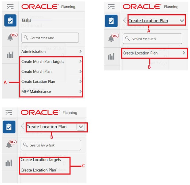

Here is an example of a taskflow in the RPASCE Client.
Figure 3-42 Taskflow within the RPASCE Client Task Module
Figure 3-43 Taskflow Within the RPASCE Client Task Module

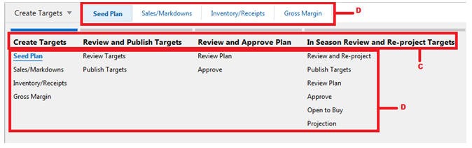

Table 3-2 describes the icons that appear with all the entries in the activity taskflow.
Table 3-2 Taskflow Icon Key for the Taskflow within the RPASCE Client Task Module
| Legend | Icon Name | Description |
A |
Activities |
These tabs represent the predefined activities of the application. |
B |
Tasks |
These are the individual tasks within the selected activity. |
C |
Steps |
These are the steps available in the selected task. |
D |
View Groups (Tabs) |
These are the view groups defined within the selected step. If a step contains configured tabs, each tab is represented by a view group. If a step does not contain configured tabs, a single view group corresponding to the step itself is present. |

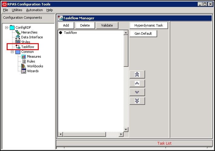

Complete the following steps to create a taskflow.
Navigate: In the Configuration Components pane, select Taskflow within the project for which you want to create a taskflow.
Figure 3-44 Taskflow Icon in the Configuration Components Pane
The Taskflow Manager window opens. The first time that you use the Taskflow Manager, it contains one bullet called Taskflow.

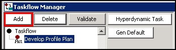

Complete the following steps to add an activity to the taskflow.

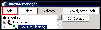

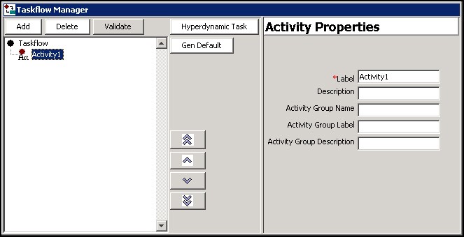

Select the Taskflow bullet inside the navigation pane of the Taskflow Manager. Click Add.
Figure 3-46 Adding an Activity to the Taskflow
An activity called Activity1 displays in the navigation pane. Select Activity1. The Activity Properties displays in the detail pane.
Enter the name of the activity in the Label field. This is the name of the task as it displays in the taskflow of the RPASCE. The red asterisk denotes that this step is required. Note that as you type the name in the Label field, the name is updated in the navigation pane.
[Optional] Enter a description for the activity in the Description field. The description displays when the user rolls the cursor over the activity name in the RPASCE Client.
Enter the activity group name in the Activity Group Name field, group label in the Activity Group Label field, and group description in the Activity Group Description field. This step is optional. Note that the Activity Group Name must not contain any spaces. Otherwise, when the user clicks Validate, error messages will show up in the pop-up validation dialog box.
After you have entered the activity properties, the new activity is created.

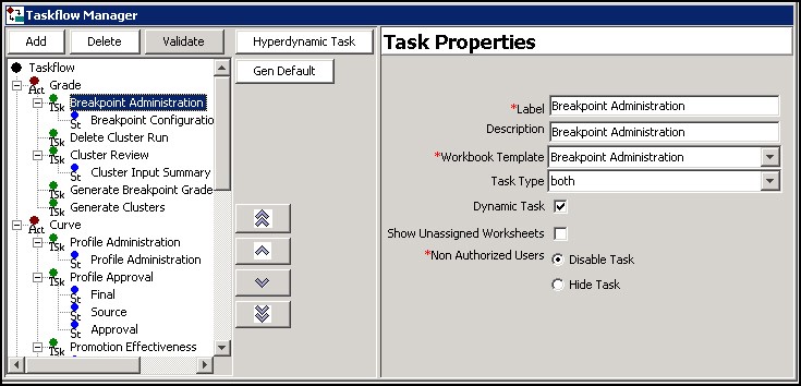

Complete the following steps to add a task to the taskflow.
To create a task within an activity you created, select the activity in the navigation pane and click Add.
Figure 3-49 Adding a Task to an Activity

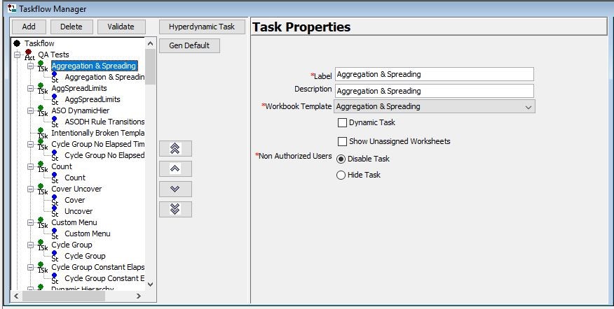

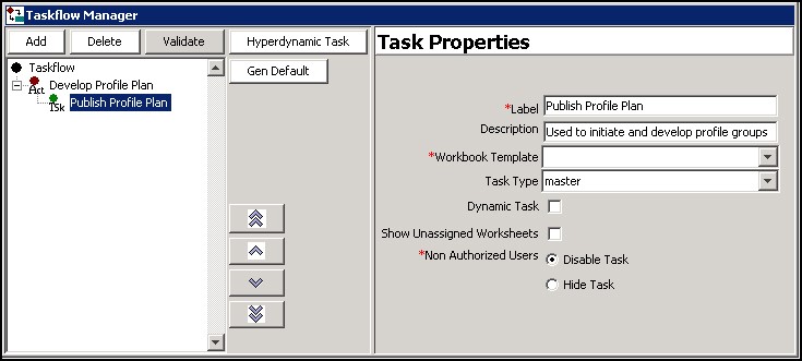

A task called Task1 displays in the navigation pane. Select Task1. The Task Properties display in the details pane.
Enter the following information in the Task Properties.
Label
Enter the name of the task as you want it to appear in the RPASCE Client. This step is required.
Description
Enter the description of the task. This description displays when the user rolls the cursor over the task name in the RPASCE Client.
Workbook Template
Choose the workbook template that will be utilized in this task. This step is required.
Dynamic Task
Select this option if the steps for the task are dynamic based on the user selections made during the workbook wizard. When this option is selected, the user will not see any steps under a task in the RPASCE Client until a workbook is open.
Note: Custom workbook code is still required to provide the ability to filter steps based on the wizard selections |
Show Unassigned Worksheets
By checking the unassigned flag, applications that include the potential for non-configured worksheets can allow those worksheets to be displayed within the RPASCE Client while continuing to maintain the ability to hide worksheets irrelevant to the task at hand for workbooks that do not contain non-configured worksheets.
Non-Authorized Users
Choose whether unauthorized users are able to see the task but are unable to edit it (Disable Task) or are not able to see it at all (Hide Task).
Once you've entered the task properties, the new task is created.

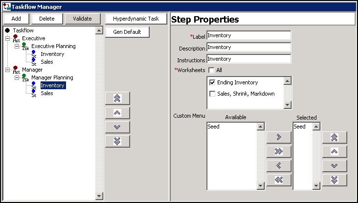

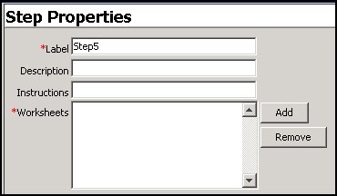

A step called Step1 displays in the navigation pane. Select Step1. The Step Properties display in the details pane.
Enter the following information in the details pane:
Label
Enter the name of the step as you want it to appear in the RPASCE Client. This is required.
Description
Enter the description of the step. This description displays when the user rolls the cursor over the step name in the RPASCE Client.
Worksheets
Select the worksheets that will be utilized in this step. You can select all worksheets to be included by checking the All check box. Or, you can select a subset of worksheets from that workbook template. This is required.
Custom Menu
If you want to include a custom menu in this step, select it in the Available area and then use the arrow to move it to the Selected area. You can change the order of the custom steps by using the up and down arrows.
Once you have entered the step properties, the new step is created.

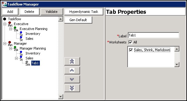

Complete the following steps to add a tab to the taskflow.
To add a tab to a step you created, select the step and click Add.
A tab called Tab1 displays in the navigation pane. Select Tab1. The Tab Properties displays in the details pane.
Enter the following information for the tab:
Label
Enter the name of the tab as you want it to appear in the RPASCE Client. This is required.
Worksheets
Select the worksheets that will be utilized in this tab. You can select all worksheets to be included by checking the All check box. Or, you can select a subset of worksheets. This is required.

Complete the following step to delete items from the taskflow.
To delete any activity, task, step, or tab in the taskflow, select it and click Delete.
Figure 3-56 Deleting Items in the Taskflow
To edit an activity, task, step, or tab that you have already created, select it in the navigation pane. Its properties display in the details pane. Then edit the properties you want.

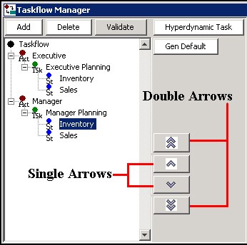

To change the order of activities, tasks, steps, or tabs, select the item that you want to move and use the arrow buttons to the right of the navigation pane. Click a single arrow to move it one level in the list. Click the double arrow to move it to the top or bottom of the list.
Figure 3-57 Ordering Items in the Taskflow

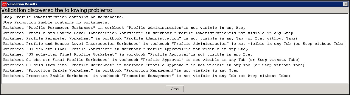

As you create the taskflow, the Task List underneath the Taskflow Manager displays configuration elements that may cause validation errors. In addition, the Validation Results tool shows you if you have configured elements that are unavailable to users. For instance, if a configured taskflow does not have a task associated with a given workbook template, then the RPASCE Client user is not able to build or open any workbooks built from that template.
Note: The presence of validation problems does not prevent you from building a domain. |
To validate your taskflow, click Validate at any time. The Validation Results window opens. The Validation Results tool checks for the following:
Workbook templates that are not associated with a task
Worksheets that are not a part of any step
Custom menu items that are not available in any step
Activity Group names that contain any spaces.
When conditions such as these exist, they display in the Validation Results window. Once you have reviewed the results, you can choose to resolve any issues if necessary.
The RPASCE Configuration Tools also performs validation within the Task List underneath the Taskflow Manager. As you edit within the Taskflow Manager, the Task List reports potential issues and errors within the configuration. For more information, see the Task List section.

To create a hyperdynamic task to an activity, complete the following steps:
Select the activity and click Hyperdynamic Task.
The new hyperdynamic task displays in the navigation pane. Select the new task. The new task properties displays in the detail panel.
Label
Description
Workbook Template
Choose the workbook template to be utilized in this task. This step is required.
Dynamic Task
Select this option if the steps for the task are dynamic based on the user selections made during the workbook wizard. When this option is selected, the user does not see any steps under a task in the RPASCE Client until a workbook is open.
Note: Custom workbook code is still required to provide the ability to filter steps based on the wizard selections. |
Choose Disable Task to allow unauthorized users to see the task but not access it. Choose Hide Task if you do not want unauthorized users to see the task at all.
To add a hyperdynamic step to a hyperdynamic task you have created, complete the following steps:
Select the hyperdynamic task and click Add.
A step named Step1 displays in the navigation pane. Click Step1. The Step Properties display in the details pane.
Enter the following information in the Step Properties:
Label
Description
Instructions
Enter instructions that explain what to do in the step. These instructions display underneath the task pane.
Worksheets
Enter the names of the worksheets that can be visible within the step.
Custom Menu
To add a hyperdynamic tab to a hyperdynamic step you created, complete the following steps:
Select the hyperdynamic step and click Add.
Tab1 displays in the navigation pane. Click Tab1. The Tab Properties displays in the details pane.
Label
Worksheets
After you have entered the tab properties, the new tab is created.

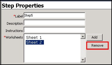

To remove a worksheet from a hyperdynamic step or tab, complete the following steps:
Select the step or tab that contains the worksheet you want to remove. The details of the step or tab display in the detail pane.
Select the worksheet to remove and click Remove.
Figure 3-65 Removing a Worksheet from a Hyperdynamic Step or Tab
The selected worksheet is removed from the step or task.
