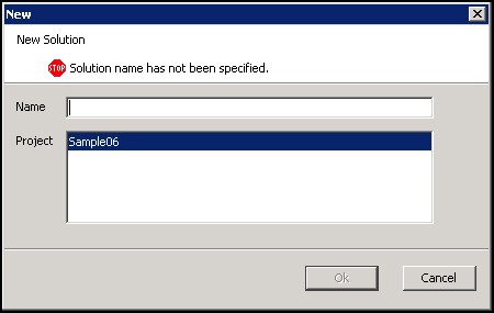

Complete the following steps to create a solution.
Navigate: From the File menu, select New and then Solution. The New Window opens.
In the Name field, enter the name of the solution.
In the Project field, select the project in which the solution is to belong. Multiple projects will be listed if multiple projects are currently open.
Click OK to save any changes and close the window.

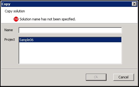

Complete the following steps to copy a solution.
Select the solution to be copied.
Right-click in the Configuration Components pane and click Copy. The Copy solution window opens.
Type the new name for the solution in the text box.
Note: This is the name that the solution is called after it has been copied. |
Select the project where the solution is to be copied.
Click Finish to save the copied solution in the specified project.

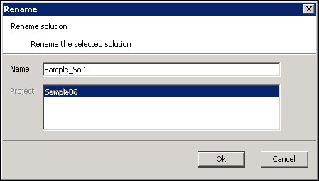

Complete the following steps to rename a solution.
Select the solution to be renamed.
Right-click in the Configuration Components pane and select Rename. The Rename Window opens.
Delete the old name from the resulting field and type the new name.
Click OK to save the new name.

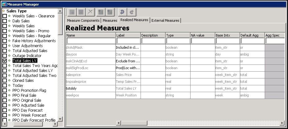

The Measure Manager window allows you to define major and minor components of measures and to specify properties for each component. Once the component structure is defined, the Measure Manager generates measures by combining the components that are selected. You may then select (realize) the valid measures and further update the properties for individual measures.
This section describes the fields displayed in the Measures tab.
Measure properties are inherited at the component level. The properties defined for a component are inherited by the minor components that belong to that component and to the measures that are associated with that component unless it is overridden at a lower level.
When a measure can inherit a property from more than one of the components that construct it, the measure inherits from the component that belongs to the highest major component in the component tree. For many properties, it is a good practice to set the properties for just one major component or for minor components in just one major component branch.
Measure property inheritance can be overridden at the minor component or at the measure level. Once a property is set at a lower level, changes made to that property at a higher level will no longer be inherited at that lower level.
A major component is the highest level in the component inheritance hierarchy. Properties defined at this level are inherited by all minor components that are created under the major component.
Within each major component, you can create one or more minor components. You can also create a minor component under a minor component and also modify properties at the minor component level.
Once major and minor components are defined, the Measure Manager generates measures that are based on the combination of selected components. These measures cannot be used elsewhere in the configuration tools until the valid prototype measures are realized.

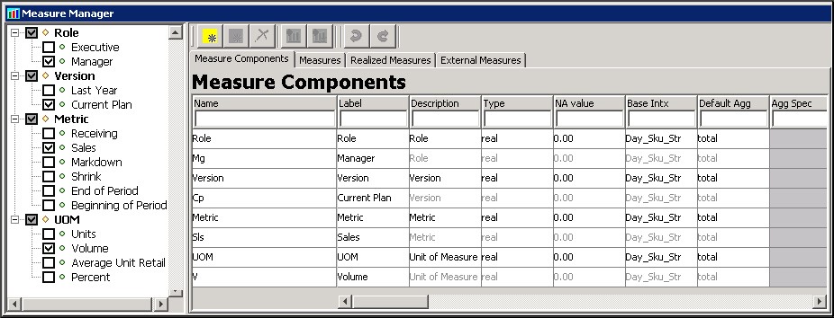

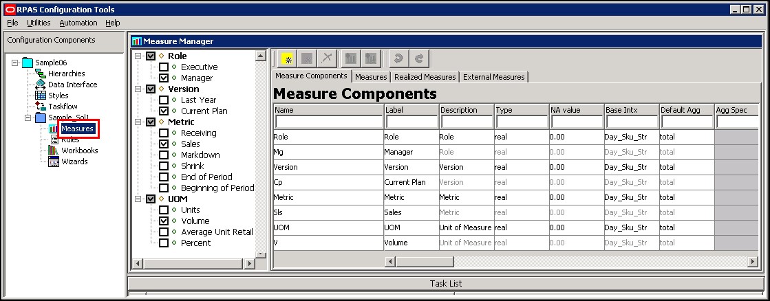

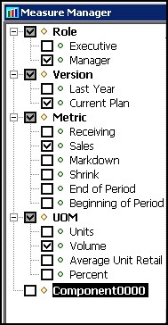

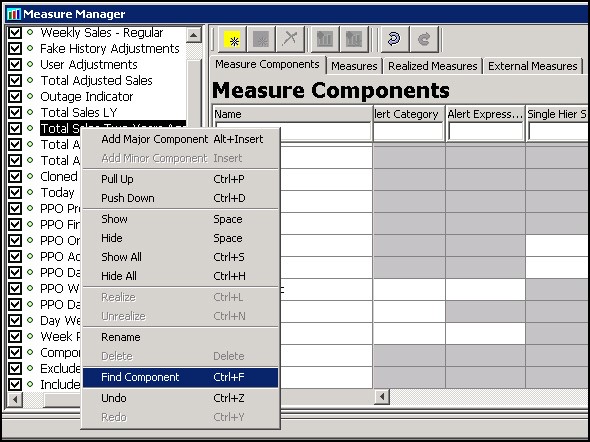

Complete the following steps to create a major component.
Navigate: In the Configuration Components pane, select Project then Solution then, Measures and then the Measure Components tab. The Measure Manager window opens in the workspace.
Figure 4-7 Measure Manager Window - Measure Components Tab
Right-click in the left-hand pane of the Measure Manager window and select Add Major Component or click Add Major Component. The major component displays in the Measure Manager navigation tree with a default name.
Figure 4-8 Measure Manager Navigation Tree
To change the component name, select right-click on the component and select Rename, or select the component from the navigation tree and then modify its Label field from the Measure Components tab.

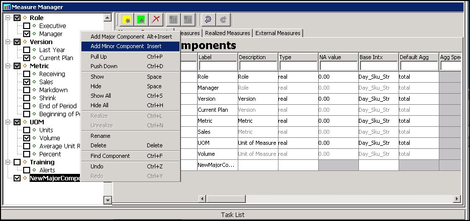

Complete the following steps to create a minor component.
Figure 4-9 Major Measure Component Selected
Select the major or minor component that the new minor component is to be added beneath. In Figure 4-9, NewMajorComponent is selected.
Choose one of the following methods:
Right-click the Measure Definition navigation tree and select Add Minor Component.
Click Add Minor Component.
Press Insert.
The minor component displays in the Measure Manager navigation tree with a default name.
To change the name, right-click on the component from the navigation tree and select Rename. You can also select the component from the navigation tree and modify the Label field from the Measure Components tab.
Complete the following steps to define the Measure Component properties.
Once components have been created, open the Measure Manager and select the Measure Components tab.
Select the major or minor components you want to view from the Measure Manager navigation tree. The selected components display in the Measure Components tab.
Specify the information for the component properties (for example, Name, Label, Description, and so on), which will apply to the measures that are inheriting property values from the component.
Note: The values that are entered for major components are inherited by the child minor components and the auto-generated measures. Not all properties need to be entered for all components. Properties that are grayed out in the component properties table cannot have a value in the current context. Typically, this is based on the data type of the measure. For example, only components of Boolean data type can have an alert category or an alert expression. |

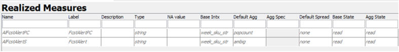

This is a value (typically zero for numeric measures) that is not physically stored but is inferred. It is used to help with storage and calculation efficiency, and it may be changed by RPASCE (in full-evaluation mode) if better efficiencies can be obtained with a different value. See Appendix C, "Appendix – Calculation Engine User Guide" and Appendix D, "Appendix – Rules Function Reference Guide" for more information.
The Base Intersection. The lowest level at which data is stored for a measure. In the domain, the measure is only stored at the base intersection. Inside a workbook (for performance reasons), values for the measure may be stored higher than the base intersection. Nevertheless, whether stored or not, values for aggregated levels may be viewed in a workbook and used in calculations in workbooks or domains. Double-click this field to open the Select Intersection window. The hierarchies that were defined using the Hierarchy tool are displayed. One dimension from each hierarchy can be selected, but a dimension is not required for each hierarchy. Alternatively, a measure may be marked as scalar. A scalar measure has only one value at any combination in the positions of dimensions of the domain. A Labeled Intersection may also be selected as the base intersection of a measure. The Labeled Intersection field is populated based on the Labeled Intersections defined through the Labeled Intersection window accessed in the Hierarchy Definition manager.
Note: RPASCE imposes a limit of five dimensions that can be defined in a measure's base intersection. |
The default aggregation method should be selected from the valid aggregation methods for the component. The valid aggregation method depends on the data Type selected for the component. See Appendix C, "Appendix – Calculation Engine User Guide" and Appendix D, "Appendix – Rules Function Reference Guide" for more information on aggregation and spread methods.
Note: Only measures with an aggregation type of ambig, pst, or pet can be aggregated from lower than the partition levels to higher than the partition levels in a global domain. |

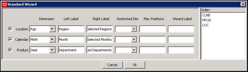

When a measure is specified for hybrid agg, the agg spec (aggregation specification) field becomes editable.
An agg spec can be typed in or built through a window (double-click the agg spec editor or select Ctrl-Space to launch it).
This window looks very similar to the standard wizard for workbooks. On the right, the ordering of hierarchies in the intersection of the measure is set by dragging the hierarchies in the list. On the left, a separate aggregation type is selected for each hierarchy. For the most part, these are the aggregation types that are available for the measure based on its type.
Exceptions are as follows:

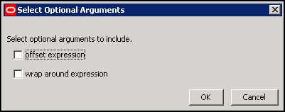

Recalc or hybrid cannot be used within an agg spec.
First and last can be used only on the Calendar hierarchy only.
An aggregation type must be specified for each hierarchy in the intersection.
If a value is to be typed into agg spec, the syntax and meaning is the same as the arguments used by the aggregate function of the rule engine.

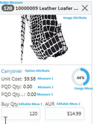

The UI Type property affects how the user interacts with a measure within the client. There are two supported values for UI Type; by default, UI Type is unspecified, meaning that the measure exhibits no special behavior within the client.
Picklist – When a measure is given a UI Type of picklist, it will no longer accept edits within the client. Instead, the user will be provided with a drop-down box that contains a set of valid values. Selecting an item in this drop-down will set the cell of the measure to the appropriate value. For picklist measures, the contents of the drop-down box are determined by the range attribute.
Media – When a measure is given a UI Type of media, the RPASCE Client will not display the values of the measure's cells. Instead, it will examine the contents of a cell to extract image location information, retrieve the appropriate image resource and display that image in the cell. In order for a measure to have a UI Type of media, that measure must be a string type measure.

Navigate: In the Configuration Components pane, select Project, then Solution, and then Measures. The Measure Manager window opens in the workspace.
From the Measure Manager navigation tree, select the component to be moved.
Drag the component to the new location and release it.
Note: A minor component cannot be moved to a different major component.The configuration administrator cannot move a component so that it would be a descendent of another component that is used in the specification of a realized measure. |
From the Measure Manager navigation tree, select the component to be pushed down.
Right-click in the Measure Definition menu and select Push Down.
Note: The component is pushed down one level in the component hierarchy, and a new component is created to take the place of the pushed down component. |
Note: A major component cannot be pushed down. |
From the Measure Manager navigation tree, select the component to be pulled up.
Right-click and select Pull Up. The component is pulled up one level in the component hierarchy.
Note: A minor component cannot be pulled up to become a major component, nor can a major component be pulled up. |
To display information about a component, select the check box next to the component name.
To hide information about a component, clear the check box next to the component name.
Note: Selecting or clearing a check box for a major or minor component causes the check boxes for all minor components underneath it to be selected or cleared. This check box is also used to enable a component so it becomes active when measures are generated. |
Right-click in the Measure Manager navigation tree and select Find Component. The Input window opens.
Type in the name of the desired component and click OK. The tree will scroll to bring the specified component into view.
Select the desired component.
Note: The full name (case sensitive) of the component is required in order to find it. If there is no component with the exact name entered, the tree will not scroll. |
Navigate: From the Measure Manager navigation tree, select the component to be renamed.
Right-click in the Measure Manager navigation tree and select Rename. Type the new name for the component.
Double-click the component and type the new name.
Select and change the name of the component in the Measure Component tab.
Note: Changing the name of a component results in a change in the name of any measure that inherits from the component unless the measure has overridden the name property. |
Navigate: From the Measure Manager navigation tree, select the component to be removed.
Click Remove Component.
Press Delete.
Right-click in the Measure Manager navigation tree and select Delete.
The component is removed from the solution.
Note: It is not possible to remove a component that is used (or that has a descendent component that is used) in the specification of a measure. |

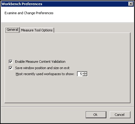

For some cases you may disable the full validation (for instance, when performing a number of changes to measure properties that require switching back and forth between multiple tools). Validation can then be manually initiated from the Rule Definition window by selecting Perform measure content validation from the Rule Definition toolbar. Complete the following procedure to turn off real-time validation.
Select File and then Tools Preferences. The Workbench Preferences window opens.
Figure 4-15 Workbench Preferences – General Tab
Clear the Enable Measure Content Validation check box.
Click OK.
The Measure Manager allows you to create and name measures by selecting major and minor components that are already defined. By default, the measures inherit the properties that are defined for the components. To create a measure, select the components that will be used to construct measures. The Measure Manager will generate measures for all of the combinations of selected components. This saves you from the tedious task of manually creating all required measures.
You may then override the properties for individual measures by entering them the same way as on the Measure Components tab. Once properties are overridden at the measure level, changes made at the component level will no longer spread down to that measure as it will retain the overridden value. An overridden value can also be restored to its inherited value or you may override an inherited value to be unspecified.
When a measure is auto-generated by the Measure Manager, it cannot be edited or used in any other configuration component such as rules and workbooks until it is realized. A measure does not need to be realized if it is not going to be used.
The Measures tab displays all auto-generated measures for the selected components.
Figure 4-17 Measure Manager Measures Tab
The Realized Measures tab only displays those measures that are realized.
Figure 4-18 Measure Manager Realized Measures Tab
Complete the following steps to access the Measure Manager window - Measures Tab.
Select the Measures tab.
Figure 4-19 Measure Manager Measures Tab
In the components tree, select the check boxes for the components that will be filtered. The Measure Manager will show measures using all of the combination of selected components. This process filters the list of prototype measures that are shown from all combinations of components to the combinations of components that have been selected. It uses those components to determine which prototype measures to show.

In the Realized Measures tab, measures can be sorted by property value.
Select the Realized Measures tab.
Hold down the control key (Ctrl) and click in the filter field at the top of the table for the property of the measures to be sorted.
The measures are sorted in alphabetical order according to the value of the property.

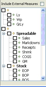

Within the Measure Selectors present in the Rule and Workbook tools and the Expression Builder, there is a check box named Include External Measures. When this check box is selected, the Measure Selector will include those measures that were imported into the solution in addition to those that are present due to component selections in the Measure Selector.
The following properties may be overridden for an external measure:

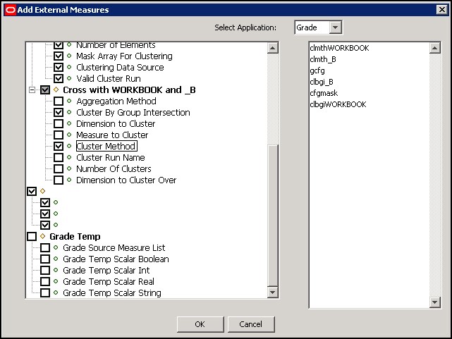

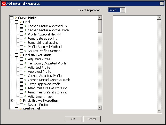

Select the External Measures tab, and click Import Measure on the toolbar. The Add External Measures Window opens.
Figure 4-21 Add External Measures Window
In the Add External Measures window, select the solution in which the desired measure is defined.
Use the measure selector (left-hand side) to select the measures to import.
Figure 4-22 Selecting Measures to Be Imported
External measures that are already imported display in bold.
From the right-hand list, select the measure to import and click OK. The selected measures display in the External Measure tab.

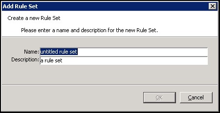

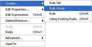

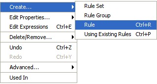

Navigate: In the Configuration Components pane, select Project, then Solution, and then Rules. The Rule Definition window opens in the workspace.
From the toolbar, click New and select Rule Set, or select Create/Rule Set from the right-click menu. The Add Rule Set Window opens.
Complete the following:
In the Name field, enter the name of the rule set.
Note: A rule set name can be a maximum of ten alphanumeric or underscore characters. It must not have a name that is the same as any other rule set that exists in the project. |
In the Description field, enter a description of the rule set.
Click OK to save any changes and close the window. The rule set displays in the Rules navigation tree.

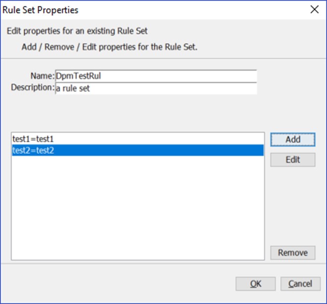

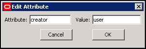

In the Rule Definition window, select the rule set, right click, select Edit Properties, then select Rule Set. The Rule Set Properties Window opens in the workspace.

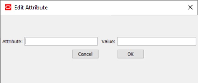

In the Rule Set Properties window, Click Add to open the Edit Attribute window in order to add a new rule set attribute.
Figure 4-26 Rule Set Edit Attribute Window
To edit an existing rule set attribute, select the attribute/value pair and then click Edit. The Edit Attribute window opens in the workspace. The window is pre-populated with the selected rule set attribute and value that the users can edit.
To remove an existing rule set attribute, select the attribute/value pair and then click Remove.

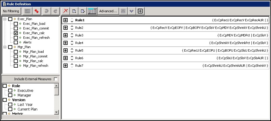

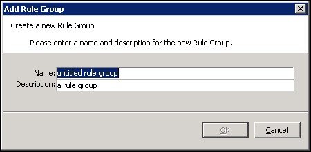

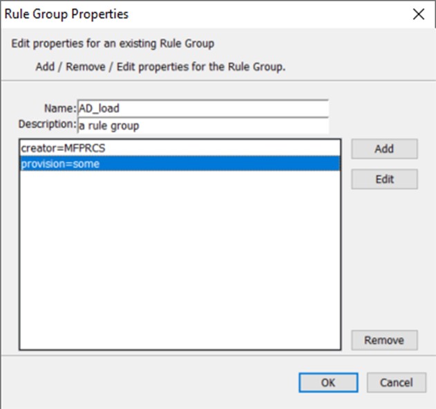

In RPASCE, a rule group is an ordered collection of rules that are treated as a unit by the calculation engine with the integrity of all the rules in the rule group being maintained together.
Rules within a rule group are given a priority. The calculation engine uses this to select a calculation path that follows business priorities. It does this by using rule priorities to determine which rule to enforce when there is a choice to be made. Although there may only be one active rule group at any time, multiple rule groups can be defined to satisfy different calculation requirements.
Types of Rule Groups
Rule groups may be one of four different types:
Load – The RPASCE application automatically uses the load rule group when loading data into a workbook from the domain.
Calculate – The RPASCE application uses a calculate rule group to apply the effects of user changes to cells. RPASCE supports multiple calculation rule groups. Menu options may be configured to allow for the transition through different calculation rule groups in order to support special processes, such as authorizations. RPAS CE ensures a smooth transition from one rule group to another.
Refresh – The RPASCE application uses a refresh rule group to refresh the data from the domain (for example, to update actuals). Multiple refresh rule groups can be specified and selected by the user.
Commit – The RPASCE application automatically uses the commit rule group when committing data from the workbook to the domain.
A measure that does not have data in the domain may be loaded into a workbook by using a rule in the load rule group to calculate it based on other measures that are loaded. Similarly, a measure that exists in a domain, but not a workbook, may be committed by using a rule in the commit rule group that calculates it from other measures that are in the workbook.
Rule Group Validation

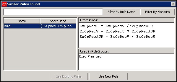

Within a solution, there may be many rules defined, and each rule is validated individually. Rules within a rule group are also validated in the context of all the other rules in that rule group. While a rule may be perfectly valid syntactically, it may not be valid within the context of a particular rule group. In Rule group validation, each rule in a rule group must represent a completely different measure relationship, which means that the following restrictions apply:
No two rules in a rule group may use exactly the same collection of measures. If such a condition were allowed, the calculation engine would be unable to calculate either of the rules, because they would be dependent upon each other, so neither could be calculated first. This is explicitly validated in the rule tool.
For similar reasons, a rule normally does not use a collection of measures that is a subset of the collection of measures in another rule. If the measures that are only in the larger rule were all changed, the situation would be equivalent to the previous one. There are circumstances where this technique is valuable. For example, in a load rule group where there may be a rule to load a measure from the domain, but other rules that include that measure. In this case, this condition is not explicitly validated.
There must be one (and only one) expression that calculates a recalc measure used in a rule group.

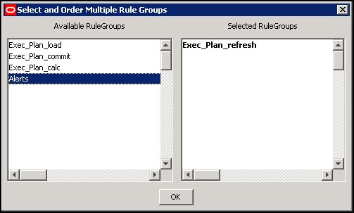

Multiple Refresh Rule Groups
The Refresh Rule Group updates (supplies new values for) data, which can generally be thought of as being external to the workbook. An example would be actuals:
If a workbook is built in week 5, the user would have actuals for weeks 1-4.
In week 6, the user can refresh the actuals to get the actuals for week 5.
The Configuration Tools and RPASCE support the use of multiple refresh rule groups. Within the rule tool, there is the ability to create multiple refresh rule groups within a rule set. These multiple refresh rule groups can then be assigned to a workbook template using the Workbook Designer, and they will be available for selection within the RPASCE Client.
A workbook contains all of the rule groups in a single rule set, so if multiple refresh rule groups are required in a workbook, they must all be in the same rule set.
You may consider naming rule groups so the usage of the refresh rule groups are reflected in their names, such as refresh_all, refresh_actuals, and refresh_manager.

Navigate: In the Configuration Components pane, select Project, then Solution, and then Rules. The Rule Definition Window opens in the workspace.
In the Rule Definition window, select the rule set to be used to create a new rule group.
From the toolbar, click New and select Rule Group, or select Create – Rule Group from the right-click menu.
The Add Rule Group Window opens.
In the Name field, enter the name of the rule group.
Note: A rule group name can be a maximum of 16 alphanumeric or underscore characters. It must not have a name that is the same as any other rule group that exists in the project. |
In the Description field, enter a description of the rule group.
Click OK to save any changes and close the window. The new rule group displays in the Rule Definition tree window.

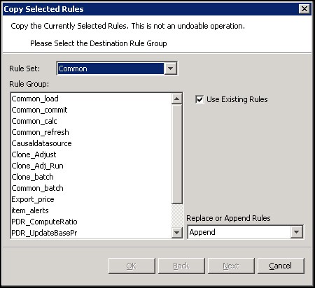

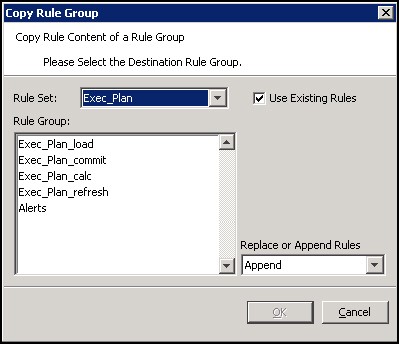

If two rule groups are similar, it may be beneficial to copy one rule group into the other to prevent having to create a rule group from scratch. When copying the rules of a rule group into another rule group, it is possible to specify whether existing rules will be used or copies of the rules will be created. The Use Existing Rules check box defaults to using any existing rules in the rule pool. If this check box is selected, the copy rule group operation will use the same rules that the source rule group has. If this check box is unchecked, the copy rule group operation will create copies of the rules and use those copies for appending to or replacing rules in the destination rule group.
Note: The rule group to be copied into must already exist. A new rule group cannot be created through this process. |
In the Rule Definition window, select the rule group to be copied.
From the toolbar, click Advanced, and select Copy Rule Group. The Copy Rule Group window opens.
Using the Rule Set list, select the destination rule set.
From the Rule Group area, select the desired destination rule group.
Using the Replace or Append Rules list, select either:
Replace – To overwrite all rules that already exist in the destination rule group.
Append – To add to the rules already in the destination rule group.
Click OK. The Confirm Operation window opens.
Click OK. The rules are copied to the selected rule group.
In the Rule Definition window, find the rule set containing the rule group to be modified. Select the rule group, right click, select Edit Properties, then select Rule Group. The Rule Group Properties Window opens in the workspace.
Figure 4-31 Rule Group Properties Window
In the Rule Group Properties window, click Add to open the Edit Attribute window in order to add a new rule group attribute.
Figure 4-32 Rule Group Edit Attribute Window
To edit an existing rule group attribute, select the attribute/value pair and then click Edit. The Edit Attribute window opens in the workspace. The window is pre-populated with the selected rule group attribute and value that the user can edit.
To remove an existing rule group attribute, select the attribute/value pair and then click Remove.
If Enable Measure Content Validation is not selected in the Workbench Preferences window, measure content validation is turned off in the Measure Manager. Measure validation must be manually initiated in the rule tool. See Measure Validation within the Measure Manager.
From the Rule Definition window, click Perform Measure Content Validation on the Rule Definition toolbar.
The Rule Definition tool allows the configuration administrator to define, organize, and manage rule sets, rule groups, and rules. It also allows for the creation of expressions and addition of expressions to rules.
Rules are groups of expressions that describe the relationship between measures.
When a rule has multiple expressions, those expressions are given a priority sequence to help the calculation engine select a calculation path that follows business priorities. When given a choice, the calculation engine will always select the highest priority expression in the rule that is available to be selected. Considerable care should be taken in the design of rules to ensure that appropriate expression priorities are established. The business priority may vary from implementation to implementation, and it may vary from one type of plan to another in the same implementation.
Rules are also given a priority sequence within a rule group to help the calculation engine select a calculation path that follows business priorities. When given a choice, the calculation engine will always select the highest priority rule that needs to be calculated.
Those who are configuring the calculation requirements of a solution are expected to fully understand the operation of the RPASCE calculation engine.

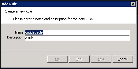

Complete the following steps to create a rule and add it to a Rule Group.
In the Rule Definition window, select the rule group in which you want to create a rule. If you want the rule to be created in a particular position in the sequence of rules in the rule group, select the rule before which you want the new rule to be placed. The new rule will be created higher than the selected rule.
From the toolbar, click New and select Rule.
Click Create..., then Rule from the right-click menu.
Press Ctrl+R.
The Add Rule Window opens.
In the Name field, enter the name of the rule.
Note: A rule name can be a maximum of 24 alphanumeric or underscore characters. It must not have a name that is the same as any other rule that exists in the project. Rule names may start with a letter or an underscore but may not start with the letter r or R followed by a number. |
In the Description field, enter a description of the rule.
Click Next. The Expression Builder window of the Add Rule window opens.

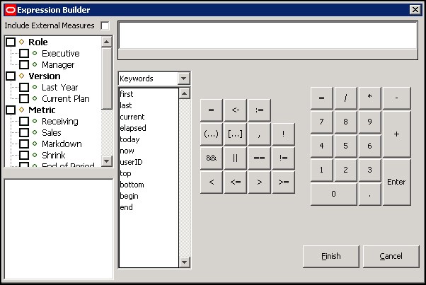

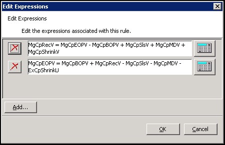

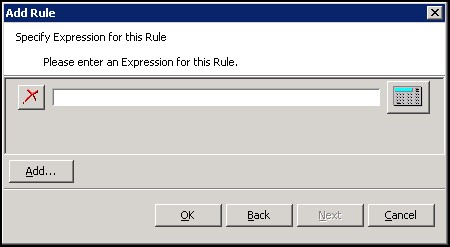

Figure 4-35 Specify Expression for Add Rule

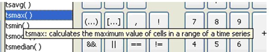

Type the expression in the input box or complete the following to use the Expression Builder.
Click Expression Builder (located to the right of the text box). The Expression Builder window opens.
In the upper left-hand pane, select the measure components to filter measures to be visible for pasting into the expression. If External Measures are required in the expression, check the Include External Measures check box. Realized measures meeting the filtering conditions are displayed in the lower left-hand pane.
Figure 4-37 Include External Measures Check Box
In the lower left-hand pane, double-click any measures to be used in the expression to get the measure name pasted at the insertion point in the expression.
Note: Place the mouse over the name of a function, procedure, keyword, or modifier to see a tooltip that explains its function. |
From the drop-down list, select a category of functions, procedures, keywords, or modifiers. Double-click on a specific function, procedure, keyword, or modifier to be used in the expression, and (if appropriate) outline syntax pasted at the insertion point in the expression.
The outline syntax of a function, procedure, keyword, or modifier is pasted with components of the syntax separated with braces {}. When the insertion point is in a component of the outline syntax in the expression, you will see a description of the component at the bottom of the expression window. When the insertion point is in a component of the outline syntax, anything that is entered or pasted replaces the whole component.
If the function, procedure, keyword, or modifier that is pasted has optional arguments (for example, the cover function has optional arguments for an offset expression and a wrap-around expression), you will be presented with the following window to select which of the optional arguments to use in the expression. Note that all arguments are positional, so if a later argument is selected, all earlier arguments will be automatically selected. If an earlier argument is cleared, then all later arguments are automatically cleared.
Figure 4-42 Select Optional Arguments Window
If the function, procedure, keyword, or modifier that is pasted has repeating arguments (for example the min function finds the minimum of a variable number of expressions), a window opens to select how many of the repeating arguments to use in the expression.
Use the keyboard or buttons to add the appropriate mathematical operators and constants to construct the expression.
When you have defined the expression as needed, click Finish and close the window.
Note: If an invalid expression is created, a warning message is displayed. |
To add further expressions to the rule, click Add, and repeat the process of entering an expression.
If the newly defined rule's expressions use exactly the same measures as another rule that already exists in the Rule Pool, the Similar Rules Found Window opens. The window shows all rules that use exactly the same measures as the newly defined rule. This provides you with an opportunity to use an existing rule from the Rule Pool or to continue with the new rule. The Similar Rules Found window allows you to view rules, associated expressions, and rule groups that contain the rules. The rule table may be filtered based on the rule name or by measure. Click Use Existing Rule or Use New Rule to save changes and close the window.
The new rule is placed preceding the rule that was selected at the start of the process in the sequence of rules in the rule group or at the end of the rule group if no rule was selected.
Note: If Use Existing Rule or Use New Rule is not selected and the window is closed manually, a new rule is created. |

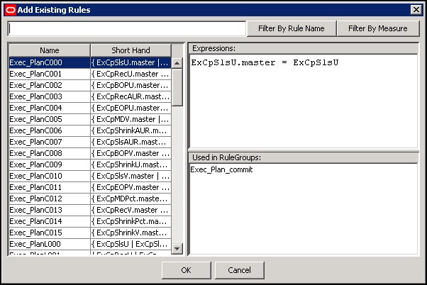

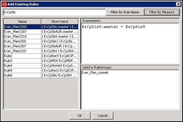

Using the Add Existing Rules window, you may select multiple rules to add to a rule group. If at least one of the selected rules is already in the rule group, the OK button will gray out disallowing the operation until that rule is cleared. When multiple rules are selected, the expression and rule group displays will go blank. However, if there is only one selected rule, the rule's expressions and the list of rule groups that use the rule will be displayed.
In the Rule Definition window, select the rule group to be used to add an existing rule. If the rule is to be placed in a particular position in the sequence of rules in the rule group, select the rule in which the new rule is to precede.
From the toolbar, click New and select Using Existing Rule.
Select Create – Using Existing Rule from the right-click menu.
Press Ctrl+P.
The Add Existing Rule Window opens.
Filter by Rule Name or by Measure and view the associated expressions to find the correct rule. Filtering means that all data are compared, but only matching data is allowed to pass through. In order to filter by Rule Name or by Measure, type a filter string (for instance, ExCpSls in the input box directly under the Title Bar. Click Filter by Measure, and only those measures with ExCpSls display.
Click the rule in the table to select it.
Click OK to save changes and close the window.
The rule is placed higher than the rule that was selected at the start of the process in the sequence of rules in the rule group or at the end of the rule group if no rule was selected.

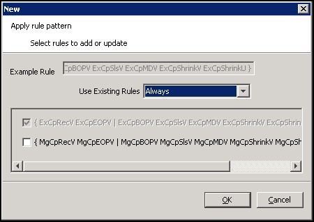

The Apply Rule Pattern functionality allows you to create new rules or update existing rules according to a pattern established by a selected base or template rule. The rule tool recognizes inherent similarities or patterns in measure components used in some rules when compared to the base or template rule. Based on these similarities, the rule tool allows for the creation of new rules or update of existing rules to fit the pattern set by the base or template rule.
When the Apply Pattern capability is enabled, there is a possibility that some of the New or Updated rules will have the same expressions as a rule that already exists in the rule pool. If this happens, the Similar Rules Found window opens and provides the option of using the existing rule or actually creating a new one.
In the Rule Definition window, select any rule group that contains the rule to use as the pattern basis.
Select the rule whose pattern is to be used as a basis for creating or updating rules.
From the toolbar, click Advanced and then select Apply Pattern, or right-click and select Advanced and then, Apply Pattern.
A New Apply Rule Pattern Window opens containing a set of rules that are presented for selection. This set is composed of rules whose measures follow the selected rule's pattern in terms of the individual measure components used. The set of rules are composed of potential new rules or potential updated rules.
Figure 4-46 New Apply Rule Pattern Window
Example:
Consider a configuration with three components in the measure naming scheme:
a version (such as Wp)
a metric (such as Shrink)
a unit of measure (such as V)
If the selected base rule is:
{ WpShrinkU WpShrinkAUR | WpShrinkV }
...then the rules:
Rule1: { WpSlsU WpSlsV WpSlsAUR | }
...and
Rule2: { WpRecU WpRecV WpRecC | }
...would fit the pattern and be included in the list.
Rule1 fits the pattern because its measures use the same measure components with the exception of the metric component. For the Metric component, the base rule uses Shrink, and Rule1 uses Sls consistently. In this case, the tool will present the rule:
{ WpSlsU WpSlsAUR | WpSlsV }
...as a possible update for Rule1.
The update results in the conversion of Rule1 to a rule that uses the same measures as the original Rule1, but it has the expression pattern of the base rule.
Rule2 fits the pattern because it uses the same Version as the base rule. For the Metric component, the base rule uses Shrink, and Rule2 uses Rec consistently. Unlike Rule1, Rule2 uses C as the Unit of Measure in one of its measures. This is not an exact fit like Rule1. In this case, the tool will present the rule { WpRecU WpRecAUR | WpRecV } as a possible new rule. Notice that this rule is forced to be an exact fit as Rule1 was.
Select the rule replacement policy in the Use Existing Rules drop-down menu. This allows the user to select, on a rule-by-rule basis, which rules to reuse and which to re-create. By default, this is set to Always.
When Always is selected, rules that already exist elsewhere in the configuration will always be used in place of the newly generated rules.
When Never is selected, new rules will always be created, even if an identical rule already exists elsewhere in the configuration.
When Prompt is selected, the Rule Locator window will be presented for each rule whose expressions already exist elsewhere in the configuration.
From the list of possible new and updated rules, select those to be updated or added to the rule group. In either case, if rule reuse is specified in Step 4, a new rule will not be created, but the rule existing elsewhere in the configuration will be used in its place.
Click OK.
A selected rule that is labeled New Rule will be added to the end of the rule group. The new rule's name will default to the template rule's name suffixed with a number to keep the name unique. A selected rule that is labeled Update Rule is already in the rule group and will be replaced. This means that the old rule will be removed and replaced with a new rule whose expressions follow the base rule's expression pattern. In both cases, the rule will follow the pattern of the base rule's expression.

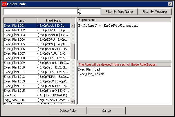

This procedure deletes the rule from all rule groups that contain this rule as well as from the Rule Pool. If the desired action is to remove the rule from a rule group, but to retain it in other rule groups, follow Remove a Rule from a Rule Group.
In the Rule Definition window, select any rule group that contains the rule to be deleted.
Select the rule to be deleted.
Note: If multiple rules are selected, only the last selected rule is deleted. |
From the toolbar, click Delete and select Delete Rule, or select Delete, then Remove, and then Delete Rule from the right-click menu. The Delete Rule Window opens.
Verify that the rule selected in the table is the rule to be deleted or click to select a different rule in the table.
Click Delete Rule to delete the rule and close the window.

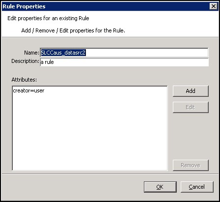

Complete the following steps to edit the properties of a rule.
In the Rule Definition window, select any rule group that contains the rule to edit.
From the rule group, select the rule to edit.
From the toolbar, click Edit and then Select Rule, or select Edit Properties..., then Rule from the right-click menu. The Rule Properties Window opens.
To edit the name of the rule, enter a new name in the Name field.
To edit the description of the rule, enter a new description in the Description field.
To edit attributes for a rule:
Select the attribute to edit.
Click Edit. The Edit Attribute Window opens.
Update the information as necessary.
To remove attributes from a rule:
Select the attribute to delete.
Click Remove. The attribute is removed from the display box.

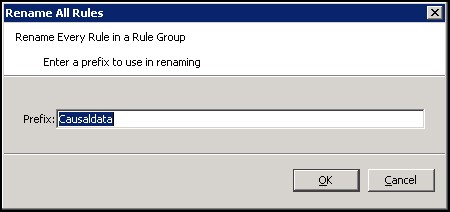

Complete the following steps to rename all rules in a Rule Group.
In the Rule Definition window, select the rule group that contains the rules to rename.
From the toolbar, click Advanced and select Rename All Rules, or select Advanced – Rename All Rules from the right-click menu. The Rename All Rules window opens.
In the Prefix field, enter a prefix up to ten characters in length, which is the start of all rule names.
Click OK. The Confirm Operations window opens.
Click Yes.
Note: All of the rules in the rule group are renamed with the prefix followed by a 4-digit numeric identifier generated by the rule tool. The rule tool will maintain the order that the rules were in before they were renamed, and it uses that order in generating the numeric identifier. |
Note: Since rules may appear in more than one rule group, use of this feature may generate rule names that look out of place in other rule groups, especially if the prefix implies the rule group. |

In the Rule Definition window, click Rule Filtering.
Figure 4-52 No Filtering Button in Rule Definition Window
Note: This is a dynamic button, and the text changes depending on the current filter mode. |
Select one of the following options:
Disable Filtering – All rules display.
Filter by Measure – Works in conjunction with the measure components box in the bottom left corner of the screen. Rules are filtered to show those whose measures conform to the selected component scheme.
Filter by Size – Rules are filtered to show those with more than one expression.
Filter by Validity – Only invalid rules display.
Note: When rule filtering is active, the buttons used to reorder rules in the rule group are unavailable. |

The Similar Rules Found Window opens.
Replace the rules.
Using the Similar Rules Found Window, you can replace a portion of the rules (for instance a prefix) either for all instances of the rules or only for the new instances (where the old instances are not affected).
Example:
Suppose you create a series of rules for the Executive (Ex) Calc Rule Group and you want to use these as a model for the Manager (Mg) Calc Rule Group. Each of these original rules contains expressions with the Ex prefix. Each such instance needs to be replaced with Mg.
Click Use Existing Rules to replace every instance of Ex.
Click Use New Rule to replace the new instances of Ex without affecting the previous rules that contain Ex.

Complete the following steps to edit an expression in a Rule.
In the Rule Definition Window, select the rule whose expression is to be edited.
From the toolbar, click Expression Builder.
Select Edit Expressions from the right-click menu.
Press Ctrl+E.
The Edit Expressions Window opens.
Choose one of the following methods to edit an expression:
Edit the expression in its text box.
Click Expression Builder for the expression to edit. The Expression Builder Window opens. Use the Expression Builder to make necessary changes and click Finish when complete.
Click OK to save the changes and close the window.

Complete the following steps to add an expression to a Rule.
In the Rule Definition window, select the rule that will have an expression added.
Press Ctrl+E.
Click Add to add a new expression in the Edit Expressions window.
Enter the expression in its text box.
Use the Expression Builder to define the rule and click Finish when complete.
Click OK to add the expression.

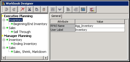

A workbook is an easily viewed, easily manipulated multidimensional framework that is used for interactive business functions in the configured solution. To present data, a workbook can contain any number of multidimensional spreadsheets, called worksheets, as well as graphical charts and related reports. All these components work together to allow you to view and analyze business functions.
The Workbook Designer allows for the creation selection, and integration of the various components of a workbook template, which is a pre-designed workbook that is formatted for RPAS CE users to view and manipulate data. It contains workbook tabs, worksheets, rule groups, wizards, and workflow processes.
Take the time to design a well-planned workbook. Workbooks must be laid out in a logical format and must be easy to navigate. When configuring a workbook, think about how the workbook will be used by the users in the RPASCE Client. Understand the business process flow and what end users will need to access most. Most likely, this information must be contained in the first workbook tab and worksheet.
The names of all of the workbook components must be intuitive to an end user.
Note: The internal RPASCE names need to be unique across all workbook components in a project. This includes workbook, tab, worksheet, wizard, and custom menu names. |
The following sections describe components found in workbooks:
A workbook tab is a major subdivision of a workbook. Each workbook contains at least one workbook tab by default, but additional tabs can be added for organizing workbooks to support business needs. The workbook designer allows you to define and name tabs and to specify their order in the workbook.
Worksheets are multidimensional spreadsheets that are used to display workbook-specific information. Workbooks can include one or many worksheets. Worksheets can present data in the form of numbers in a grid, or the numeric data values can be converted to a graphical chart.

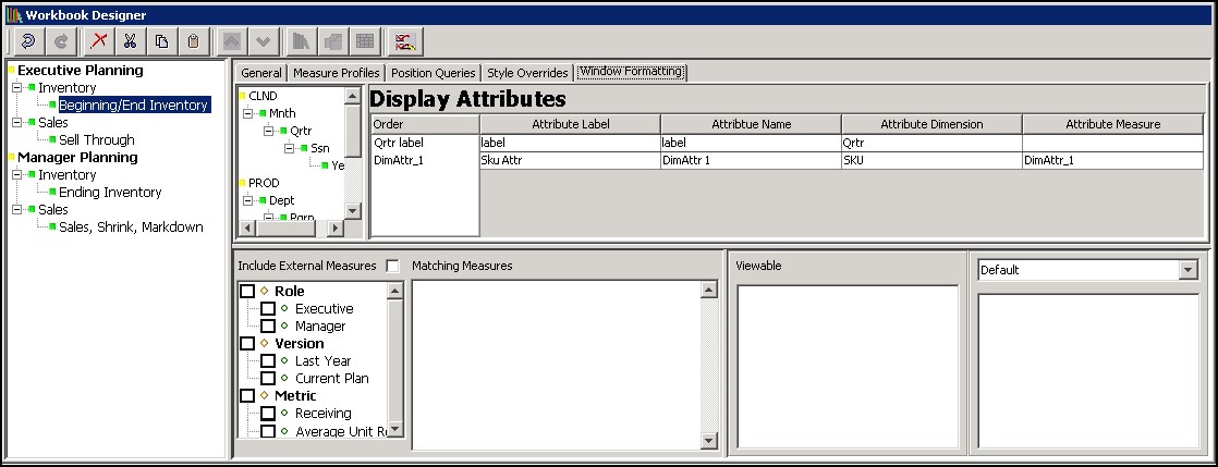

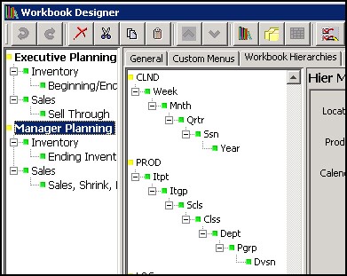

The Workbook Designer provides a visual represent of your workbooks, workbook tabs, and worksheets.
The Workbook Designer contains the following areas:
Workbook Tree - The workbook tree provides a visual representation of the workbooks, workbook tabs, and worksheets. In the example provided, Executive Planning and Manager Planning are workbooks. Inventory and Sales are workbook tabs. Beginning/Ending Inventory and Sell Through are worksheets, which are contained in the Inventory and Sales workbook tabs.
Workbook Toolbar - This toolbar is used to complete common tasks. The buttons available depend on the item selected in the Workbook Designer window.
Workbook Tabs - The workbook tabs are used to define property at the workbook level. The tabs displayed depend on whether a workbook, workbook tab, or worksheet is selected from the Workbook tree. In Figure 4-61, Executive Planning (a workbook) is selected. The seven workbook tabs displayed are available to define specific properties for your workbook. For information on these tabs, refer to Workbook Tabs.

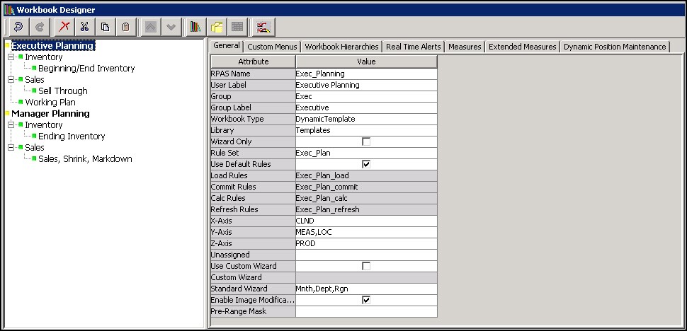

Complete the following steps to create a workbook.
Navigate: In the Configuration Components pane, select Project, then Solution, and then Workbooks. The Workbook Designer Window opens in the workspace.
From the Workbook Designer toolbar, click New Workbook.
Right-click in the Workbook tree area and select New Workbook.
Select an existing workbook and press Insert.
A new workbook is created.

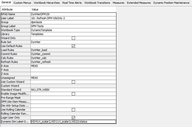

Enter information for the tabs displayed across the top of the Workbook Designer window as necessary. Refer to Defining Workbook Properties for more information.
Note: Double-click on the fields in the Value column to enter the information. |

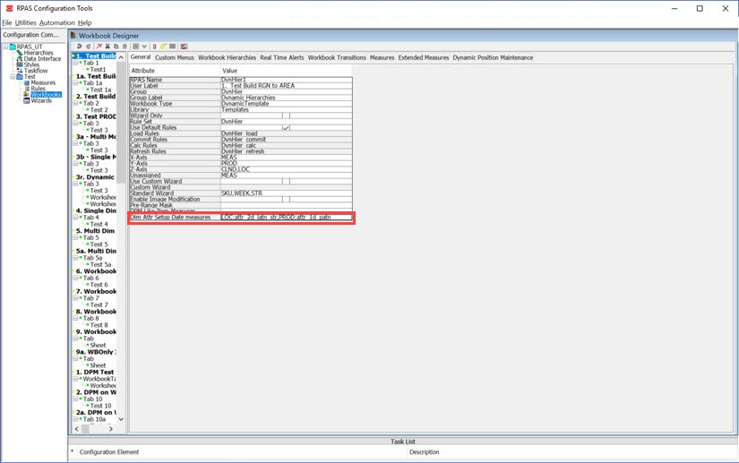

RPASCE can receive new positions and attributes from other systems via scheduled batch jobs and sometimes on demand. The domain patching process incorporates this new information into existing domains, but not for existing workbooks. Existing workbooks must usually be re-built to pick up the new information, but if the existing workbooks have uncommitted data, that data will be lost.
One way to alleviate the problem is to patch the dimension attributes within existing workbooks from the RPASCE client. To do this, the user must pre-configure the workbook via the Dim Attr Setup Date Measures property in the General tab of the Workbook Design Window. For more information about this property, see the Defining Workbook Properties. Note that this approach only enables patching the defined two-dimensional attributes within the workbook.
Complete the following steps to edit workbook properties.
Select the workbook and click on the tab to edit. For information on these tabs, see Defining Workbook Properties.
Update the information as appropriate.

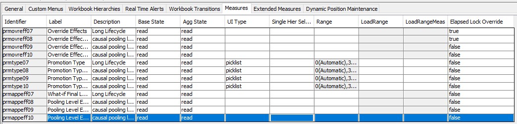

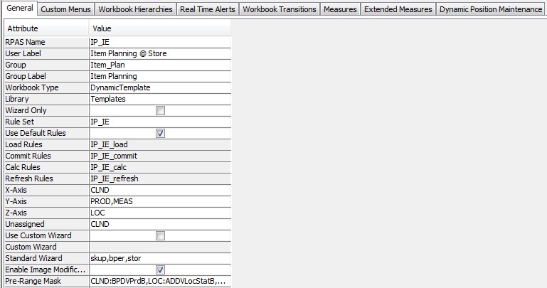

When a workbook is selected from the Workbook Designer window, the following tabs display in the workspace:
Refer to these topics for information on using these tabs to define the workbook properties.

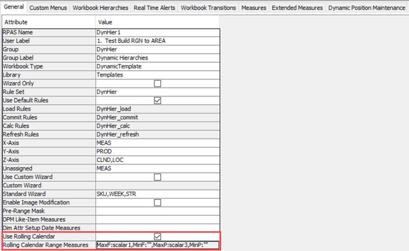

This section describes the default fields that display on the General tab.
In the RPASCE Client, workbooks are grouped together under tabs (workbook template groups) to make it easier for the end user to find and select the needed workbook when solutions have multiple workbooks. This is the internal RPAS name of the group that this workbook belongs to.
In the RPASCE Client, workbooks are grouped together under tabs (workbook template groups) to make it easier for the end user to find and select the needed workbook when solutions have multiple workbooks. This is the label the end user sees of the group to which this workbook belongs to. If different labels are entered for the same workbook group against different workbooks, the workbook group label shown to the end user will effectively be arbitrary.
This property is reserved for use when custom extensions are written. It enables the custom extension to determine the type of the template where the template type has a meaning defined by the custom extension writer. When there is no custom extension, this field is set to the value DynamicTemplate by default.
When the Workbook Type is not DynamicTemplate, it needs to be associated with a relevant custom shared library. This field holds the name of that library. When there are no custom extensions, this field is set to Template by default. The name entered here needs to be consistent with the custom extension. For example, if a value of ABCTemplate is entered in this field, the custom library needs to be named ABCTemplateLib and the directory where the custom extension looks for configuration files in the domain will be repos/ABCTemplates.
The Wizard Only option is only used under circumstances when custom code is to be executed in a batch job at the end of the wizard process (which typically uses custom wizards) instead of building and opening a standard workbook. The selections made in the wizards are passed to the custom code. Therefore, a workbook with the Wizard Only option selected is not a workbook. However, the workbook infrastructure is used so that the process can have a name and label and be assigned to a workbook group. This allows end users to select a Wizard Only template using the same process as workbooks. Workbooks that have the Wizard Only option selected do not need tabs or worksheets defined, but they do need a name, label, and workbook group.
Selects the rule set to use with the workbook. The list of rule sets to select from includes all the rule sets in the same solution as the workbook template.
Select this option to use the default rules (Load, Commit, Calc, and Refresh) associated with the rule set. If this option is selected, the Load Rules, Commit Rules, Calc Rules, and Refresh Rules properties are unavailable. If the option is not selected, the Load Rules, Commit Rules, Calc Rules, and Refresh Rules properties are enabled.
Select the rule group to apply for each rule group type. Only rule groups from the selected rule set are offered.
When the Use Default Rules option is not checked, Refresh Rules is enabled. Select the rule groups to use as refresh rule groups. When enabled, click in the Refresh Rules field. The Select and Order Multiple Rule Groups Window opens.
Figure 4-64 Select and Order Multiple Rule Groups Window
Use this window to specify which groups are available and used to refresh the workbook.
Partial data in a workbook can be refreshed by refreshing with a rule group that only updates some of the measures in the workbook. The order that the rule groups appear is the order in which they display to the end user when presented with a choice of refresh rule groups within the workbook.
In the Available Rule Groups column, select the rule group to add, and drag it to the Selected Rule Groups column.
These properties are used to define the default axis layout of the worksheets in the workbook (that is, which hierarchies appear in each axis). Before the hierarchies appear in the Axis window, you must make sure that the database and base intersection have been assigned from the Measure Manager.
The measures must also be made viewable.
To make measures viewable, right-click in Default and select Add Matching.
Click in the X-Axis, Y-Axis, Z-Axis, or Unassigned field. The Axis Window opens.
Drag the hierarchies to the appropriate axis column.
Note: The hierarchies that appear in this process are the hierarchies used by measures placed on worksheets in the workbook. If no worksheets have yet been built, then no hierarchies appear in this process. |
This determines the type of wizard to use for the workbook template. Select the check box to enable the Custom Wizard property and disable the Standard Wizard Property. Clear the check box to disable the Custom Wizard property and enable the Standard Wizard Property. See Wizards for more information on Custom Wizards.
Select the custom wizard that to use to build the workbook. This field is only enabled when the Use Custom Wizard check box is selected. This field allows you to select a wizard from a list of wizards created in the Wizard Designer.
Select the dimensions to be selected by the end-user in the standard wizard, which presents a series of two tree selection panes to select the positions in the scope of the workbook to be built.
Click in the Standard Wizard field. The Standard Wizard Window opens.
Note: Hierarchies used in the lowest base intersection for the measures used in the rule set assigned to the workbook will be displayed. For each hierarchy, there will be a choice of dimensions. The dimensions offered will be the lowest dimension in that hierarchy that is used in the base intersection of a measure in the rule set assigned to the workbook, plus all higher dimensions.For a hierarchy in the workbook for which a wizard is not available, all the positions in the domain will be pulled into the workbook. If position level security has been applied to the user, a subset of the position will be pulled in. |
Select the check boxes next to the hierarchy names to enable the hierarchies for which that the end user in the RPASCE Client should select positions.
Dimension: Select the desired dimension from each of the enabled hierarchies.
Note: The dimension selected is the lowest dimension offered to the end-user in the scope selection wizard during the workbook build process. However, the workbook requires positions at the lowest dimension offered. Therefore, if the selected dimension is higher than the lowest dimension offered, the scope of the workbook includes all of the positions in that lowest dimension that are descended from the positions selected from that higher dimension. |
Left Label and Right Label: (Optional) Enter the left and right labels for each hierarchy. These labels will be displayed on the left and right trees of the corresponding 2-tree wizards during the workbook build process. If these fields are left blank, no labels will be displayed over the hierarchy trees.
Restricted Dim and Max Positions: For applications such as pricing, a retailer might want to restrict the selection of SKUs in a planning workbook to only one category. A planner may be allowed to plan several categories within a department, but only one category per plan. Per the retailer's business process, a category would establish a coherent set of SKUs, the cross-item effects of which could be considered meaningful for a price optimization algorithm. Mixing in SKUs from two or more categories could be considered as polluting the cross-item effects, and therefore an undesirable situation. What may also be required for this application is the ability to select SKUs or Classes that comprise a subset of possible SKUs or Classes within the Category, but not the whole category.
With this latter requirement, a single-select wizard at the category level would not allow the user to filter subsets of SKUs or Classes. What is required is the ability to make multiple selections at the SKU or Class levels in a standard RPASCE Two Tree selection wizard, while still ensuring that only one Category is used. Even though this can be achieved through the disciplined selection of SKUs and Classes in a Two Tree Wizard, RPASCE allows for setting up a hard constraint so that the wizard itself can keep the user from selecting subsets in more than one Category by displaying an error message and preventing the user from proceeding to the next wizard page until the constraint has been satisfied.
The constraint can be easily established within the Standard Wizard definition window in the Workbook Definition tool of the Configuration Tools. Two new fields are available for every Two Tree selection page in the standard wizard, one where the user selects the level from the hierarchy (Restricted Dim field), and another where the user enters the maximum number of selectable positions from that level (Max Positions field). These fields are optional, and if left empty, there is no limit on the number of positions that may be selected using the wizard. These fields are also available for Two Tree pages used in custom wizards.
