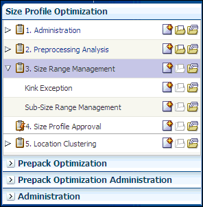

The Size Range Management workbook is used to set the kink inner neighboring ratio, the kink outer neighboring ratio, and the expected kink sizes.
The Size Range Management task contains the following steps:

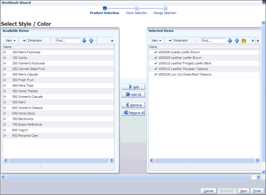

The workbook wizard opens at the Select Style/Color screen. Select the style/color you would like to examine, and click Next.

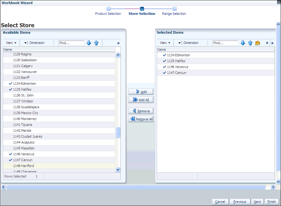

The stores are displayed on the Select Store workbook wizard. Choose the locations, and click Next.

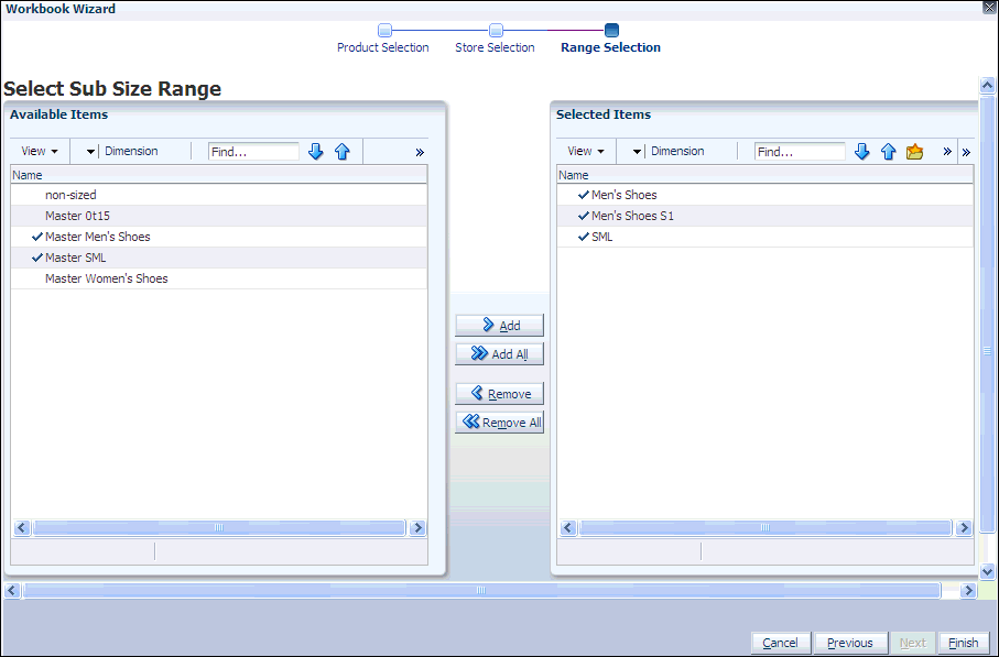

The workbook wizard opens at the Select Sub Size Range step. Select the size ranges you would like to examine, and click Finish.
The Size Range Management workbook is built.

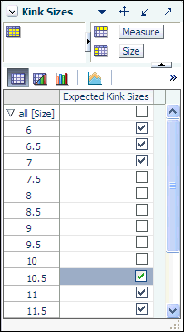

The Kink Sizes view contains a Boolean measure called Expected Kink Sizes, which indicates whether or not a size is odd. The intersection for this view is at the size level.
The following table describes the measures available on this view.

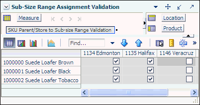

The Sub-Size Range Assignment Validation view is used to display the stores for which valid size ranges are available. This view is used to ensure that each of the stores is mapped to one of the available sub-size ranges.
