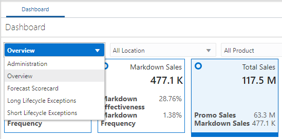

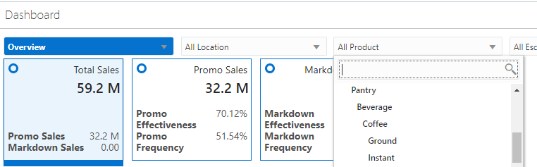

Figure 4-1 shows the RDF Dashboard as seen in the UI. It consists of two Metric profiles and two Exception profiles.
Note that the Exception profiles consist of Exception Tiles, and the Metric Profile consists of metric tiles of the type Comparison Tile. Currently RDF does not support the Variance Metric tile.
In Figure 4-1,the Overview Metric profile is selected and the Total Sales tile is highlighted with two sub-measures: Promo Sales and Markdown Sales.
The RDF GA Dashboard workbook is built at the Sub-class, District level which is controlled by the Dashboard Intersection specified in the Common plug-in. Refer to "Set Up Common Configuration Details." The Dashboard intersection also defines the level to which we can drill down the Product and Location filters in the Dashboard.
