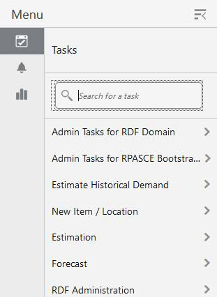

To build the New Item Maintenance workspace, perform these steps:
From the left sidebar menu, click the Task Module to view the available tasks.
Click the New Item/Location activity to access the available workspaces.
Click New Item Maintenance. The New Item Maintenance wizard opens.

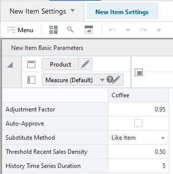

This step contains the New Item Basic Parameters View.
The New Item Basic Parameters view allows you to set default values for some parameters related to the New Item functionality.
The New Item Basic Parameters view contains the following measures:
Adjustment Factor
The only demand component needed to generate forecast for New Items is base demand. If the Like Item substitution method is selected, the adjustment factor specifies what percent of a Like Item's base demand will be copied to the New Item.
Auto-approve
You decide if automatic Like Item recommendations are automatically approved by selecting this measure. If the automatic Like Item recommendations are not automatically approved, the system suggested Like Items are still displayed, but not used in forecast generation.
Substitute Method
This measure displays a list where you can select the substitute method. When a Substitute Method is used to forecast, the method set for an intersection is cleared once the Default Forecast Start Date is greater than the Forecast Start Date Override plus the Like TS Duration for the intersection. Valid options are:
| Substitute Method | Description |
| None | No forecast is created for the New Item |
| Like Item | The forecast is created using the base demand of a Like Item. The Like Item is selected in the User Selected Like Item measure in the Like Item - Select and Approve view. The forecast of the New Item is given by:
Base demand New Item = base demand Like Item * Adjustment Factor
| Base Rate of Demand | RDFCS calculates the escalated base rate of demand. The forecast for the new item is given by:
Forecast at time t = base rate of demand (coming from escalation level) * seasonality at time t (coming from escalation level) * promo and price effects (coming from pooling level) |
| User Input | This method is very similar to Base Rate of Demand, with the difference that you have to manually specify a base rate of demand. The forecast is then generated using the same formula as for Base Rate of Demand |
Threshold Recent Sales Density
In this measure, you enter the threshold for the data density. If the actual density is larger than the threshold, the time series qualifies to serve as Like Item/location for a new/item/location. The data density is calculated as:
data density = number of periods with demand larger than zero / total length of demand
For a time series with the following demand values:
0,1,0,1,0,today
The data density is 2/4 = 50%
History Time Series Duration
In this measure you can enter the threshold for the historical demand duration to determine if a time series is considered. If the demand history is less than the threshold, the forecast of the new time series is generated using the New Item/store functionality. If the demand length is larger than the threshold, the time series is not considered new anymore, and its own demand is used to generate the forecast.
Tip: Consider the threshold is set to five periods, and the first week of sales is 10 weeks ago, In this case, the item is not considered new anymore. Whatever Like Item strategy was selected for the item is not applied anymore and the forecast is generated based on its own demand. |

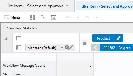

The New Item Statistics view contains the following measures:
Workflow Message Count
This measure displays the count of the Workflow Message measure in the Select and Approve view. The workflow messages are guiding you in the New Item setup process. If the count is zero, you have set up correctly all New Items. The count corresponds to the number of New Item/store combinations that you still have to finish setting up.
Store Count
This measure displays the number of stores that a New Items has been set up for.

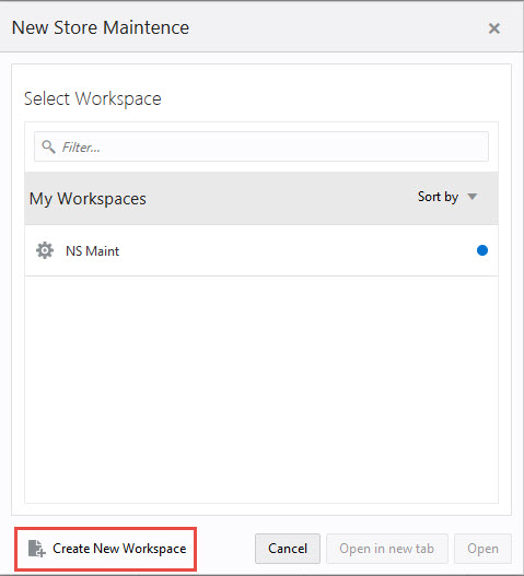

To build the New Store Maintenance workspace, perform these steps:
Click the New Item/Location activity and then click New Item/Location again to access the available workspaces.
Click New Store Maintenance. The New Store Maintenance wizard opens.
You can open an existing workspace, but to create a new workspace, click Create New Workspace.
Enter a name for your new workspace in the label text box and click OK.
Select the locations you want to work with and click Finish.
The wizard notifies you that your workspace is being prepared. Successful workspaces are available from the Dashboard.

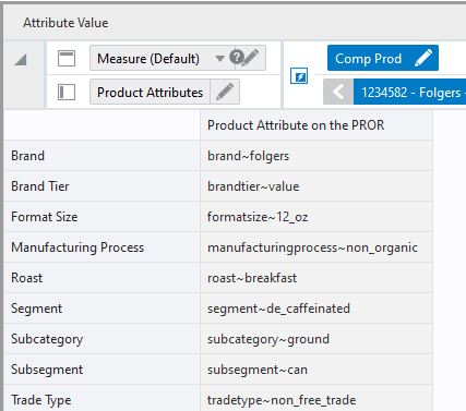

System Recommended Like Item based the similarity between new and existing items
Ability to display a User Selected Like Item picklist that is sorted by the similarity between new and existing items
Ability to control how many items are included in the User Selected Like Item picklist
Ability to edit attribute weights and immediately see the updated Like Item recommendations

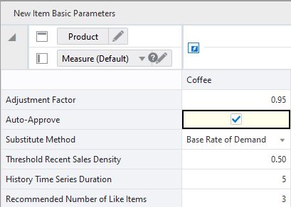

The New Item Basic Parameters view is used to set default values for some parameters related to the New Item functionality.
Adjustment Factor
Auto-approve
Substitute Method
| Base Rate of Demand | RDFCS calculates a base rate of demand based on items in the same class (dimension is configurable). The forecast for the New Item is given by:
Forecast at time t = base rate of demand * seasonality at time t (coming from escalation level) * promo and price effects (coming from pooling level) |
0,1,0,1,0,today
If the value for the threshold is zero, an item that is not actively selling can also be eligible as Like Item if it has an approved base demand.
This can be useful when the item to be introduced is a replacement or similar to an item that sold last season. In this case the base demand of the New Item will be modeled after the approved base demand of the item that it replaced.
Recommended Number of Like Items
In this measure you specify how many item you want to see in the User Selected Like Item picklist, in the Select and Approve view. If you change the value, by clicking the Calculate custom menu, the picklist is regenerated to reflect the new setting. The items in the picklist are sorted by similarities, which are calculated using item attributes and their weights.

In this view you can view item attributes as well as their weights. The weights can be edited, and they are managed at an intersection higher than SKU. For instance, for the coffee class the Roast attribute has a weight of 0.4. Once you change the value of any attribute weight, the similarity matrix is recalculated. This also triggers the regeneration of the user Like Item picklist. The items in the picklist are sorted by similarities, which are calculated using item attributes and their weights.
This measure displays the count of the Workflow Message measure in the Like Item – Select and Approve view. The workflow messages are guiding you in the New Item setup process. If the count is zero, you have set up correctly all New Items. The count corresponds to the number of New Item/store combinations that you still have to finish setting up.
Store Count
