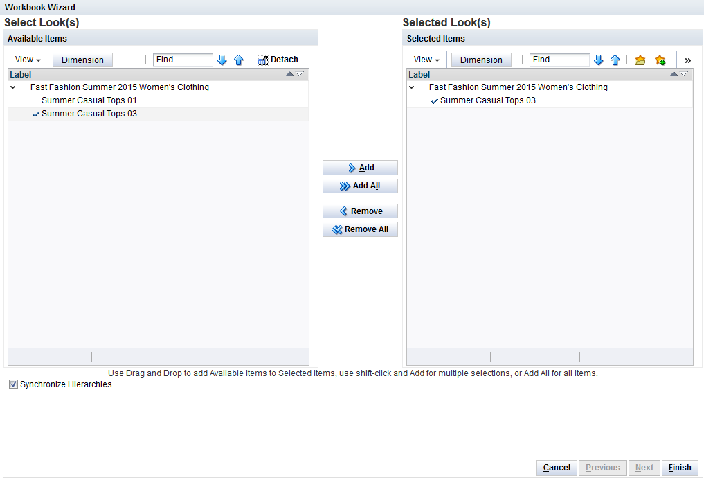

Create the Buying Plan Workbook
To create the Buying Plan workbook:
  1. Select the New Workbook icon in the Buying Plan task.
    Figure 7-1 Buying Plan Task
    Surrounding text describes Figure 7-1 .
    The workbook wizard opens.
  2. In the Select Looks page, select the looks to be loaded into the workbook. Click Finish.
    Figure 7-2 Workbook Wizard Select Look(s) Page
    Surrounding text describes Figure 7-2 .
    The workbook is created.

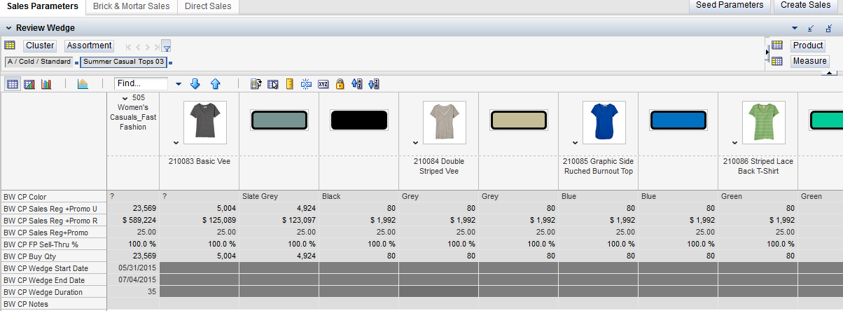

Review Wedge View
This view shows the Buyer, by style-color (and higher) and cluster (and higher), the sales start and end dates, the planned total sales, returns, cost, price, markup, buy quantity, and notes that were created in the Wedge process. These measures may have been seeded from the Senior Buyer's Shopping List in the Wedge process.
The start and end dates here will override the Look start and end dates for a given cluster, and so on.
Figure 7-4 Review Wedge View
Surrounding text describes Figure 7-4 .

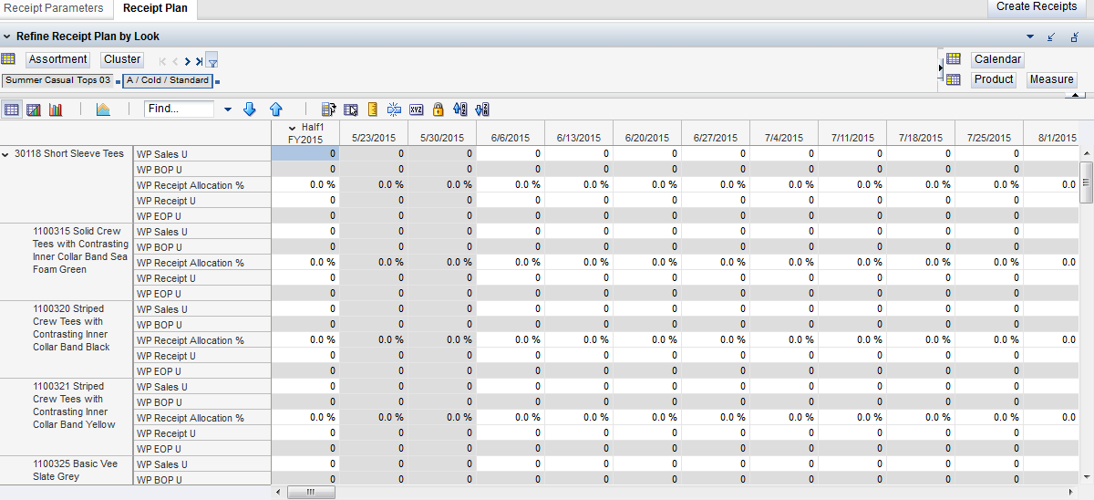

Receipt Plan Tab
On this tab, review and refine the seeded sales plan.
Refine Receipt Plan by Look View
In this view, review and edit the seeded receipt plan at the style-color (or higher), cluster (or higher) and look (or higher) level.
Figure 7-12 Refine Receipt Plan by Look View
Surrounding text describes Figure 7-12 .

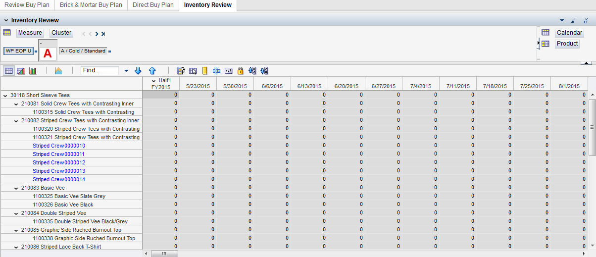

Inventory Review Tab
This tab shows an in-depth, time-phased view of the Receipts and Inventory component of the Buy Plan, regardless of whether you use the Brick & Mortar or Direct or both sales methods for planning.
The Buyer can compare their current Working Plan to Last Year (likely at an aggregate of the Product hierarchy) and to the last Current Plan version of the plan.
Inventory Review View
This is the only view on this tab.
Figure 7-18 Inventory Review View
Surrounding text describes Figure 7-18 .
