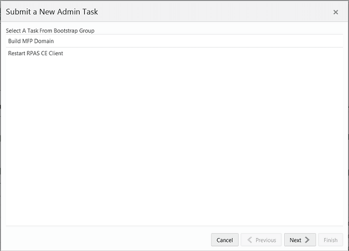

  3. Select the Build MFP Domain task and click Next.
    Figure 2-2 Select Build MFP Cloud Service Domain Task

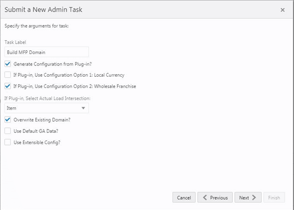

  4. Set the arguments for the task:
    Figure 2-3 Select Build MFP Cloud Service Domain Task Arguments
    Surrounding text describes Figure 2-3 .
    1. Enter the Task Label.
    2. To generate a configuration from the plug-in, check the Generate Configuration from the Plug-in checkbox and then select the plug-in option to use. In the above figure, the Configuration Option Wholesale Franchise is selected and Actual Load Intersection is selected as Item.
      For information on plug-in choices and details, see the Oracle Retail Merchandise Financial Planning Cloud Service Implementation Guide.
    3. If the domain was already created and needs to be overwritten, select Overwrite Existing Domain.
    4. If Use Default GA Data is not selected, the input hierarchy and data files should have already been uploaded.
    5. If Use Extensible Config? is selected, the customer should upload the extensible configuration, created from the GA configuration as
      <app_name>_config.tar.gz to the FTP config directory. The customer can also upload the corresponding input files as <app_name>_input.tar.gz to the FTP input directory and upload the custom batch control files as
      batch_control_cust.tar.gz to the FTP batch_control directory. The process will first validate if the uploaded extensible custom configuration is valid; only if it is valid, will the domain be built. If the customer uses the Extensible Config option, there is no need to choose any plug-in option as it will use the plug-in options used by uploaded extensible configuration.
    6. After choosing all the necessary options, click Next.

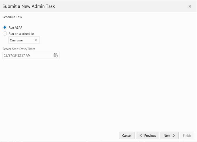

  5. Select the time to schedule the task and click Next. Click Run ASAP if the Administrator wants to run the task now or the task can be scheduled by selecting the Run on a Schedule option.
    Figure 2-4 Schedule Task

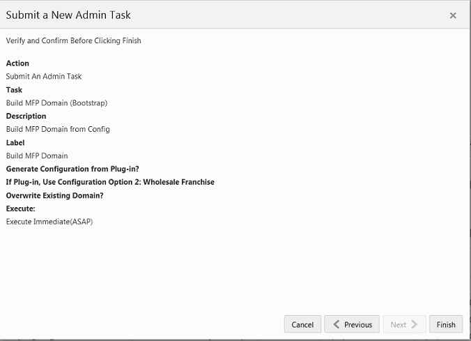

  6. Review the selections and click Finish.
    Figure 2-5 Verify and Confirm Selections

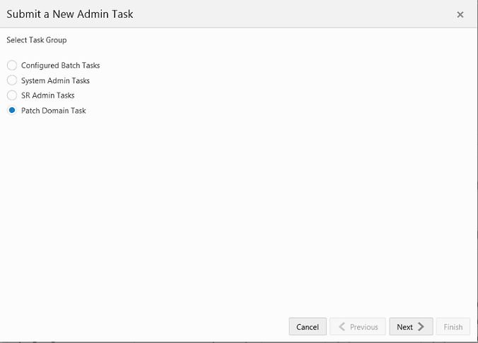

  3. Select Patch Domain Task and then click Next.
    Figure 2-7 Select Patch Domain Task

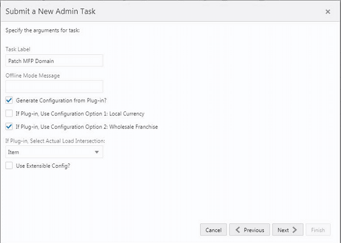

    Figure 2-8 Select Patch MFP Cloud Service Domain Task Arguments
    Surrounding text describes Figure 2-8 .
    1. Enter the Task Label and Offline Mode Message.
    2. To generate a configuration from a Plug-in, check the Generate Configuration from Plug-in checkbox and then select the plug-in option to use. In the above figure, the Configuration Option Wholesale Franchise is selected and Actual Load Intersection is selected as Item.
    3. If Use Extensible Config? is selected, the customer should upload the extensible configuration, created from the GA configuration as
    4. After choosing all the necessary options, click Next.
