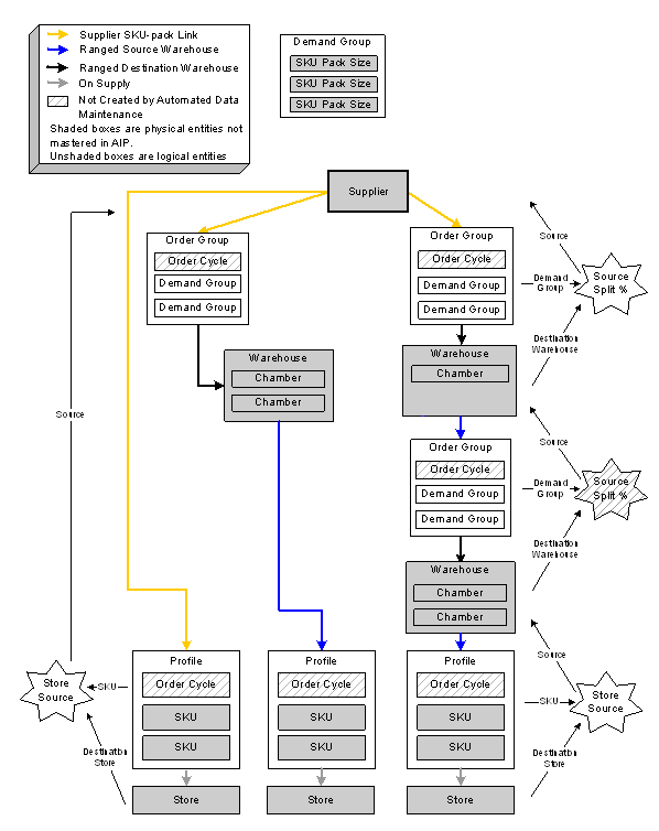

Figure 18-1 lists the physical as well as logical entities of the supply chain that must be defined within AIP. If configured correctly, all logical entities can be created by the Automated Data Maintenance processes, with the exception of those noted in the diagram and the Supplier SKU pack size links.
The diagram provides an easy-to-discern list of needed supply chain elements. For example, by examining Figure 18-1 from top to bottom it can be seen that:
A source must be connected to an Order Group for delivery into warehouses and a Profile for delivery into the store.
The Order Group must be associated with an Order Cycle.
Demand Groups must be associated with an Order Group for deliveries from a source to a warehouse-chamber destination.
Demand Groups must be created for SKU-pack sizes.
Figure 18-1 illustrates what the First Day of AIP needs to accomplish on the Oracle platform. By fully comprehending each element of Figure 18-1, it becomes clear why the first day process should be different for AIP on Oracle and how to maximize the effect of automation while minimizing the amount of extra effort required to enable it.
The full analysis of each element of Figure 18-1 is out of the scope of this document; however, the elements that impact the first day will be examined.
Order Cycles are required to create Order Groups and Profiles. Order Cycles are not created by Automated Data Maintenance; however, default Order Cycles are provided as seed data loaded before the Fist Day.
Warehouse chambers are required to create Order Groups and ranged warehouse/SKU-pack sizes. Chambers are not created by Automated Data Maintenance since there is not a single rule-set that will work for all businesses. It is maintained as a manual process. Automated Data Maintenance could do very little setup the first day if the First Day process was not altered to accommodate for this fact.
